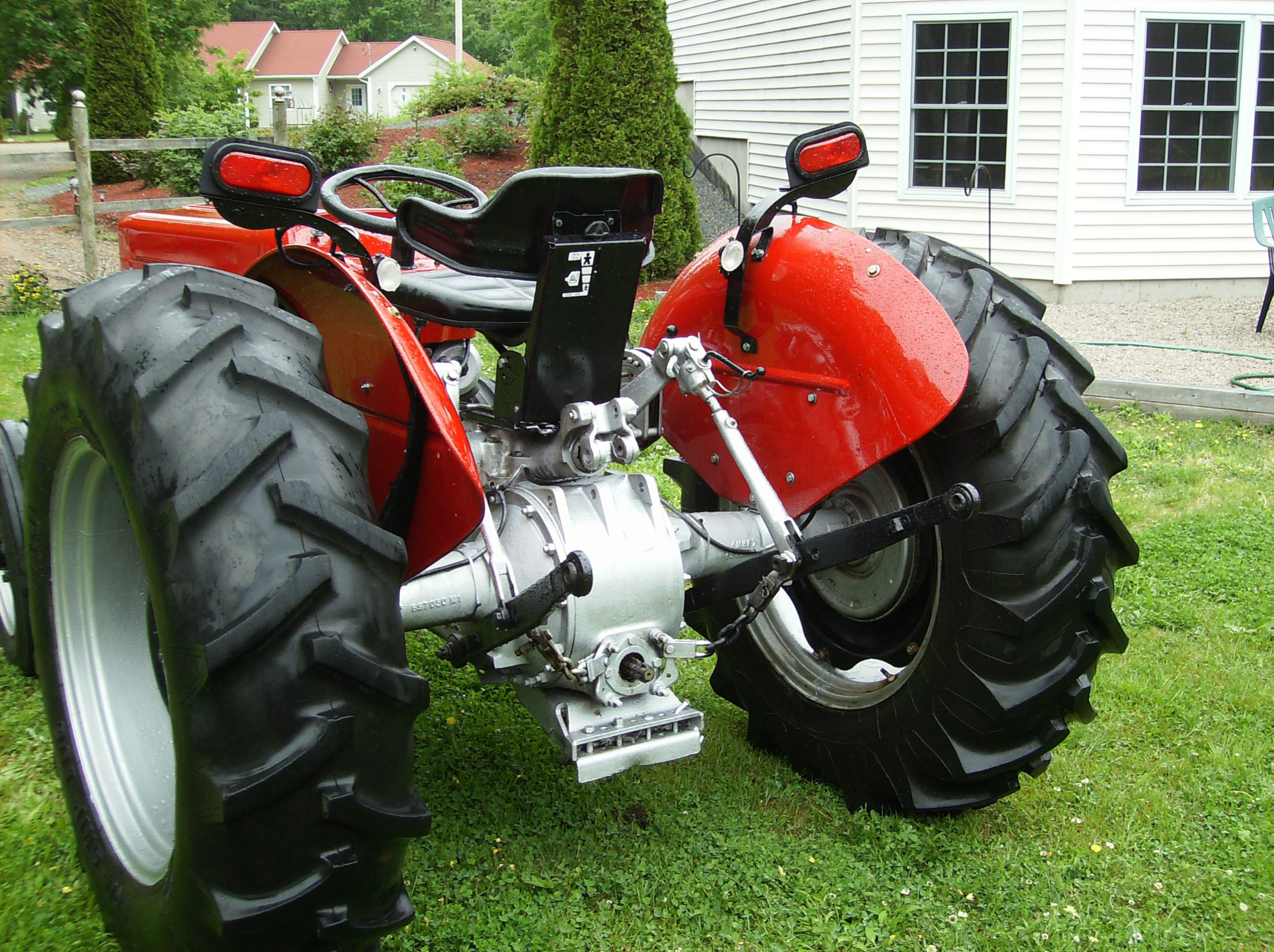

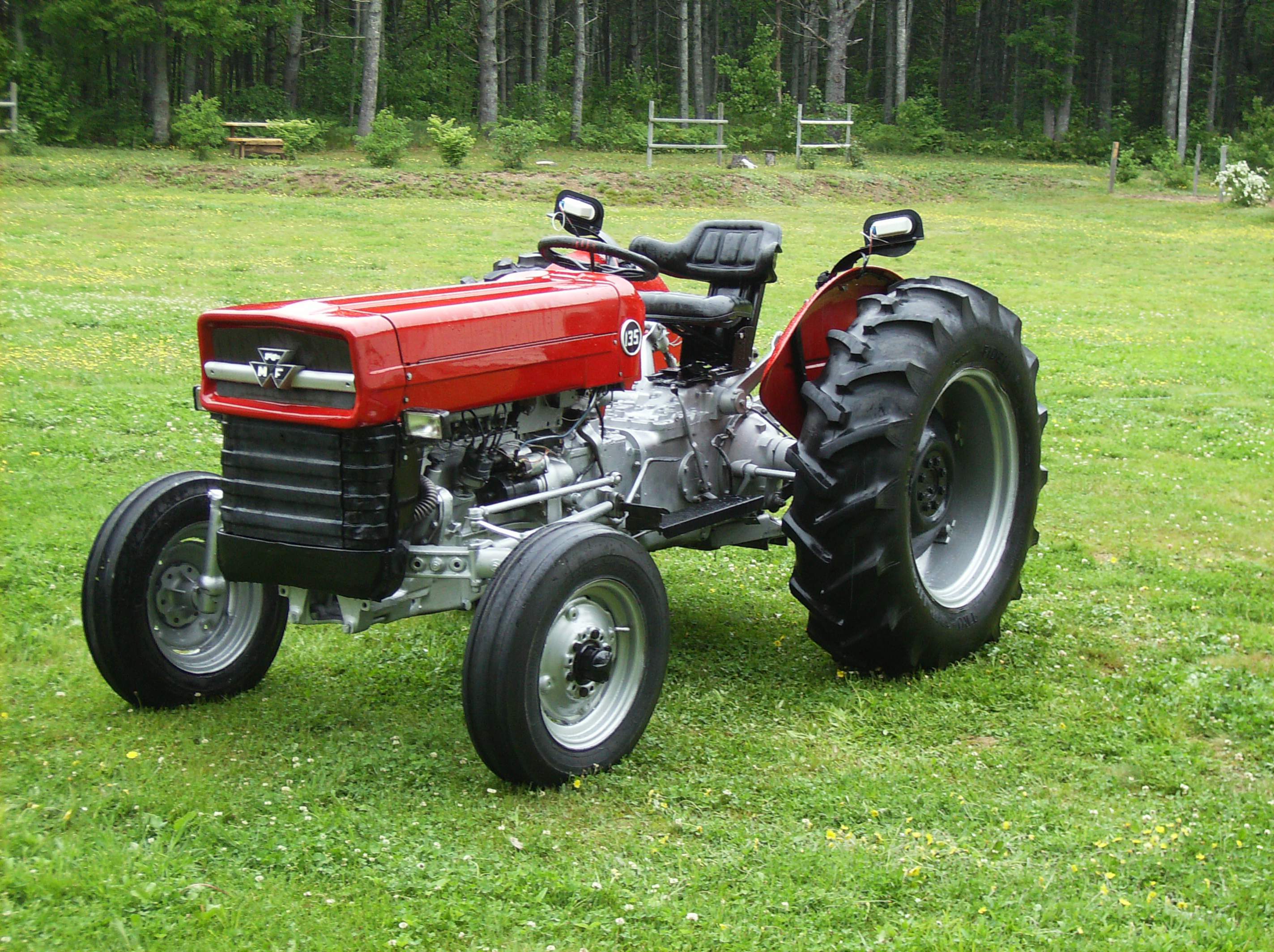

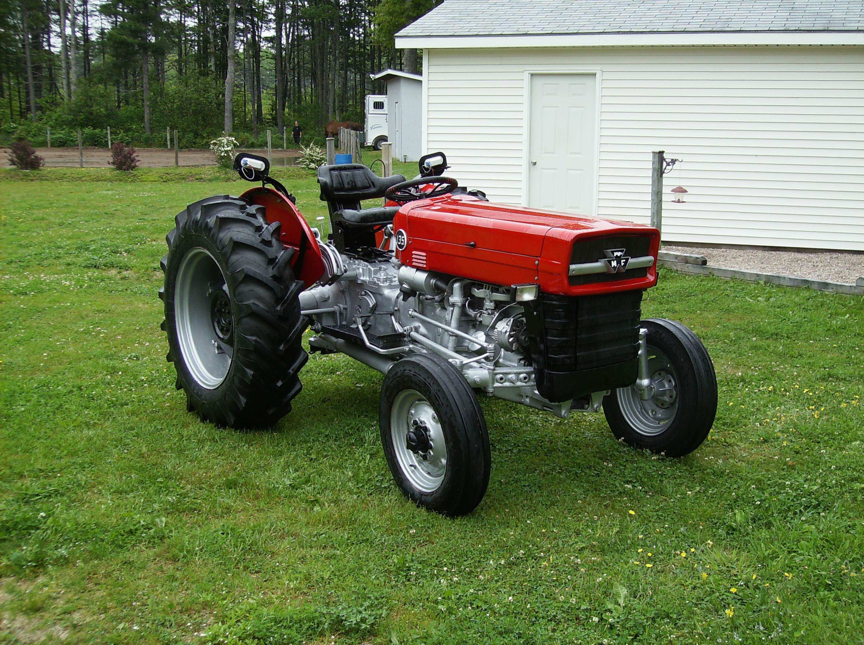

Great way to really get to know your tractor, there are some on here now who are going through varying degrees of reparations / restorations with their 135s. I did the same with mine a few years ago now, I've had mine, or I should say we've had ours, for a dozen or so years now.
Work I did on mine included;
Re-cored the rad and patch repaired the upper rad tank
Replace water pump and fan
Rebuild the alternator
Rebuild the carb (twice, some schraeber carb kits come with rubber tipped jets)
Rigged the 3 point lift mechanisms
Changed the shift lever boots, hyd filter, hyd pump lift rod o-rings
Replaced 90% of the wiring
Compression check was good, #1 cylinder is a bit low
Modifications included
Replaced the original headlights with brighter lights
Replaced the rear worklight with two LED fog lamps
Installed two LED trailer signal/brake lights on the rear with flasher
Replaced stock seat with a suspension style seat.
Had a lot of fun doing it all and got to know my tractor in the process. When it came time to paint it, I had just finished spraying my 2004 Ram, Poppy red. I had some left over and decided it was pretty close to the original MF red. Came out nice, and the clear coat finish has stood up well to everything from chains to chainsaws placed on the hood, will definitely be using it again when I do a tear down in a few years. Wish I was on TBN when I did the first bit of work, will be documenting it here when I tear it down, great to see people still appreciate the value in old iron.
Looks great Mike. The black center rims and the blacked out grill with the new seat gives it a custom look. A very good job getting that sheet metal fitment too. That is a bear. - robert

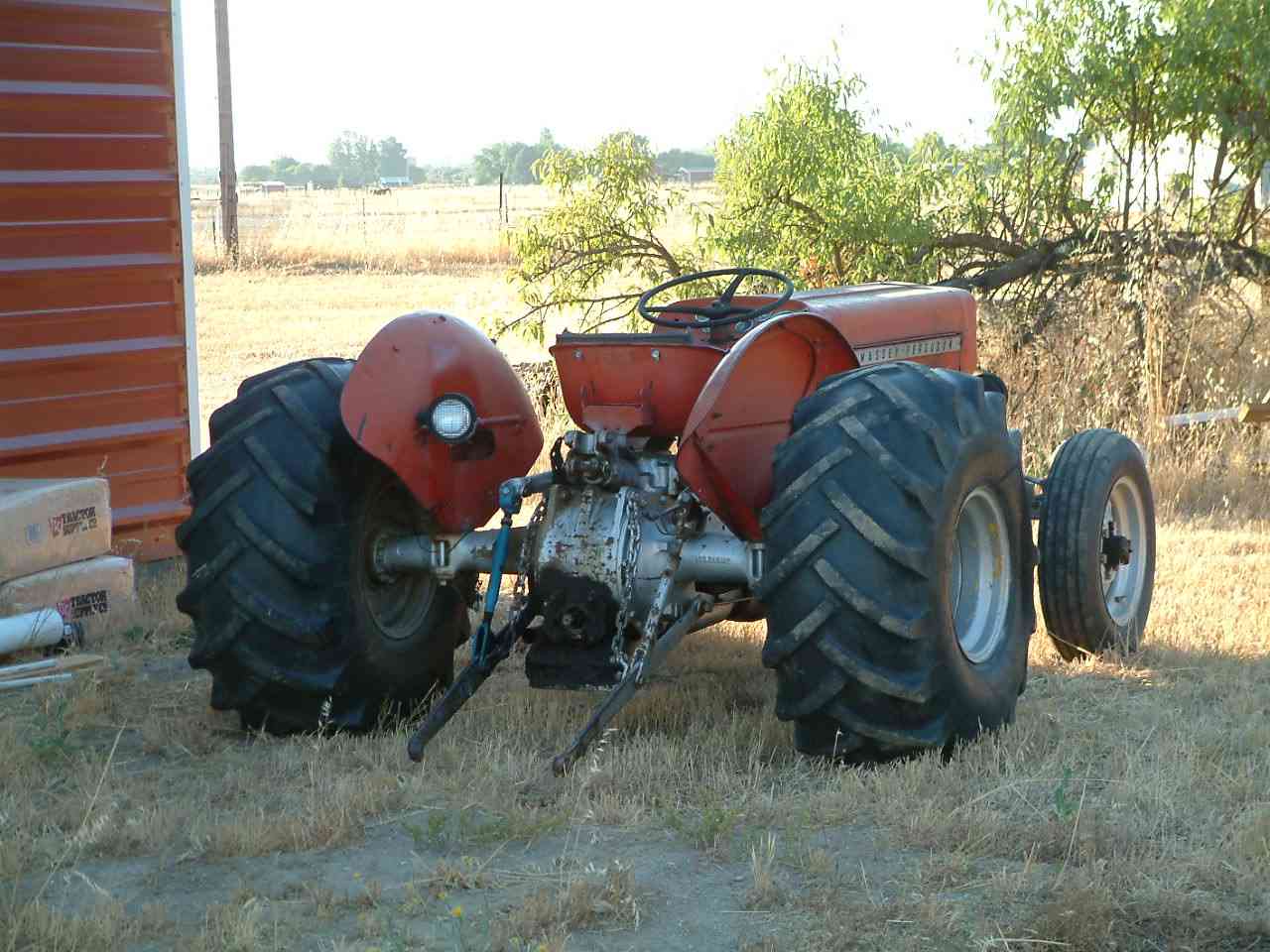

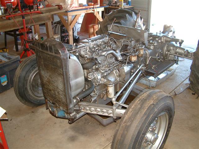

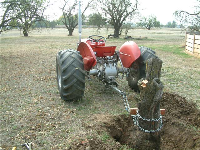

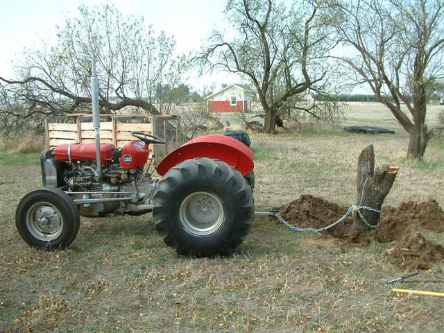

Mine is a 1964 MF135 diesel deluxe with multipower. Got it in Jul06 for $3600. Did a partial restoration. It's in my shop now with an engine oil leak, a leaking pto shaft seal. I might have to dig into the 2-stage clutch since it's getting difficult to shift the pto on and off.
Have fun with your new toy:D
