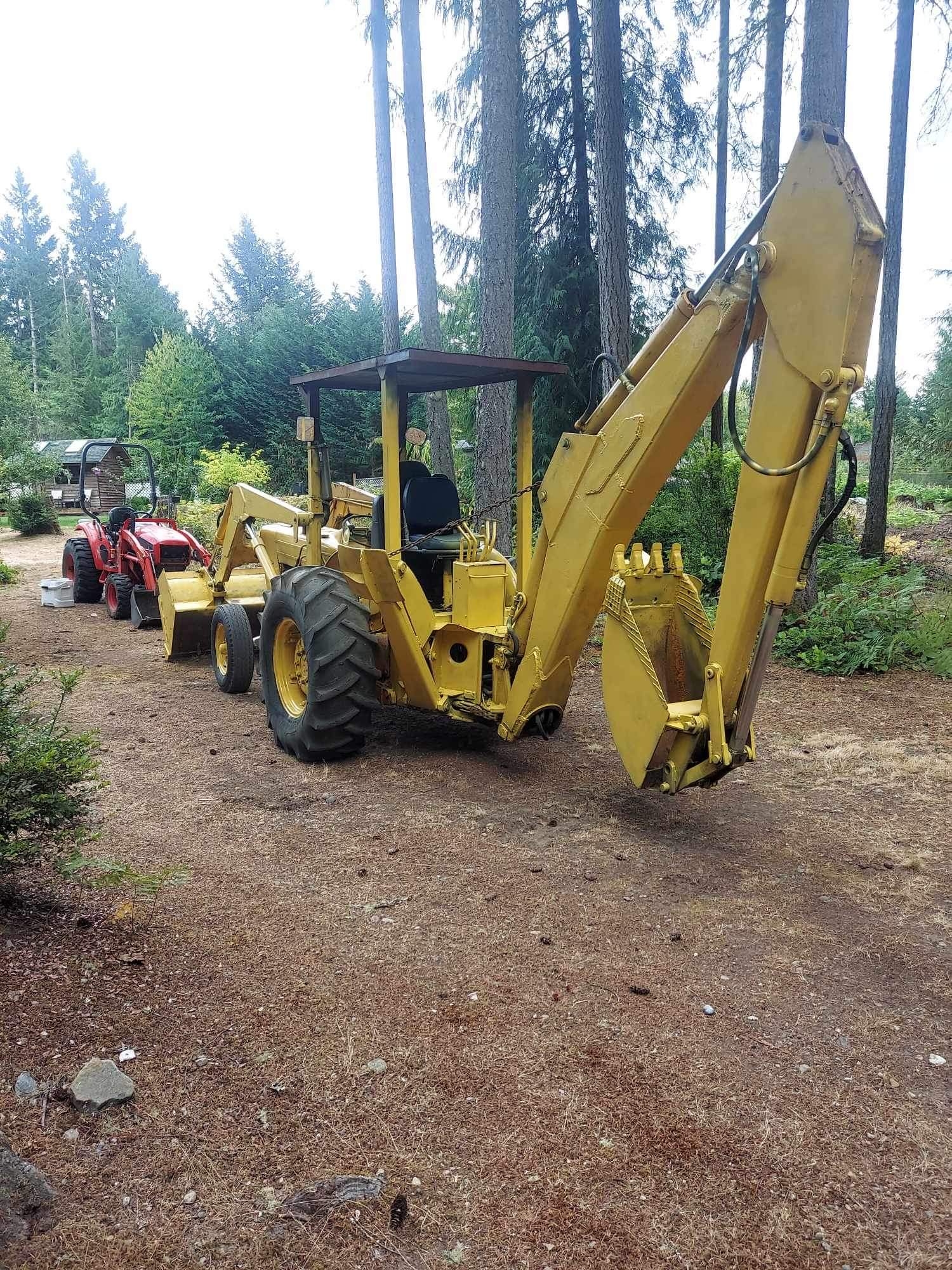

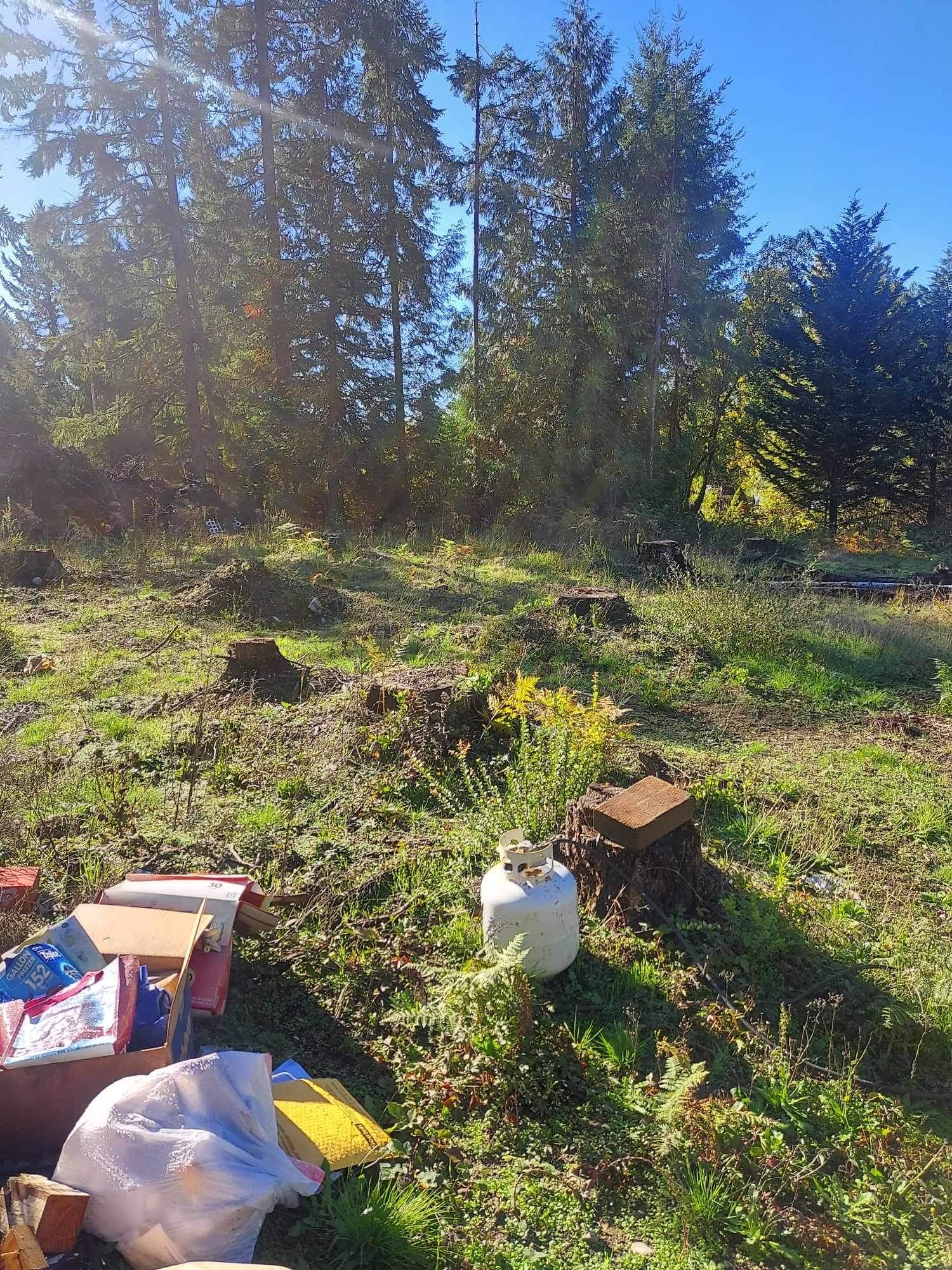

Would it be wise to attack these IMG_1498.jpegIMG_1485.jpegstumps with my backhoe?

I would. Digging stumps isn’t that bad with a full size backhoe.

Thanks I practiced on a small one about 8 inches across new to a backhoe. Need to practice label controls. I’ll get it going to be fun.

I only have a small Kubota B77 backhoe on my tractor. Digging stumps is an art that takes some skill. The larger the backhoe, the more forgiving it is for lack of skill and technique.

In 1970 that would have been a good way to do it
Take your time and don't bite off more than you can chew

I started and like running the four stick backhoes. Dig out far enough to lever-arm the big roots off the stump close to the root ball. Narrow bucket or ripper helps save time and ground disturbance.

I dig a hole next to the stump and pull the stump in and bury it. Unless you are looking for a finished yard this works. Otherwise you end up with a pile of stumps you need to get rid of. I've not had any luck with burning a pile of stumps or waiting for them to rot down.
