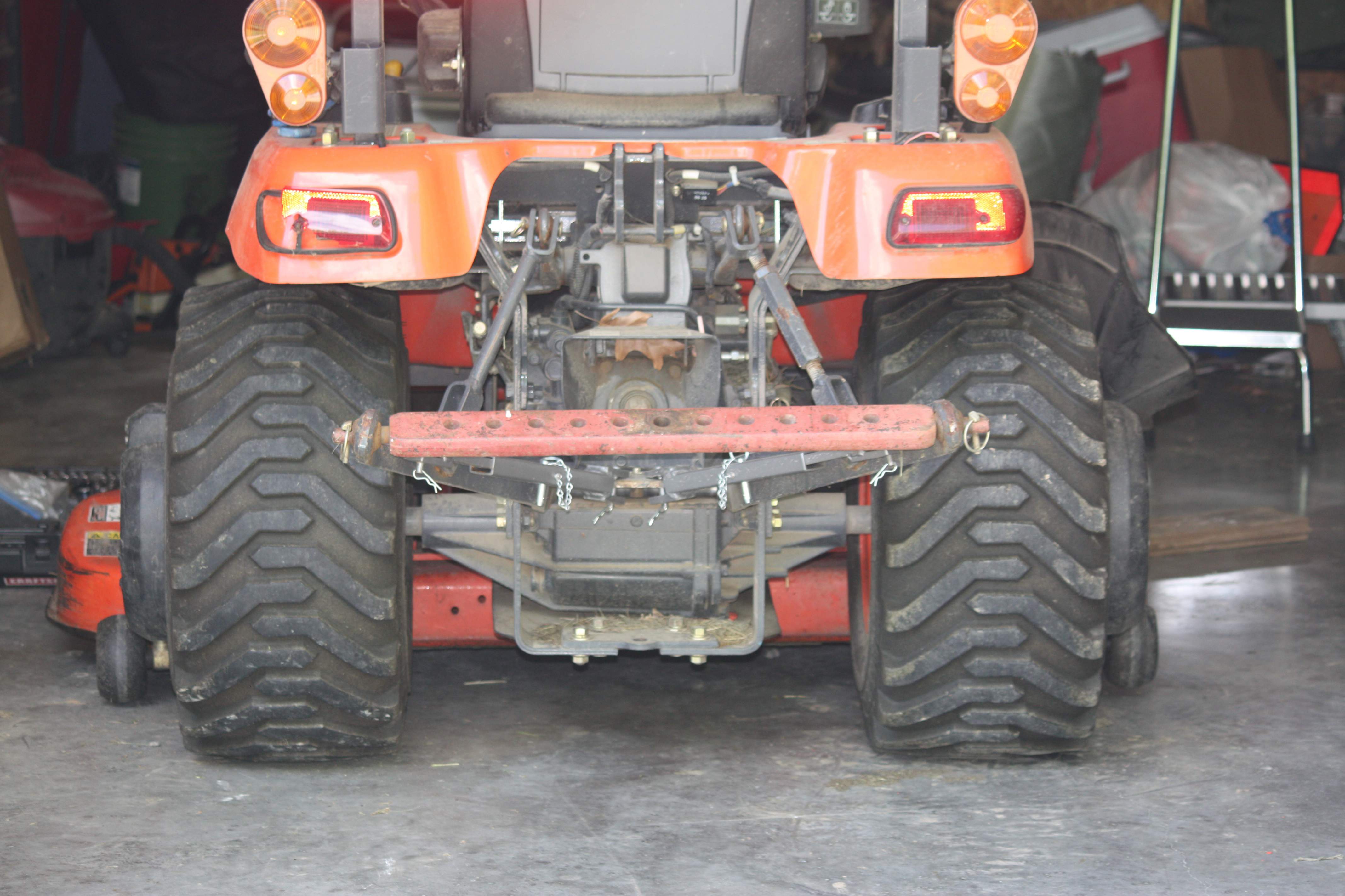

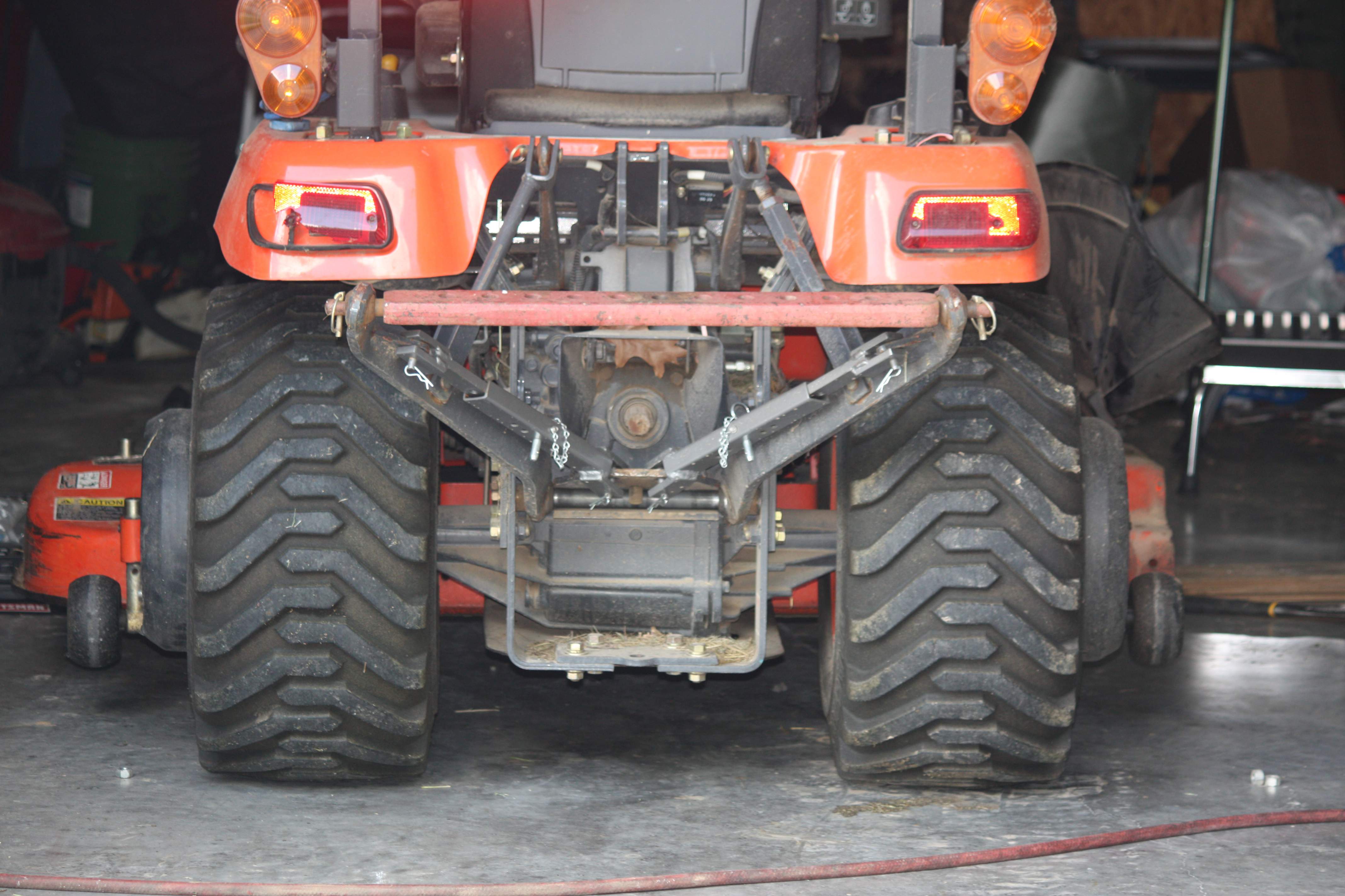

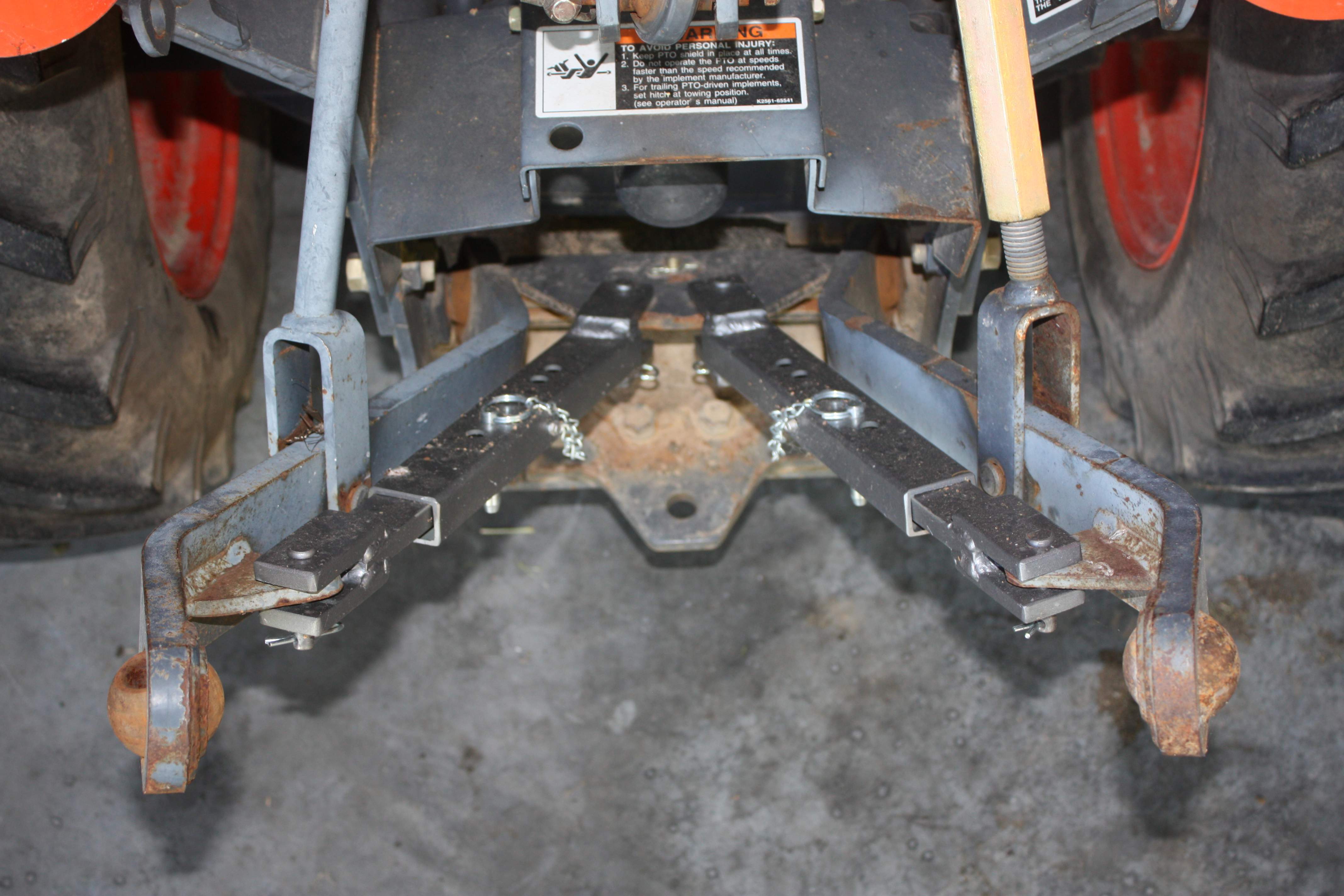

I can only agree with the others, we have a BX2200, BX2660 and JD 1025R. Some things you just can't explain; 1025R has more features like a position control 3PH and implements like MMM and FEL are a bit easier to swap out. No vulnerable plastic HST fan. That being said, my wife and I prefer a BX. I put Bro Tek fan protectors and wheel spacers, weight in the rear tires and replaced the turnbuckle chains with those like the bigger tractors use. Mark Hodge makes these. If I didn't have bigger tractors on hand, I would have picked a B or 2 size.
I have 48 inch rotary cutter, blade, box scraper anf 60" MMM.
