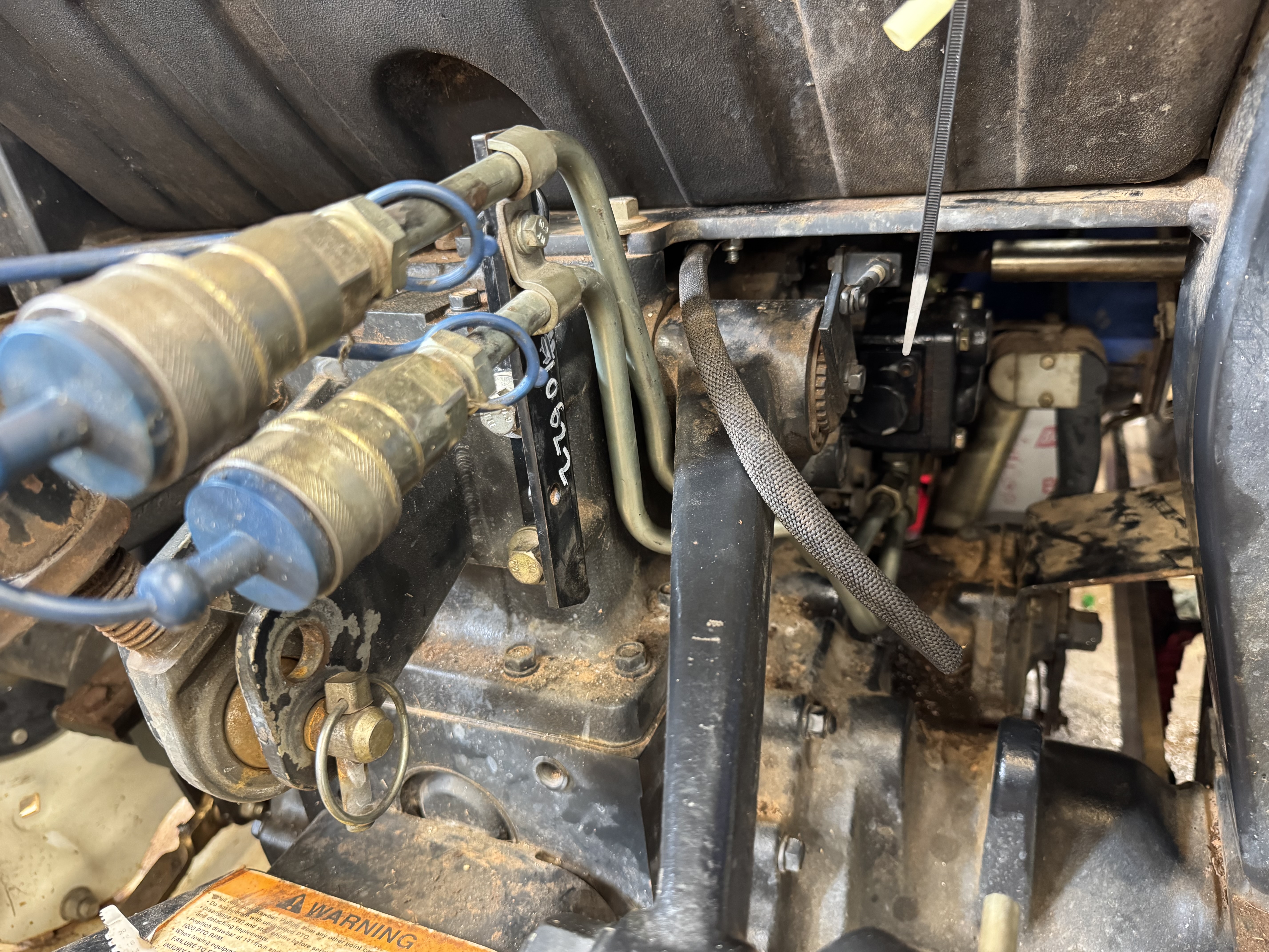

Rear remote arrived wednesday a day ahead of time. Started at 930pm and finished torqing the rear wheel on at 11:30pm. What excellent directions. sone questions i have.
Jinman and others when i installed the kit the only place required or suggested for thread sealer was at the couplers at the back of the tractor, and they were already screwed on. I was so tempted to put it on the rest of the threads, but i sustained? Anyone else? I just hope i dont have to take the tire off again to put thread sealer on to fix a leak.
Question 2. When i work at the farm all our tractor hydrualics when whe push the lever or remote to the front of the tractor the implement in the rear goes into the ground. Likewise when we pull back on the remote the implement goes up. When we would hook up unmarked hydraulics and the remotes would be opposite of that we would just simply reverse the hoses. Does anyone see anything wrong with this on my boomer? I didnt put the decals on it yet cause they would show the reverse. THe 3pt you push forward and the imp. goes to the ground, so why not keep the rear remotes the same? THe pump should have the pressures the same whichever direction you push the remotes correct? Or is this something that would affect a hydraulic driven motor like a post hole digger?

Outstanding! Two hours of enjoyment doing something like that is two hours well spent. I would not worry about leaks unless they become a problem. If you got the flare fittings tight, they should be fine. If your quick connects leak, first tighten them if you can before doing anything else.
The beauty of remotes is you set them like you like them. I like to have my grapple close when I move the lever forward and open when I pull it back. By placing the hoses as you wish, you make everything work the way you want it to. What feels good to you is the only thing that matters. If somebody else wants it the other way, it's a snap to change.
Congratulations! You'll love having remotes and will surely want more. They are as addictive as any drug.;)
