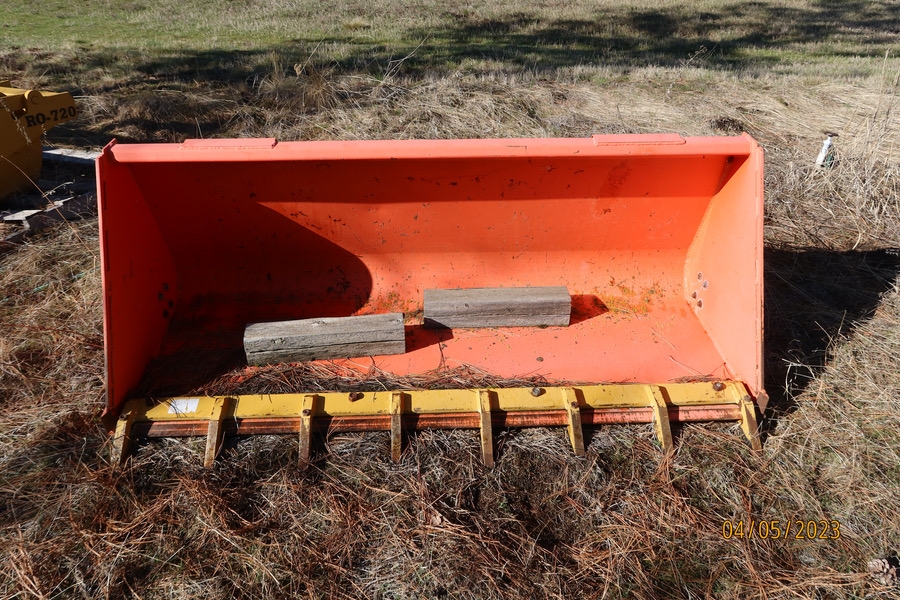

I have a Rankin tooth bar. MADE IN WA STATE!! It hooks under the bucket lip. I made it a permanent installation - more or less. Rather than the bolts being pressure clamp arrangements - I drilled completely thru the bucket and bolted the bar directly to the bucket.
The teeth are the long style and DO DEFINITELY help the bucket when picking up "stuff".

That was the other tooth bar I was looking at oosik. Only thing was back blading a smooth surface with that style would always leave lines. Rankin makes good stuff. I have there 5 foot arena harrow and it works wonders in the tree fields.
