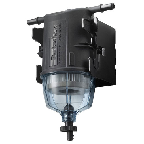

If you have no provision for draining the bottom of the tank, then you do it like we separate water out of boat fuel tanks: Pump all the fuel and water out into something you can remove the water from.
My most lent out tool is a homemade, cheap Mitsubishi 12v fuel pump that goes to a household wall switch with two 12v battery leads mounted on a block of wood and has 10' of hose on either end for fishing into tanks and dumping into other tanks.
After that, remove the fuel filter and either toss it and replace it or dump it and let it drain out. If you have the space, install an inline water/fuel separator before the fuel filter or replace the existing fuel filter with a water/fuel filter housing—which is pretty cheap considering you don't need one that has a heating element in it as well.
You can get away with a small water/fuel separator on your sized tractor if you see a spot to install one. Typical:
   / Water in tank/fuel filter of Kioti CK35. #4
The Chinese fuel polishing filter (amazon) is about 15 bucks less and is a carbon copy of the Racor and all the threads and dimensions 100% match the Racor filters. What I run, the Chinese filter housing and a genuine Racor water bloc element. The Chinese clear bowl also threads right on as well. Heave 3 of them, 2 on the tractors and one on the diesel farm truck.
If you go the Amazon route, disregard the negative comments. I guess people who buy from there cannot read. Plainly states for diesel only but all the whiners leaving reviews had them filtering gasoline. That don't work. Not compatible at all.
