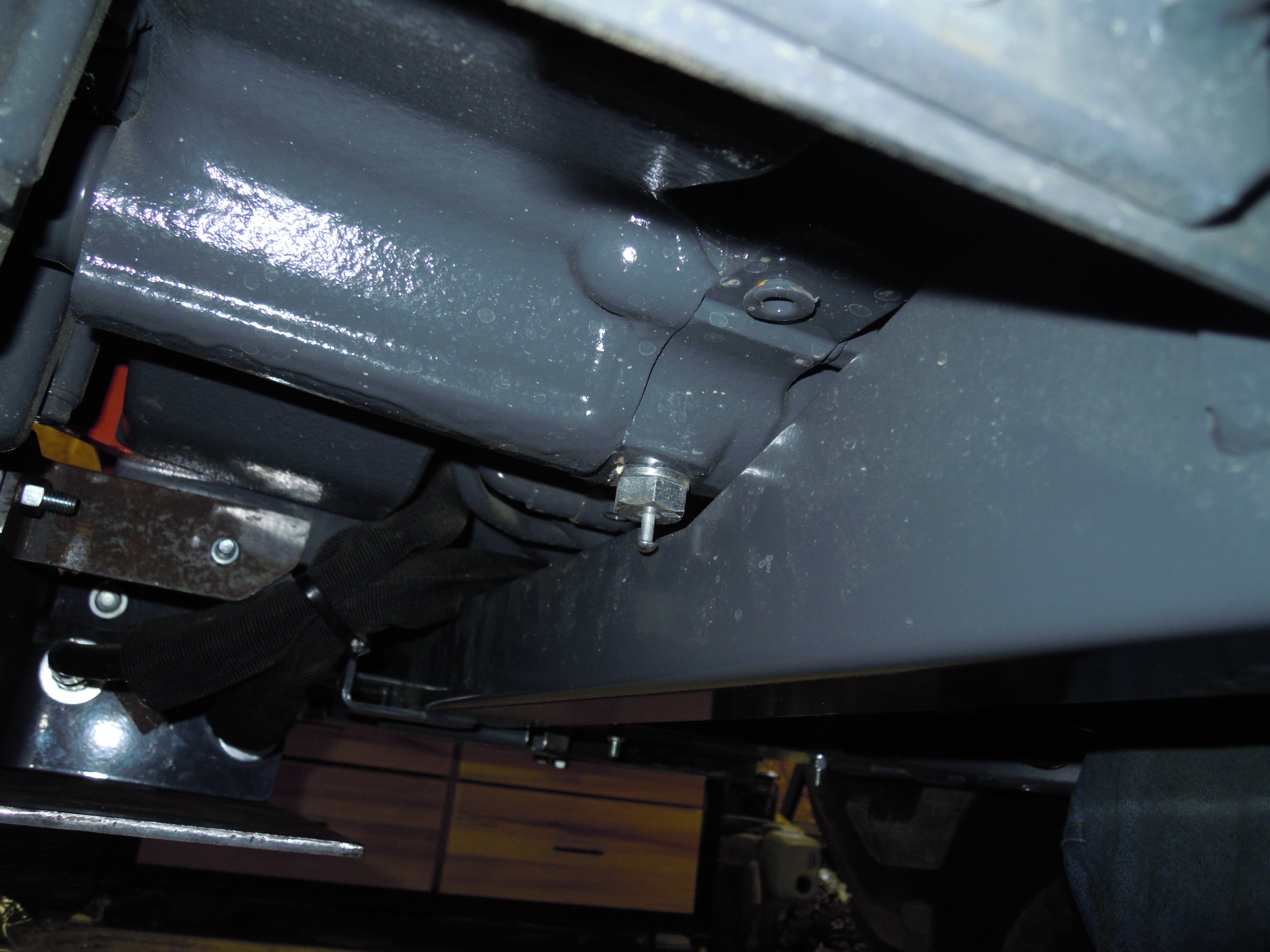

I'm in the process of making a guard for the 3rd function hydraulic hoses and noticed this weird little plunger coming out of what appears to be a bolt in the bottom of the transmission. Can anyone tell me what is? I sure don't like having something like this fragile thing hanging from the underside of the tractor. I can see this getting easily damaged.

I believe that drains water.
   / What is this on my new L6060 #3
Oil came out of mine, but yes that is a water drain

Its a weep bolt for your bell housing area. They say it for water but it actually drains oil that leaks past your propeller shaft, and main seals on tranny and motor.

A water drain? for what?
The little plunger moves up and down freely and nothing comes out of it now but the tractor only has 14 hrs on it. That little plunger is sure to get bent if a stick or anything else hits it. Seems like a really dumb thing to have under a tractor. Hope it doesn't matter if it gets bent.
I posted before your post was up. Thanks for the info and that makes sense. I guess if the little plunger gets bent in the open position it won't matter. I could replace it too, if I notice it is damaged. I'm sure it wouldn't be too expensive (ya right).

Weep hole and vent to atmospheric pressure.

If oil leaks out that pin, get it to your dealer ASAP; expensive repair.
