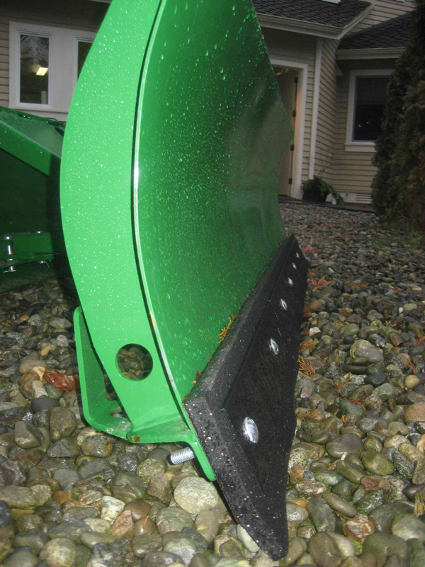

I think a rubber edge on any of your tools would work including the blower, although living somewhere as cold as Manitoba the best protection for the driveway is probably to leave a packed layer of snow/ice on it and scrape that.

I use a rubber edge but on my front blade. I am sure that you could do the same although on you back blade. I made my rubber edge out of a barn mat - very heavy rubber material about 1" thick. I left the steel cutting edge on, extended the rubber about 1.5" below the steel blade then added a 1/8 " plate on top to hold it tight.
I would guess that a polyurethane edge may be a bit too stiff and pull up some of your brick edges.

Holy crap!!! Thanks for the reponses!:thumbsup:
I really like the rubber cover edge on the back blade, I might even get the snowblower covered.:thumbsup:

Not so sure the rubber won't mark the stone.??
