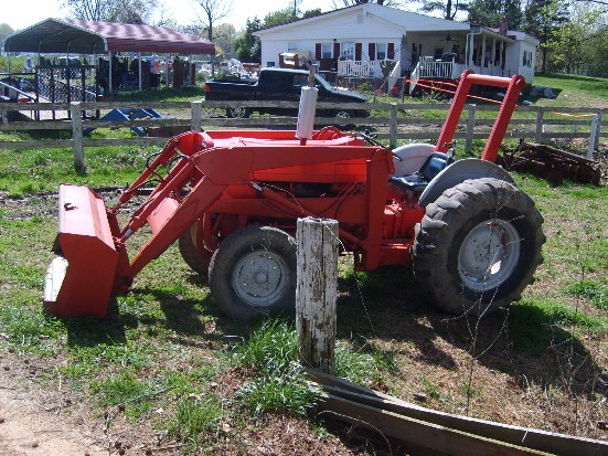

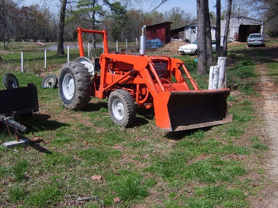

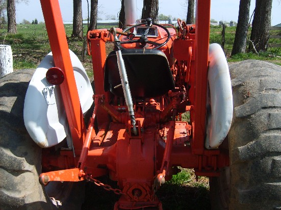

Purchased a Tired Industrial Tractor
Model Year: 0
I purchased a very used Ford 3000 that had been repainted and new rear tires installed. I didn't know much about tractors when I purchased it so I had a couple of lessons to learn about purchasing/maintaining a tractor! I could tell it was an industrial tractor because yellow paint could be seen in a few areas under the orange overcoat. The left side power steering cylinder had a welding bead at the rear end attachment point indicating that it had broken once before. The left side bucket cylinder is bent slightly causing a fluid leak however, it still operates fine. The only gauge that works is the oil pressure. As a result, the tractor overheated on me once or twice. I will fix this after I get the power steering issue resolved (the welded cylinder broke last time I used it which cost me two days to fix swapping out new and used parts). The tractor runs strong, PTO and 3 point hitch work great. I had to replace the hydraulic line nut where it exits the pump. Thanks to this forum I was able to fix the issue with minimal expense and trouble! Not sure if the $6500 I paid was a reasoable price but the tractor is doing everything I demand of it from a plowing perspective.
Pros: Plenty of power for my small farm, strong hydraulics, relatively easy to handle.
Cons: Abused when purchased. Due to the sheet metal being replaced it took me a while to determine the model.
