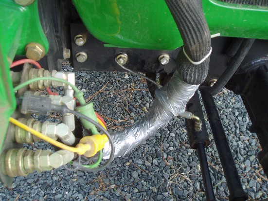

Model Year: 2001
Needed a tractor to help clear wooded area, grade road, cut weeds and many other tasks on 40 acres. Since purchase have has a recall for the plastic glass that covers gauges. My model already had the axle change when I purchased it. I have done all maintenance to t over the years. Had battery replaced by JD after it began to leak and did slight damage to the battery tray. Aware of problem so I caught it before it damages oil cooler and radiator.
Pros: Very reliable. 4 wd model/ easy to work on/ No major problems I could not repair
Cons: Battery leaked/ heat from tractor on pedal foot area/ replace dashboard glass/plastic but still fogs a bit/ Had to make metal clamp to keep hydraulic lines from right front wheel
