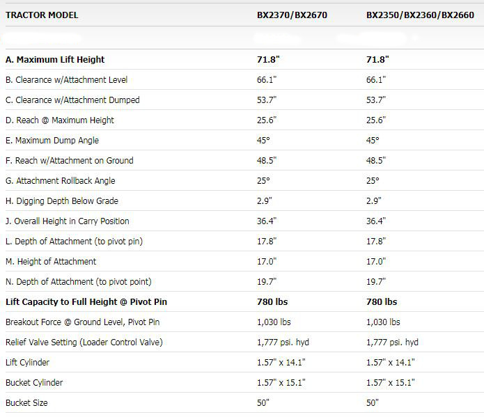

Here are the detailed specs. The loader's shipping weight, including the grille guard and pallet, is 538 pounds.
I hope the step by step illustration will be helpful to those who take advantage of this very nice and affordable loader. Besides Peanut assisting with connecting the hydraulic lines, no professionals we involved during the installation process. It was just us sales guys helping Rick out some in between phone calls!
