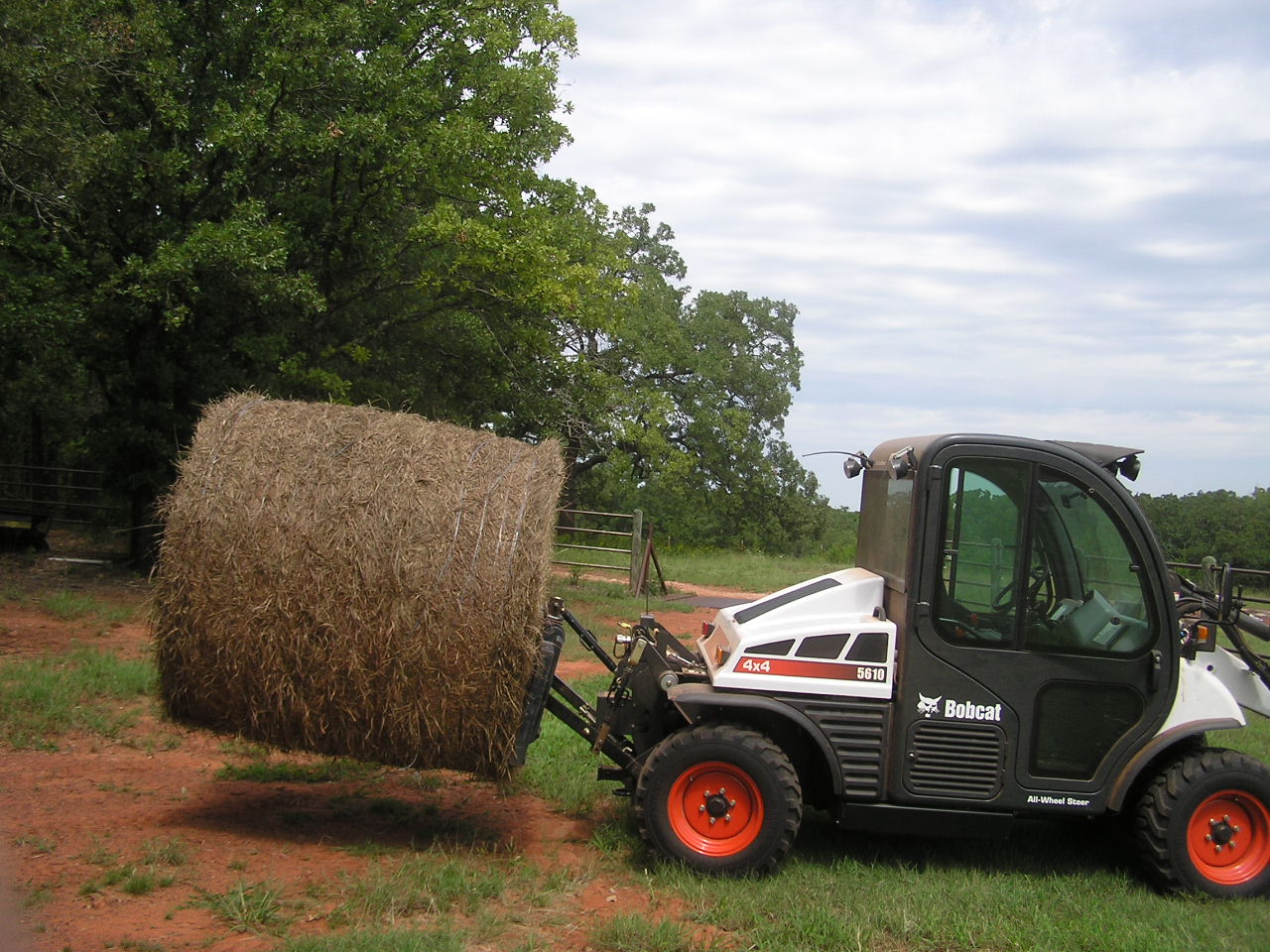

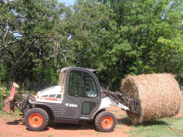

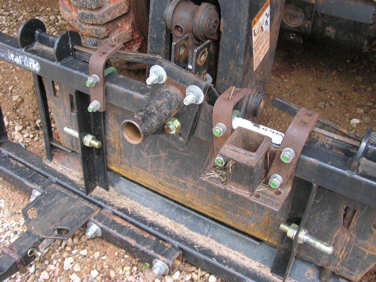

I added a bale spear to the Speeco Ultra Fork. The base is designed to bolt on and the spear is held in with a pin:
With a 5x6 bale, front SSQA or 3 point:

Axles do fine but hard use they will bend . My spear will not bend . That's why I built this one .
Your spear is a lot better design than just cutting the fork into a V. The OP only has a medium to large compact tractor. I think a big truck axle would take all the abuse it could offer.
