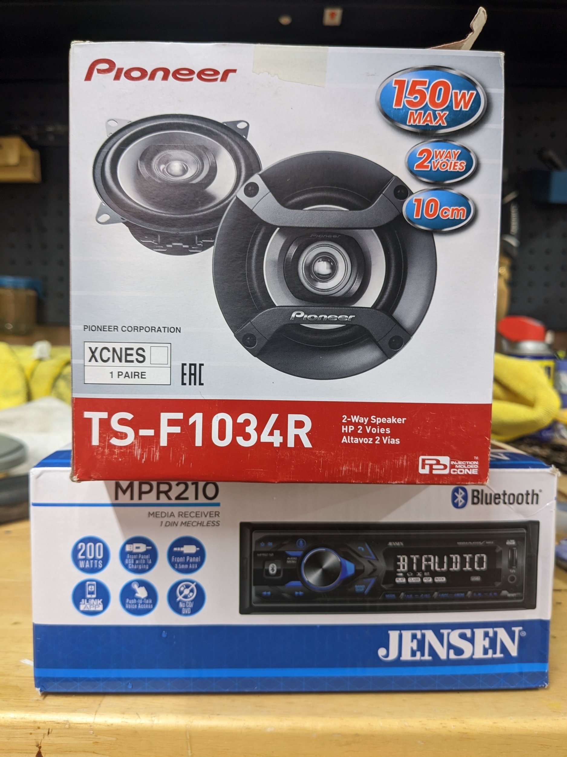

This is what I bought from Amazon :
Both units are straight 'drop-in' and do not require any cutting in the cab's liner.

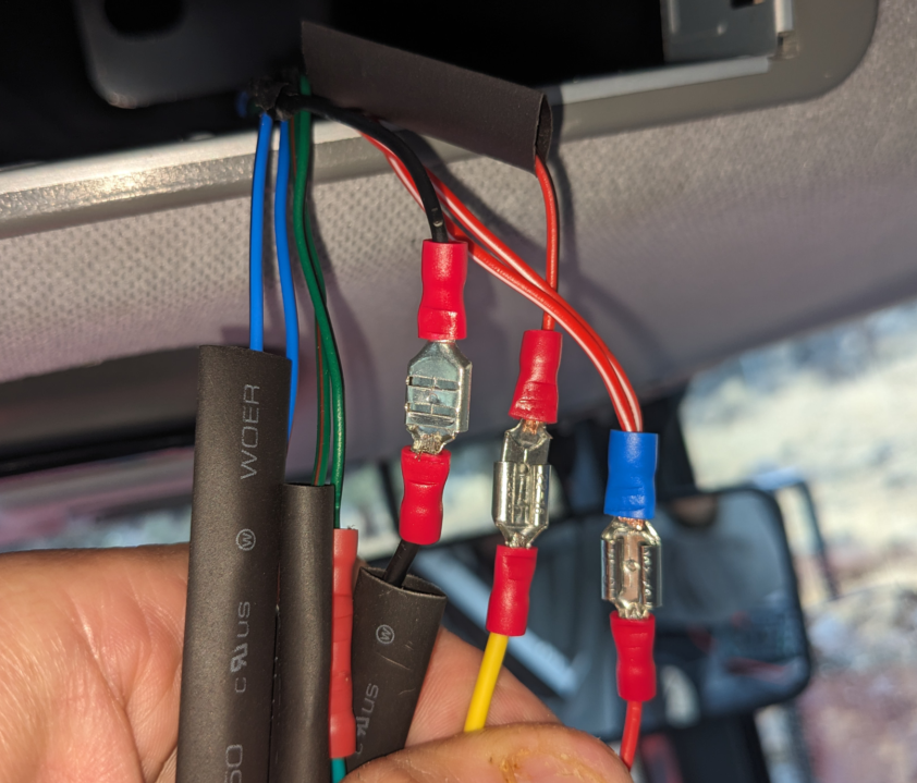

Wiring

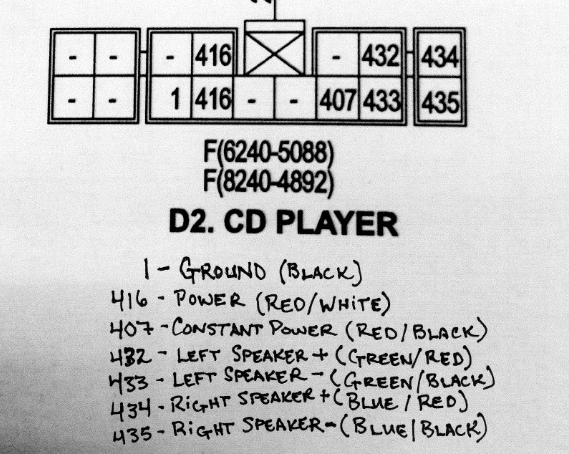

Somebody was kind enough to post this diagram :
The only tricky part is understanding how to connect to the aftermarket unit.
Most aftermarket units go by the same color coding, which in this case means :
  • Constant power : Kioti red/black connects to aftermarket yellow
  • Key-on power : I joined the 2 Kioti wires which are red/white and connected them to aftermarket red
  • Ground : black on black
Speakers wiring: most head units have 4 channels (2 front, 2 rear). I wired into 'rear' and put the Fader control into 'all rear'. Initially I thought I would install an extra set of speakers up front in the cabin, but after listening to my new set-up I am pleased with what I have. OEM positioning of the speakers is perfect, it's like wearing headphones.
Some people try to connect to the OEM Kioti harness, but I just cut it and stored it. I have no intention ever purchasing an OEM Kioti radio.

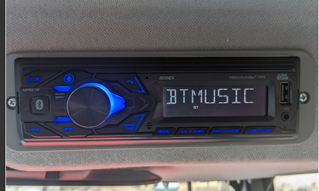

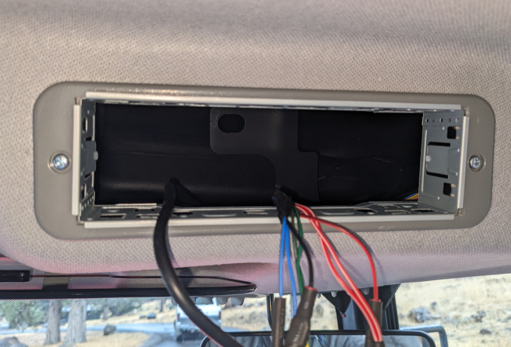

Installing single DIN radio unit
As far as installing the radio unit, I just cut and dremmeled the dummy face plate. Take your time and go with small steps. These bluetooth radios are really small and weigh close to nothing, so there is no need to buy any special supportive brackets, etc...
Radio inserted into bracket :

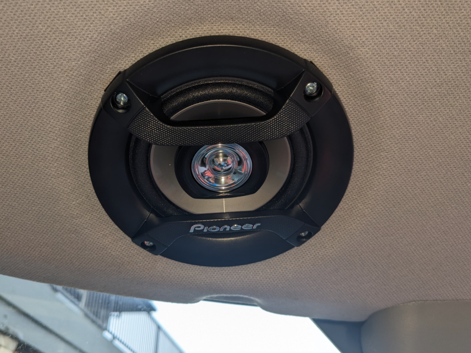

Speakers
The OEM speakers are really awful quality and the 25$ Pioneers as shown above run circles around them.
The biggest challenge was actually to remove the OEM speakers since they are held in place by nuts and bolts which did not always want to cooperate to their removal.
The aftermarket speakers are a drop-in which do not require any extra cutting in the cab's liner. I would suggest to use clips and screws for their install, not the above mentioned nuts and bolts. The Pioneers come with clips and screws in the box, however, I ended up using slightly larger ones which I had left over from a previous project.
As a side note, while these speakers claim they are 150W max, all of this is obviously a hypothetical peak power and not RMS. It is key in our situation to find speakers which match the head unit, which also makes an unrealistic claim of 4x50 Watts. The good news is, whatever the peak or rms claims, this combo of head unit and speakers works. I've heard of more expensive Kickers not working since the head unit didn't have enough power to 'drive' them. Whatever solution you go with, this is something you should take into account.

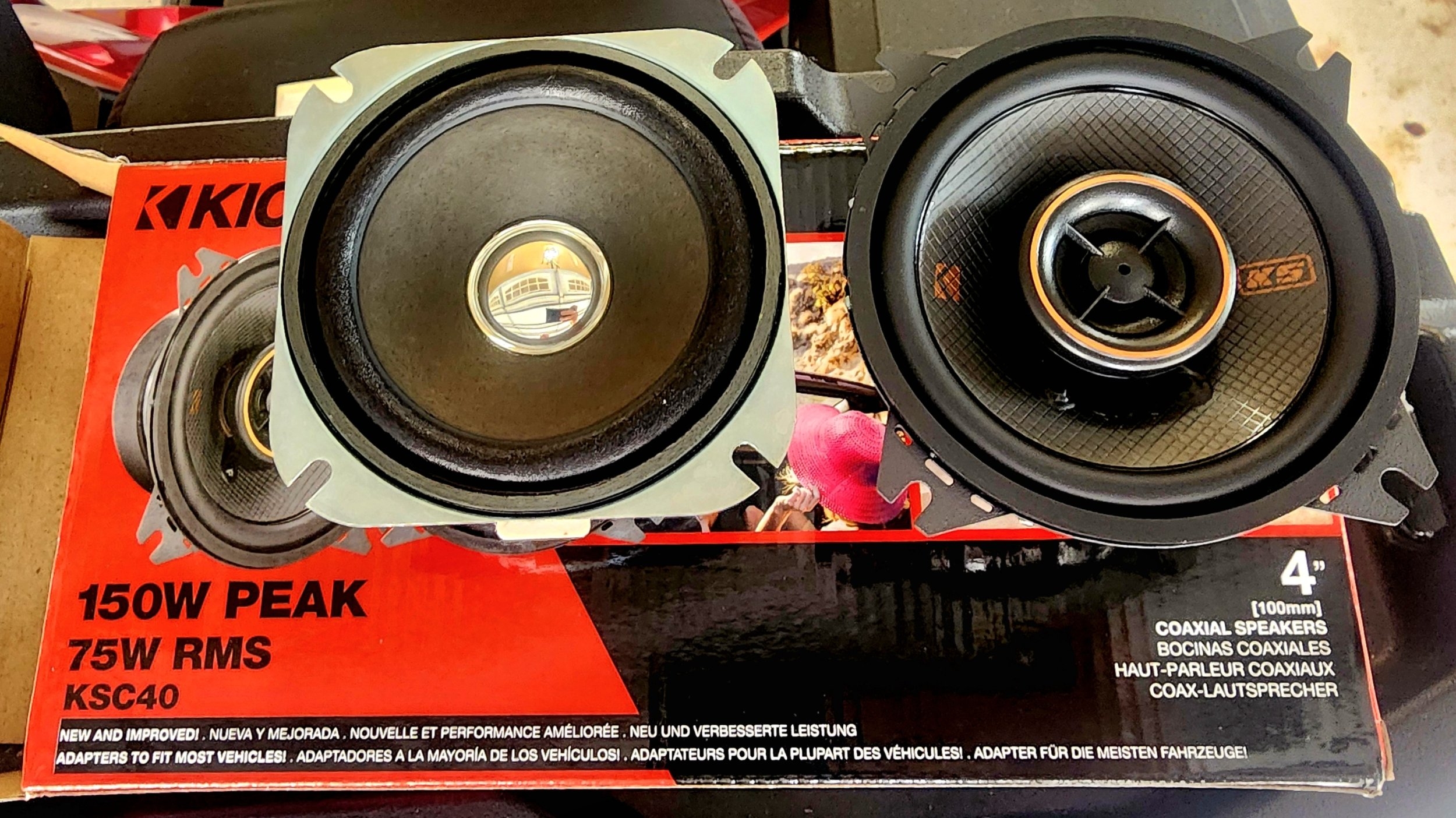

Juat upgraded the speakers in my DK5310SE; The head unit installed by the dealer at purchase and was an upgraded aftermarket unit with 50W/channel, BT, etc.
Purchased these Kicker KSC40's with recommend power of 15-75W, big difference in overall quality, mid-range isn't the best, but still better than stock.
They fit the stock bolt pattern and stock grilles perfectly, just unscrew 4 screws, pull the old ones, connect the new, screw back into place & done. The speakers come with wires & barrel connectors if you don't have an adapter.
Stock Vs new:
