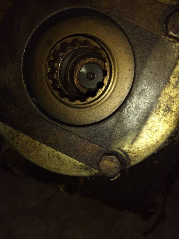

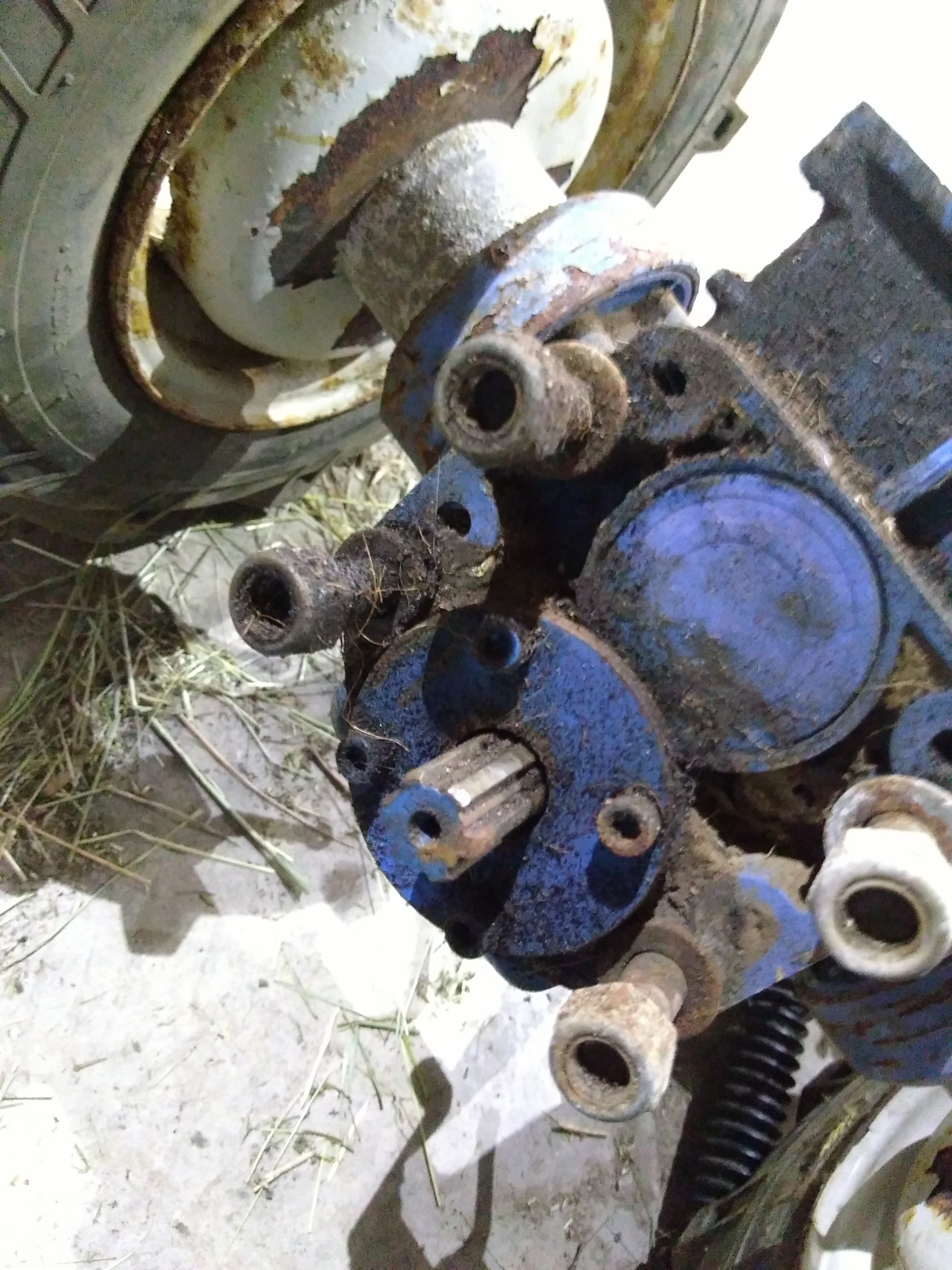

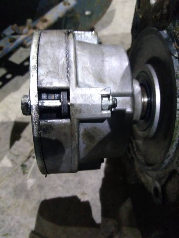

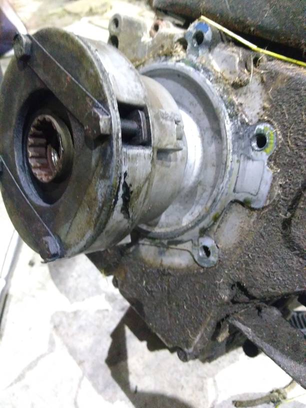

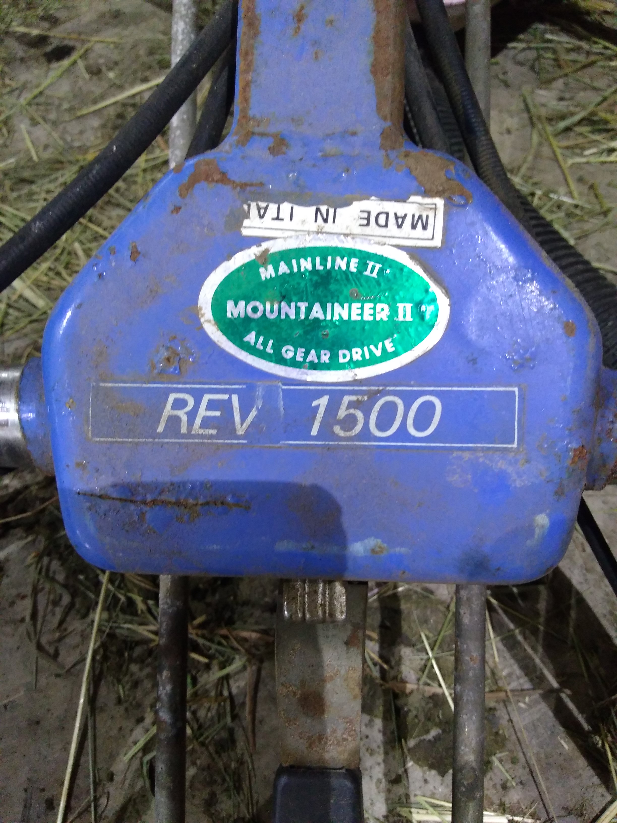

I was given a machine that (per the stickers on it) is a Mainline Mountaineer II REV 1500. It was reportedly having clutch issues and the guy I got it from removed the transmission top cover plate/handlebars to look for the clutch.

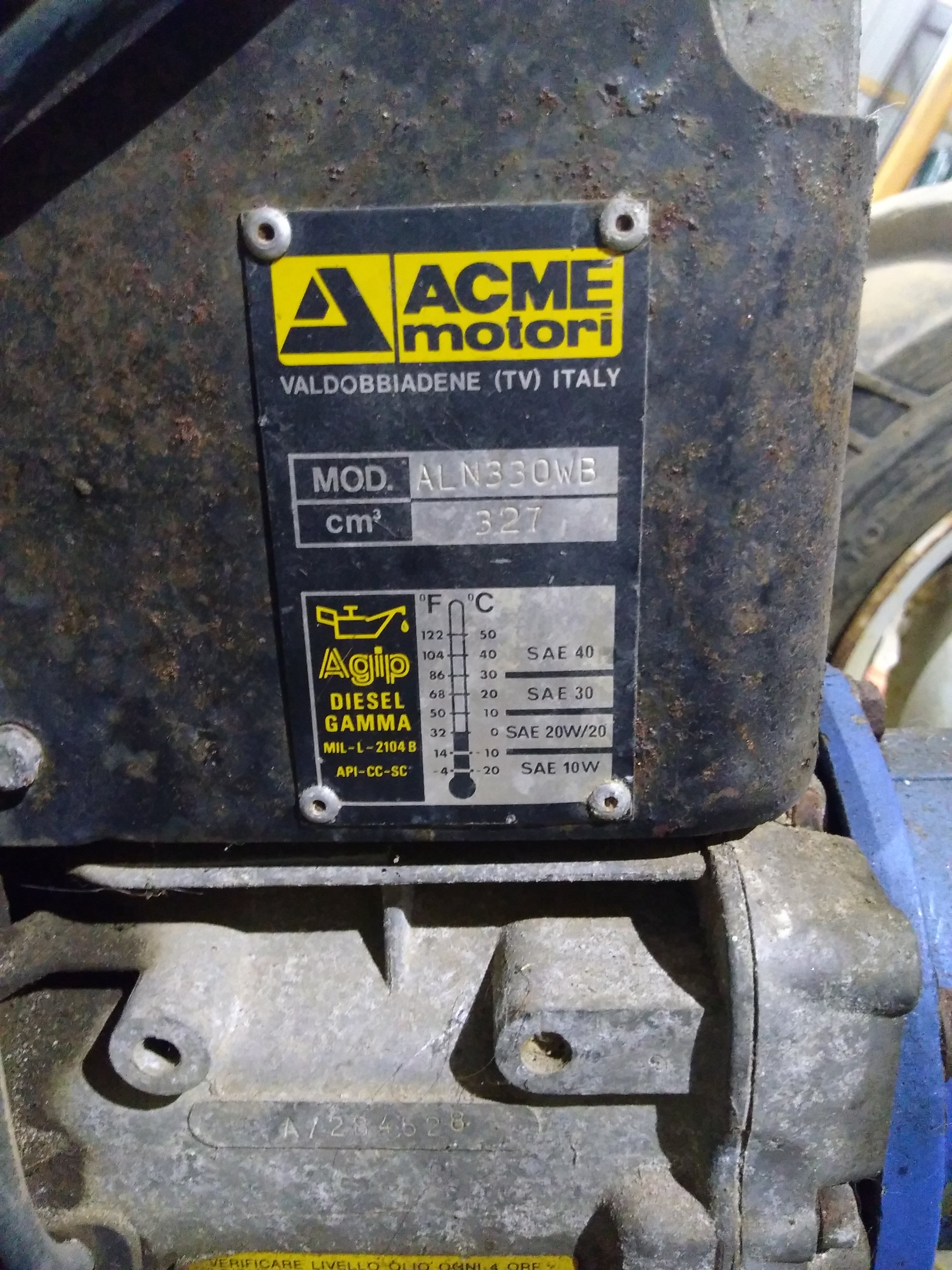

It has an Acme 330WB engine with a rope recoil type starter.
Are any parts still available for this tractor (I need the splined coupling to connect the power head to the PTO)? Anyone know where I can find a parts diagram?
My parents had a BCS for years (I think it was a Harvester 718, it had an 8HP Kohler on it and they bought it in 1996), should the clutch in this Mainline be similar to the cone clutch that was on that machine?

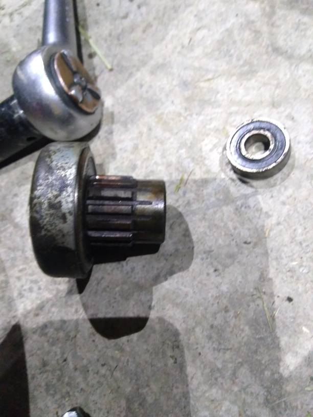

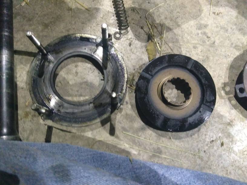

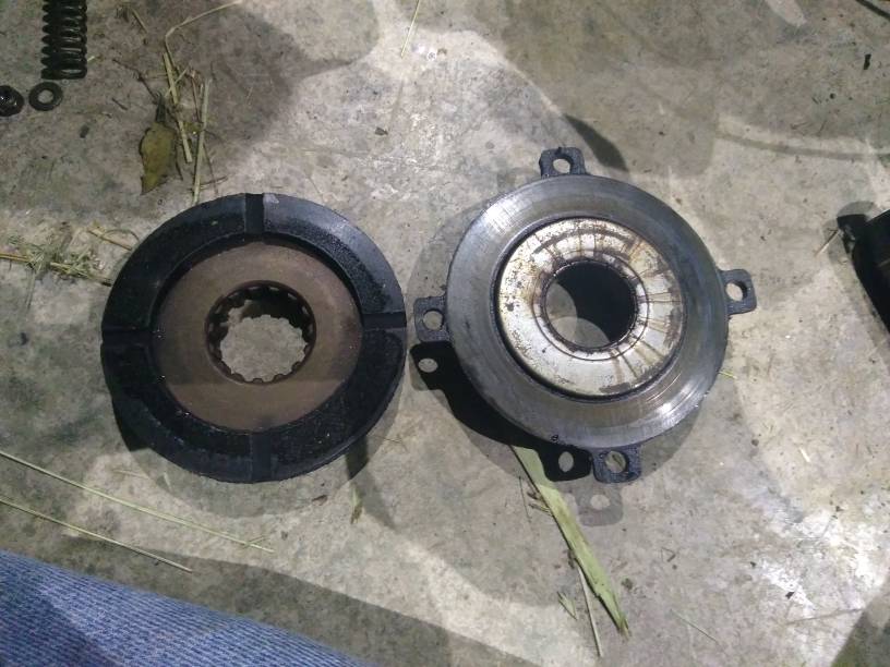

I pulled the engine off today and disassembled the clutch. It is not a cone clutch, it is a flat plate clutch with a double sided friction disc.
This is the rear clutch disc and its side of the friction disc:
This is the front clutch disc and its side of the friction disc:
Side of the clutch:
This is the pilot bearing and throwout bearing:
This is the clutch as it is mounted to the engine:
This is looking into the clutch when it's mounted to the engine, this is where these throw out bearing gear and pilot bearing end up:
