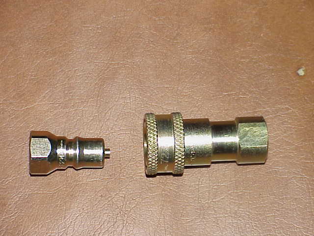

I'm trying to add a hydro turn front blade to my bx2200 and have had no luck locating the quick disconnects for the hydrualic hoses. I live in suburbia and the closest thing we have to a farm supply is Fleet Farm. The fittings they had were close but not close enough. Can anyone give me the description of what I'm looking for or where I can order it? Again, I want to hook up to the FEL lines. Thanks, Mike
   / 0 for 2 on Kubota Hydro fittings #2
I just happen to have on on my desk.. not as messy as the garage, but close. It is a Snap-Tite model 72. This is an industry standard disconnect and can be found on line at web page The information stamped on the fitting is "Snap-Tite Inc. 72" .....72C4...... The n*pple (not certain if the word is allowed) is stamped "72N4". I have also seen this part in brass by other manufacturers. I believe that they cost about $25 per set from Kubota. You should be able to get them from any shop that sells hydraulic parts..

The Kubota B series, and I believe the BX series, use a standard 3/8 inch hose quick disconnect coupler on their loaders. Should cost about $15-$20 at any hydraulic repair or parts shop. Check the Yellow pages for one near you.
Or you could check out Hydraulichosefittings.com . I believe you are looking for Series 4000 Ag couplers.

Junkman is correct on the couplers. I got mine from your backyard /forums/images/graemlins/smile.gif JEM Technical carries the Snap-Tite 72C4-4F couplers and 72N4-4F nipples. The 4 designates the size, in this case 1/4". They have larger if you need them. I like the Snap-Tite brand as they have better flow specs but you can get the same category from other manufactures from Fleet-Farm or Tractor Supply (S. St. Paul).

They are the 3/8", Snap Tite series 72. That is exactly the same disconnect as what the loader uses. $15.33 for the connector, $7.52 for the nipple. I have the 3710, not sure if your loader on the BX will have the same size or not. Probably, but may be 1/2". Look at the nipple, if it is 3/4" to 1" in dia, you have 1/2", around 1/2"-3/4" it's 3/8". If you order today, you will probably get it tomorrow, but that may not work this late in the day.

The Husco loader valve on the B series, L series, and probably the BX series, uses 3/8" ID hoses with 3/8" quick disconnects.

Fleet Farm actually had the correct size fitting, it had a different shape to it so I couldn't use it. I need the exact match which appears to be the snap tit fitting. JEM technical was out of stock with a 7 week lead time /forums/images/graemlins/frown.gif
