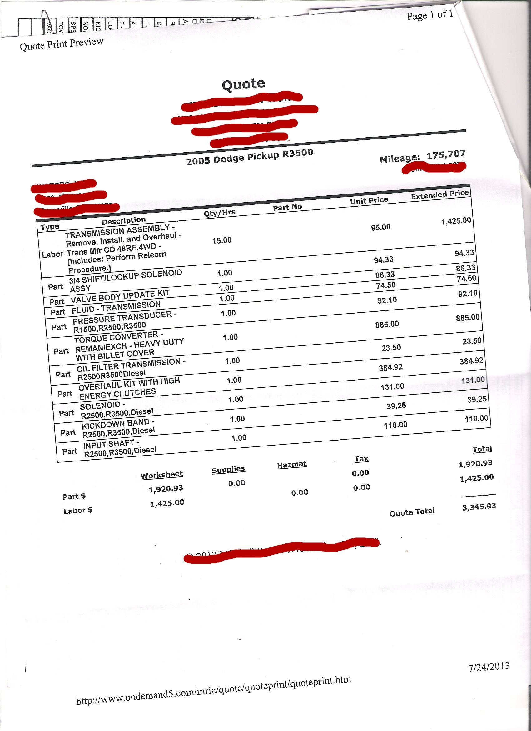

Picked up the truck today. She says it goes into gear much more positively than it did. Only time will tell for the rest. For those who might be interested, I've attached the itemized bill of materials for the repair.
