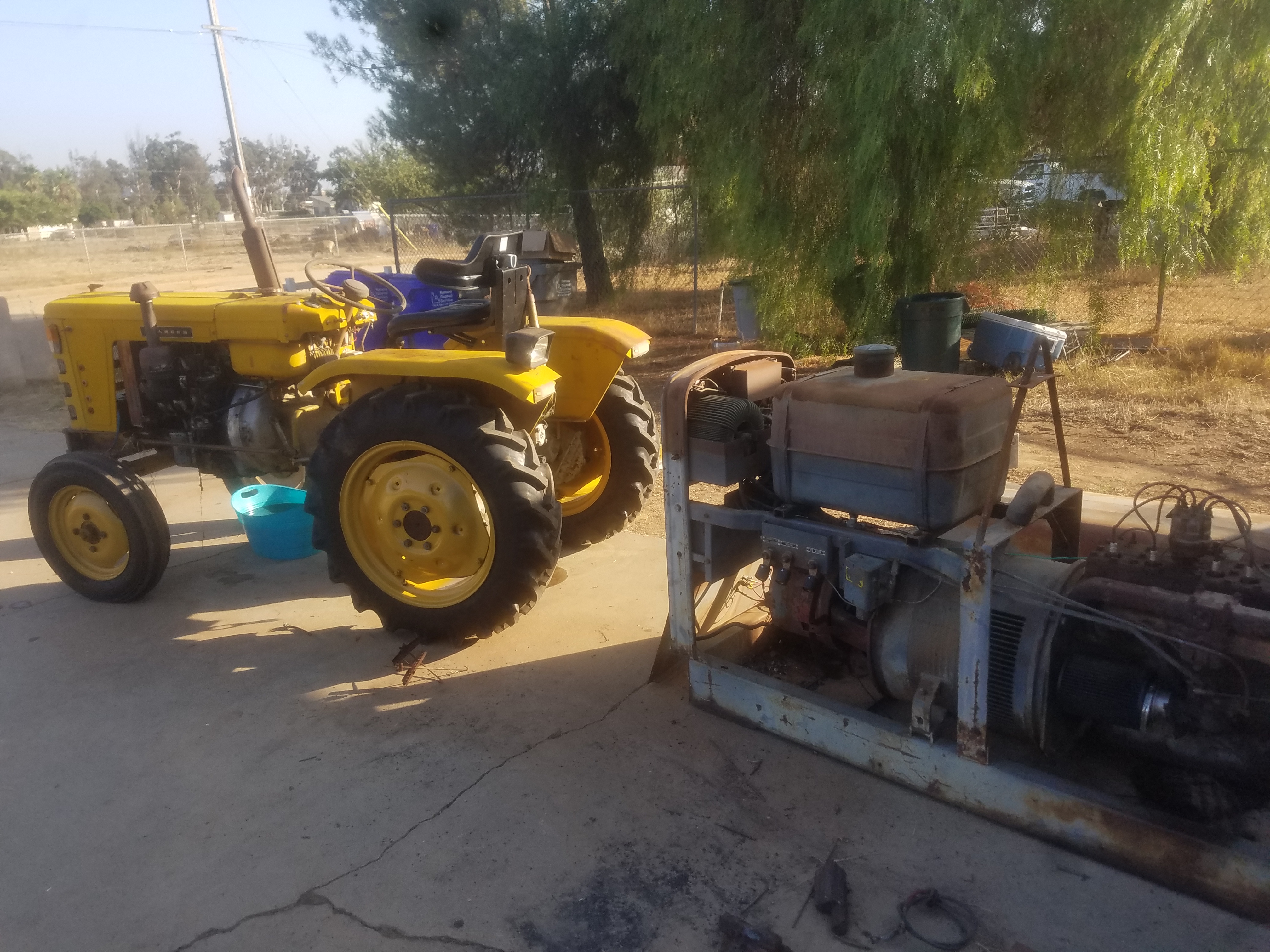

$150 for the tractor which included a 10 disc harrow (at least 360 lbs in wheel weights with it). Changed the fluids and filters and freed up the injection pump (thanks to bob) and it runs, stops, drives, turns, lights work, horn works, hydraulics work, spare parts available for low prices ($150 for head gasket, complete seal kit, spare valves with guides and seats, ball joints, spare hydraulic strainer etc). Biggest cost so far was all new rubber (yes I know the rear tires are on e the wrong sides; late night install) Do you think I got a good deal? Other recent good deal pictured is the Lincoln SAM400 welder I got for $800 in non running condition and got it running and welding. Super smooth arc (almost as smooth as a round barrel SA200) and also has CV for wire which I am currently running .052" dual shield for welding up 1" A572 Grade 50 plate

Fantastic deal unless you want to use the PTO.
Does it turn in the standard rotation and at the proper speed?
