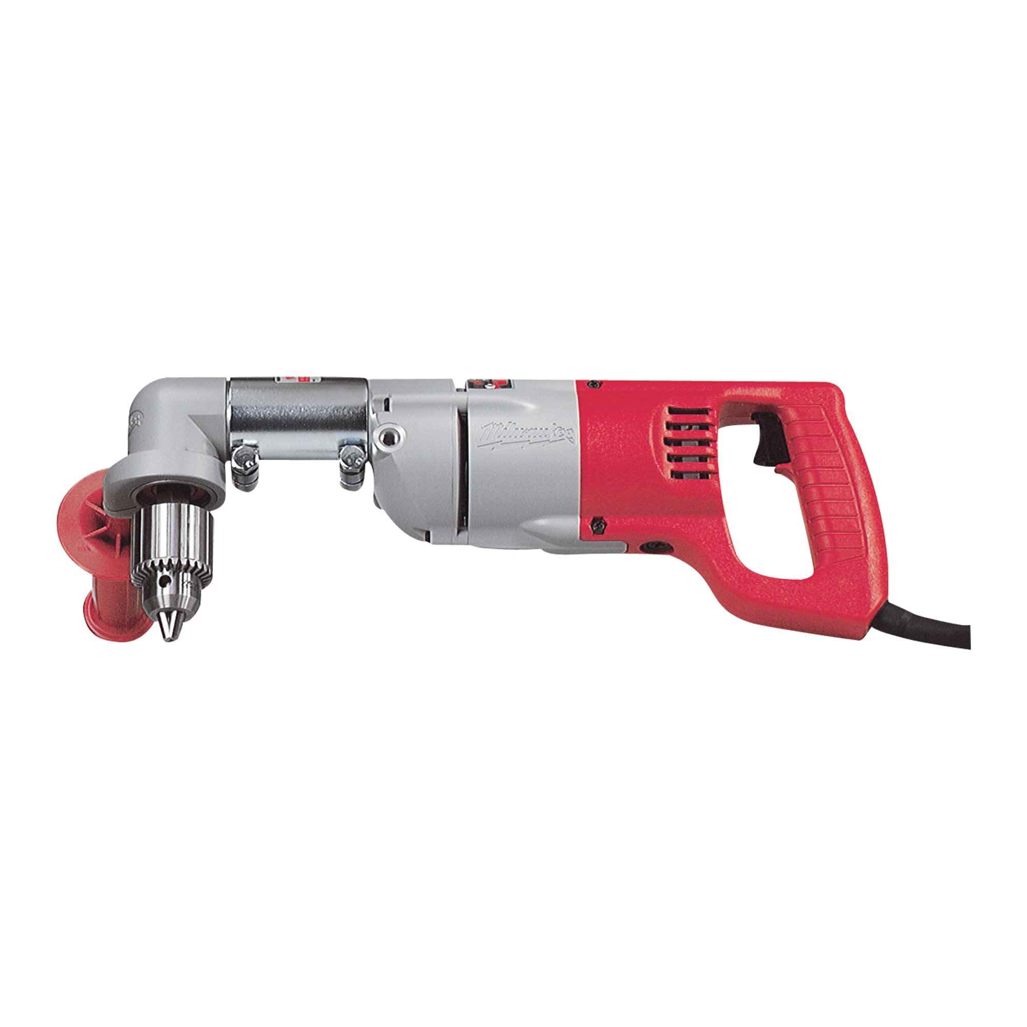

Boy do I know of what you speak. I have a 1/2 inch Milwaukee Hole Hog. I use it, my portable generator and a 1" x 24" long ships auger to bore my pine tree stumps to encourage rapid rotting. I usually put about a dozen holes in each stump. I've had many time when the auger would bind up and I would be thrown around the stump before I could turn loose.
My side handle is a 18" chunk of galvy pipe and it still pulls out of my grip.
I'll bet it still hurts - - I guess you are fortunate, in that the side handle didn't come around and smash your hand along with the damage to the webbing.
I have real respect for the power of that drill.

The only saving grace with these monsters is that the rpms are low enough that the operator is only slung in one or two full circles before the cord is jerked loose and it stops. When I have had to use it, I try to be sure that there are not solid objects in the path of where I will be slung.
Wife got whacked up-side the head once while using this one's little brother drilling 5/8" holes in a steel post with a twist bit.
They demand respect.
