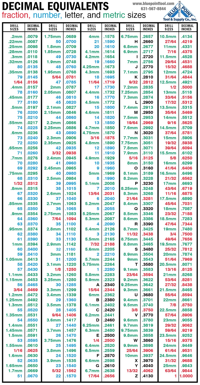

4 / 25.4 = 0.1575"
A hair bigger than 5/32" but now your talking hex-keys most likely if you are working with stuff that small. And with hex heys....about the only ones I will interchange are 8 and 5/16. Cause aint much worse than a rounded out hex-key or bolt
