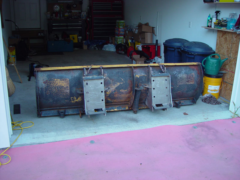

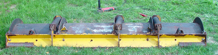

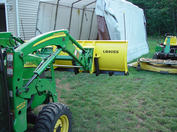

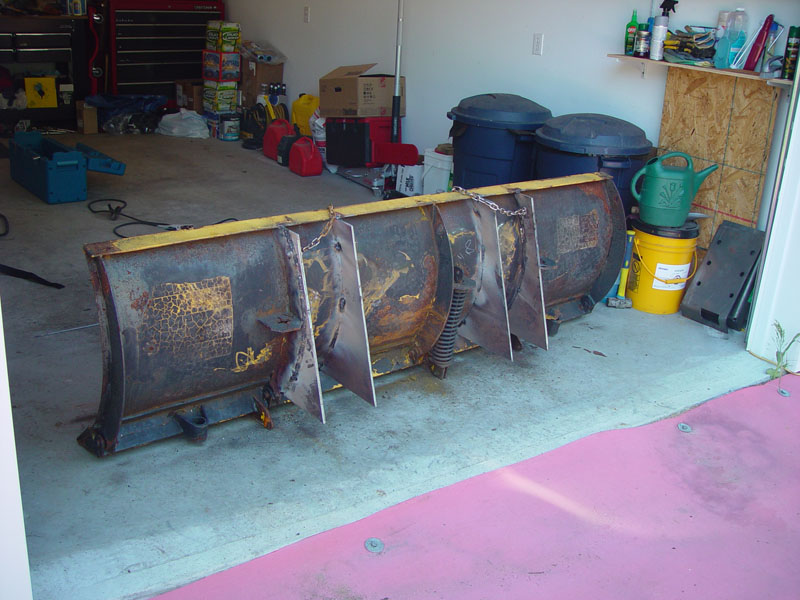

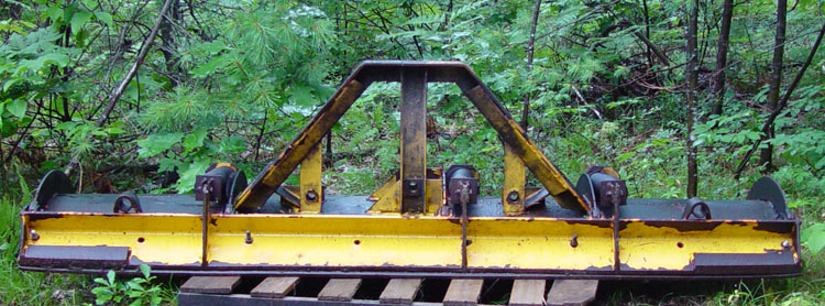

Well I'm 1/2 Ready for snow now...:) Blade is all done and I'm just waiting on a call from the dealer saying my 74" Rear Mount Blower is in.
Little Rundown:
-Started out as a rusty 7.5' Fisher Plow I found on Craigslist right in my town
-Cut off all factory mounting brackets
-Fabbed up new ribs to accomodate the 20 degree angle for the Skid Steer QA so I can be "true to spec" and not need to adjust my level indicator
-Used the SS Quick Plates from JinmaParts.com
-Sent blade to local coatings shop...sandblasted and powdercoated it JD Yellow
-Custom made my own graphics and had local sign shop cut em out for me.
All in all it came out really good and I cant wait to give it a whirl in the snow

Just one question why did you go with a straight bland and not keep the angle adjustment?
   / 1/2 Ready For Snow..FEL Blade is Done #4
Awsome job. Also love the decals. I want the deer decal.
That is percisely my question also and I also see that you don't have any plow shoes on it. Plowing is done much faster with and angled blade. I just finished a 8 foot Fisher on a QA mount for a Bota.You want those plow shoes on there at least until the ground get frozen really hard.

Lemme see if I can answer all the questions:
If you or anybody else wants the Fisher/Deere "Splat" I have one extra currently, and I can easily go get more cut out...shoot me a PM if interested.
Straight Blade vs Angled....Pretty Simple really, strength. I've seen 2 loader frames tweaked sideways because someone was running it angled and hit something or a snow pile....loader frames are NOT Deisgned for "side to side" loading...
