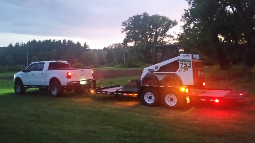

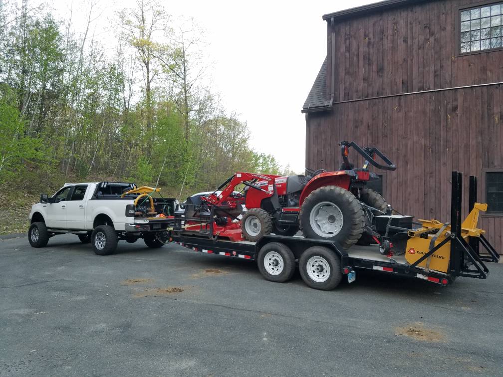

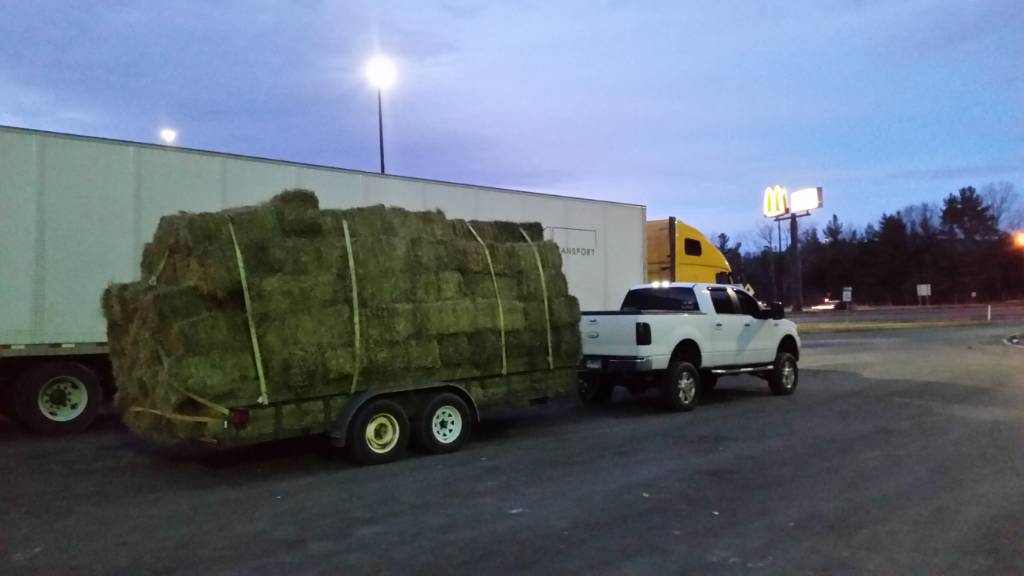

I fully support the firestone bags!! Will not own a truck without them. I have a 2005 f150 crew, 4.56 gears, and a whole lot of other mods that makes her far from stock. I tow pretty heavy with mine and does great so I know without a doubt the bags will work for your use. I have the onboard compressor mounted under my bed side. Great addition and I highly suggest it if possible. The tractor pic was prob the heaviest she's ever pulled. That was when I was moving and trying to get it all in one shot 20170730_181108.jpeg20170511_193803.jpeg20160221_175440.jpeg20150830_194856.jpeg
