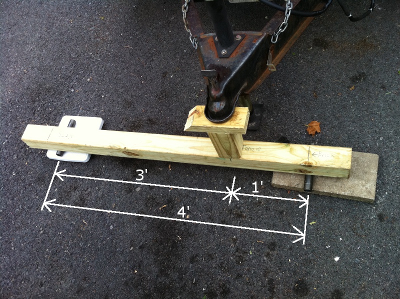

Might be worth doing the balance beam test to make sure you're putting the amount of weight you think you are on the hitch.

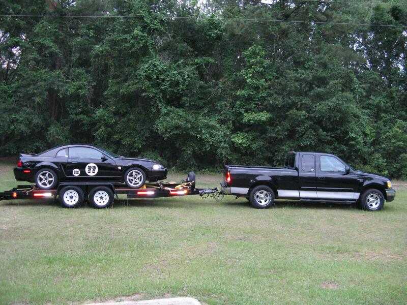

This is my 3600 lb Mustang on a 1200 lb trailer with 500 lbs tongue weight.

I have a simple frame built to use a bathroom scale that is vary accurate based on this idea. I actually have 4 of them for corner weighing race cars on a budget.
We had a professor at work that bought a trailer they intended to tow with one of the department's 1/2 ton field vehicles. I took one look at it and knew it wouldn't work. After they loaded their sound proof enclosures and generator in it I took one of my bathroom scales and 4 to 1 thingy in to weigh the tongue weight. It spun the 250 lb scale all the way around and stopped at 25 lbs. My 4 to 1 calculation came out to 1100 lbs tongue weight. Well over what a 1/2 ton truck is normally rated for. We used a truck from the maintenance department to tow it to a certified scale and the tongue weighed in at 1110 lbs. total trailer weight with her load calculated at north of 8000 lbs. The tongue weight was okay for the total weight but weren't no way to pull it anywhere, much less into the mountains, with a 1/2 ton truck. She had started with a base trailer and had the roof raised and structure added for AC and then installed two sound proof rooms. She ended up using another 50 grand of funds for a dedicated dually.

JD855guy, thank you! I was wondering how to go about weighing the tongue without going to public scales...awesome!
   / 1/2 ton truck owners #19
Found a diagram:
