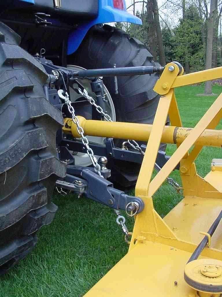

"How do you limit the travel of the arms for an implement that needs to be a certain height?"
I haven't had to do it myself, because mine has position control, but I've read on this site of people using "check chains" that go from the upper frame on the back, down to the front of the attachment. You set the length of the chain at the lower limit of where you want the attachment to drop and then you don't have to look back at it.
   / 1/4 Inching and Postition Control #13
Here's a pic I save of check chains:
