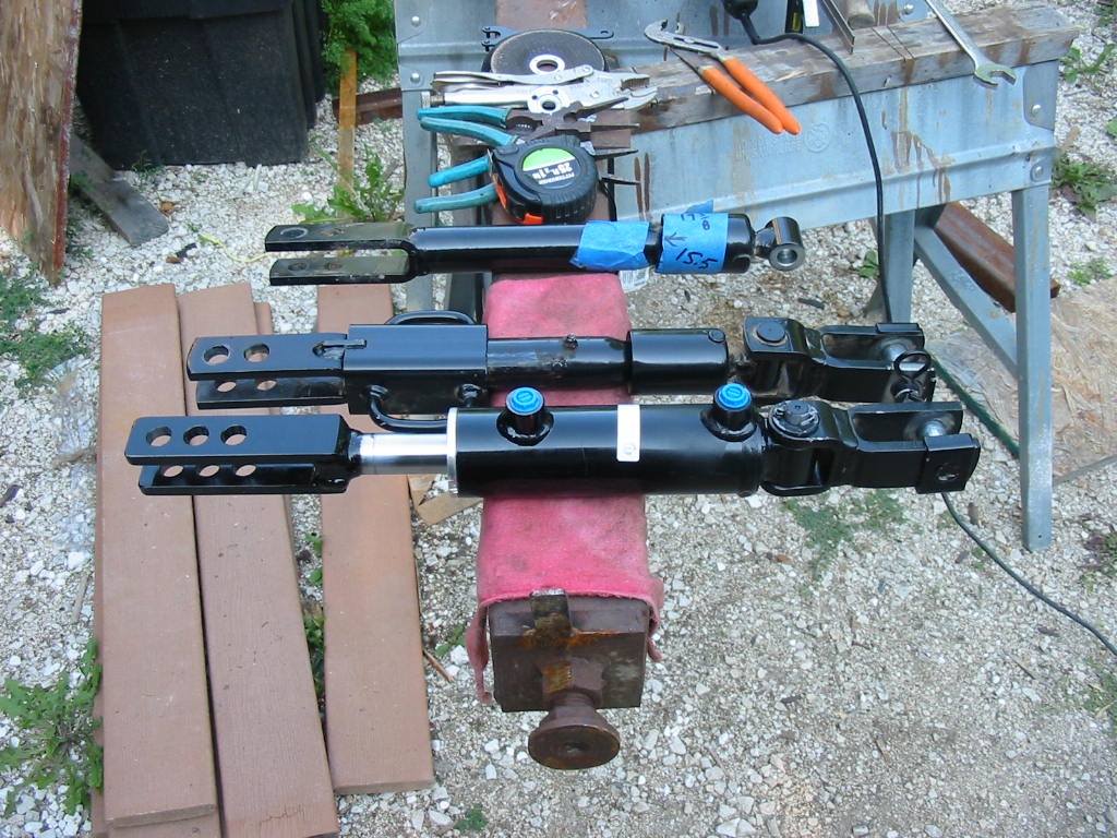

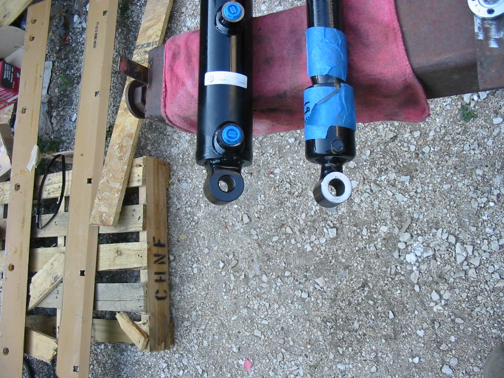

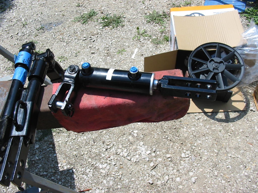

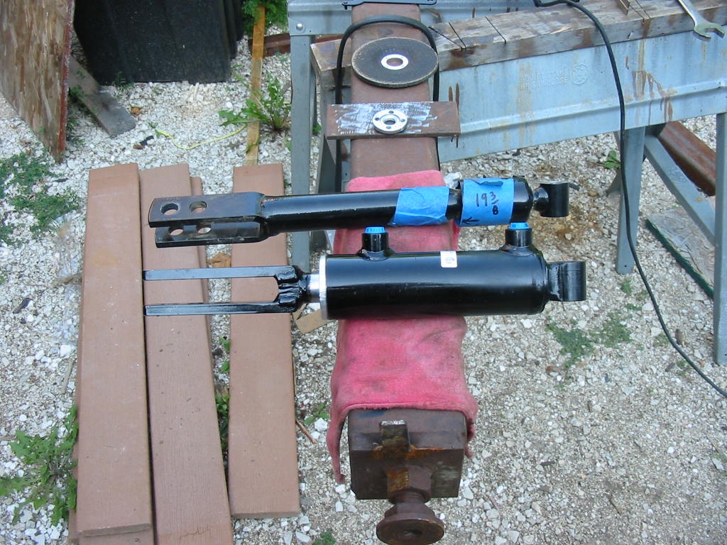

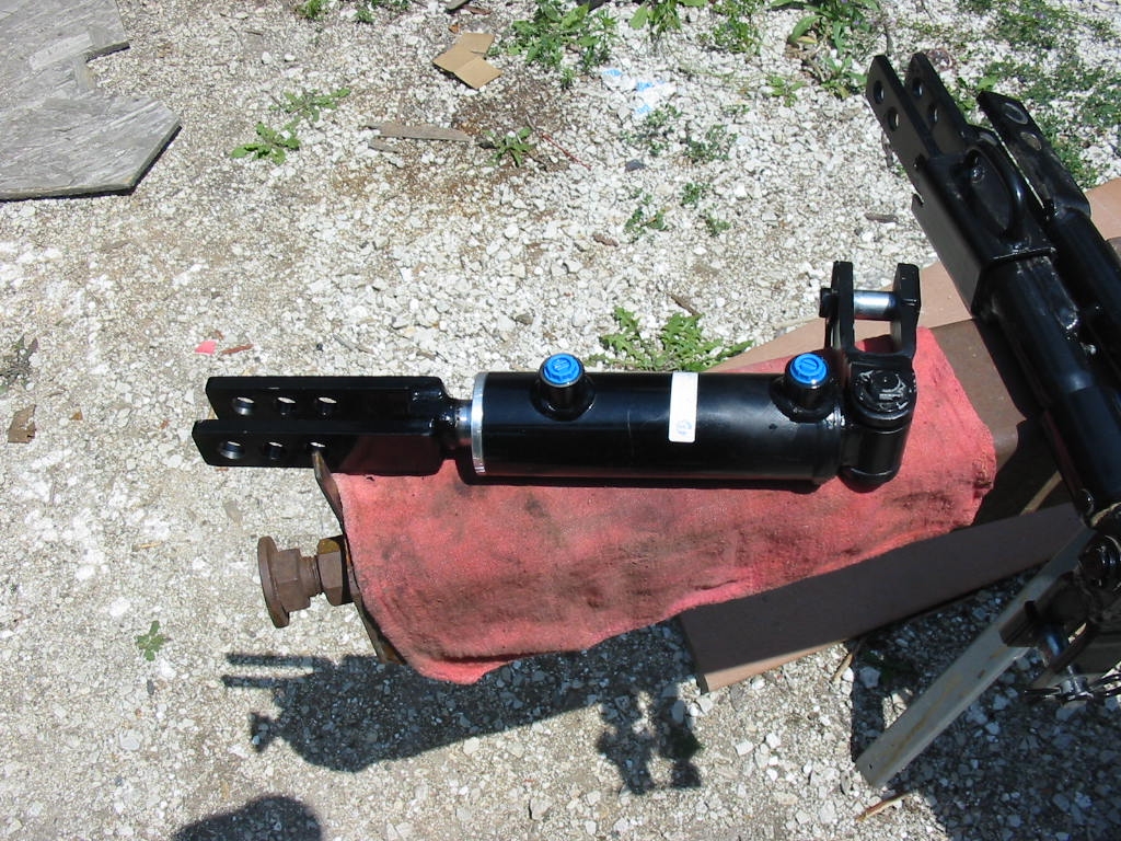

Well I finally got around to figuring it out! I had to cut the top eye and flat bar off. Then I turned a rod end with .635 hole on the lathe. I made it a little larger in diameter to keep the hole center away from the cylinder to give me the proper length and make it a little beefier. I now get the proper lengths, 17.5" retracted and 21.5" extended. Plus I have one hole above and one below for adjustment. I removed the cylinder gland and piston and kept everything very clean and flushed it out with brake cleaner though I am sure there was nothing in there. I relied on you tube cylinder repair videos as I had never attempted to weld on a hydraulic cylinder before.
I used to bore out the clevises on large gyro sphere rock crusher cylinders but never took one apart or welded on one! 19.5 extension.JPGWeld view 2.JPGWeld view.JPG
