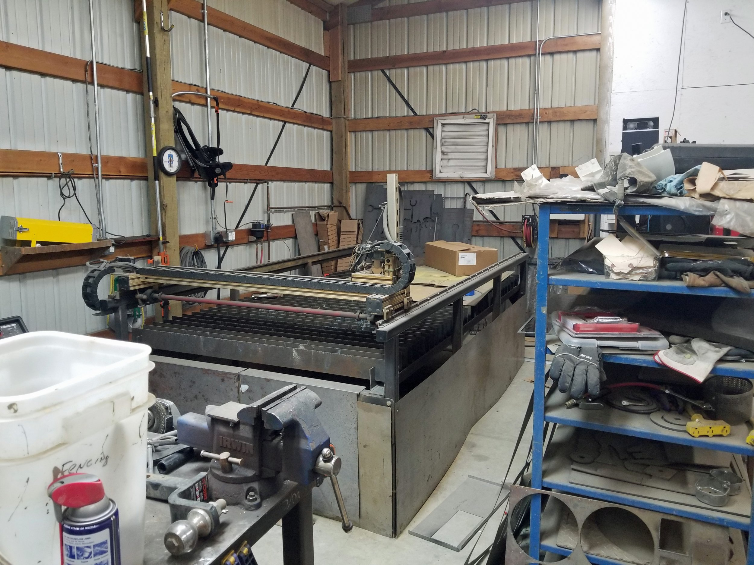

AS others have said, thats too big for really anything in the shop.
I wired my whole shop with 3/4" EMT for the welders and air compressor plugs, and anywhere I was pulling several circuits. And 1/2" for 1-2 circuits.
Cant even hook 1-1/2" to a workbox.
And at $1.40 for the flex.....it will cost you more and look like crap. 1/2" EMT is like $0.70/ft and 3/4" is a little over a buck a foot.

I just redid my barn wiring to prevent rodent damage. I started with aluminum flex, but the fittings were expensive and the job didn't look good. Difficult to pull wires through. Ended up doing most of the job using a lot of 3/4" EMT and the rest of the 1/2" that I had laying around from another project.
If I was doing the job again - and on all future wiring jobs - I will standardize on 3/4" EMT tubing and wire with 12-2 NM-B with ground. That combo will do anything, is large enough for multiple circuits, and is small enough to be workable & reasonably priced. And is available everywhere. Plus it looks good.

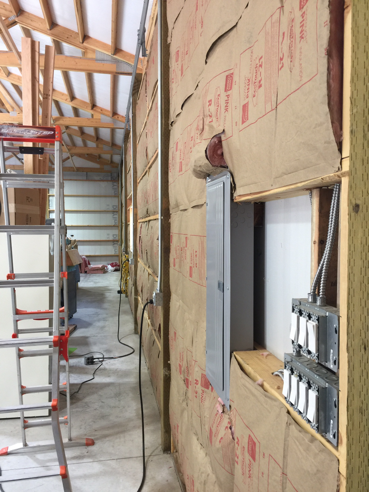

My entire shop is run in EMT, and i wired my house in steel flex. Comes from years as commercial electrician, and the fact that i hade a 28’ trailer full of the stuff.
   / 1.5 inch flexible aluminum conduit #19
My shop was done in 3/4 EMT and 12/2 for most circuits (less W/D, water heater, mini split, welder and RV).
I’ve added some additional circuits using the combination of 3/4 EMT and flexible armored wire- wish my bends looked anywhere near as good as the pro who did my original installs.
   / 1.5 inch flexible aluminum conduit #20
EMT is definitely the way to go in a barn, esp. if it's exposed and visible. But you'd do well to not bother with pulling NM-B thru EMT, rather just pull individual conductors (eg. THHN). Romex (i.e. NM-B) is a ***** to pull thru conduit, and there's absolutely no need for it.
