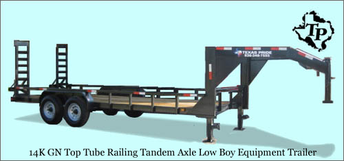

   / 1" drop or 0" drop ball mount #28
   / 1" drop or 0" drop ball mount #29
It's hard to read the parts you have circled. What year is this spec sheet from? Maybe it's an older one and that's why it has the 10,000 lb restriction.
I looked at the current Ford and GM guides online and they seem to range 12.5 to 17K for conventional towing.
My 4 year old 2008 GM owners manual says 13,000 lb max for a weight distributing hitch. The current 2012 GM guide is a little higher, up to 14K for the gas and 17K for diesel dualies with drawbar ball hitches.
