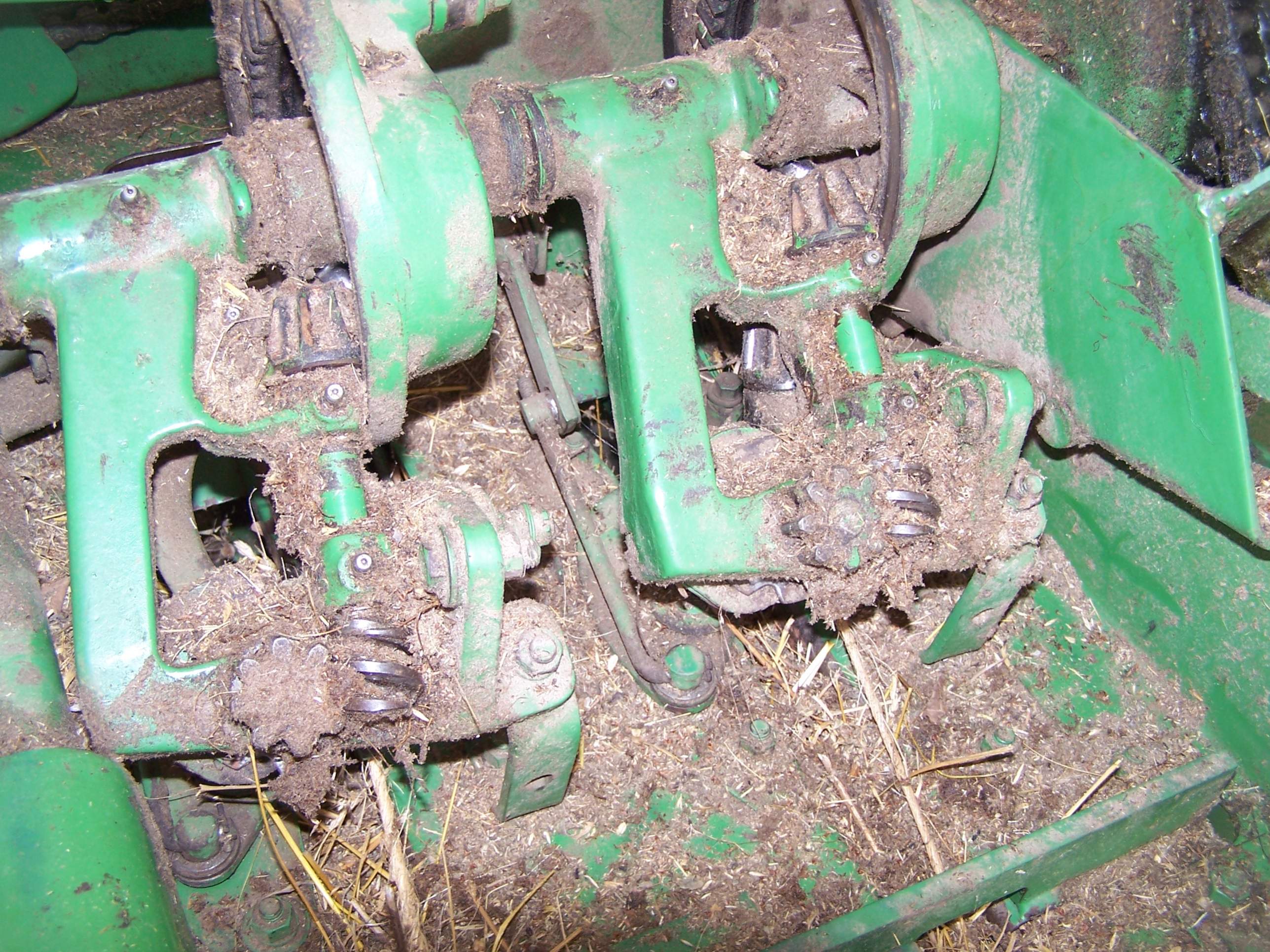

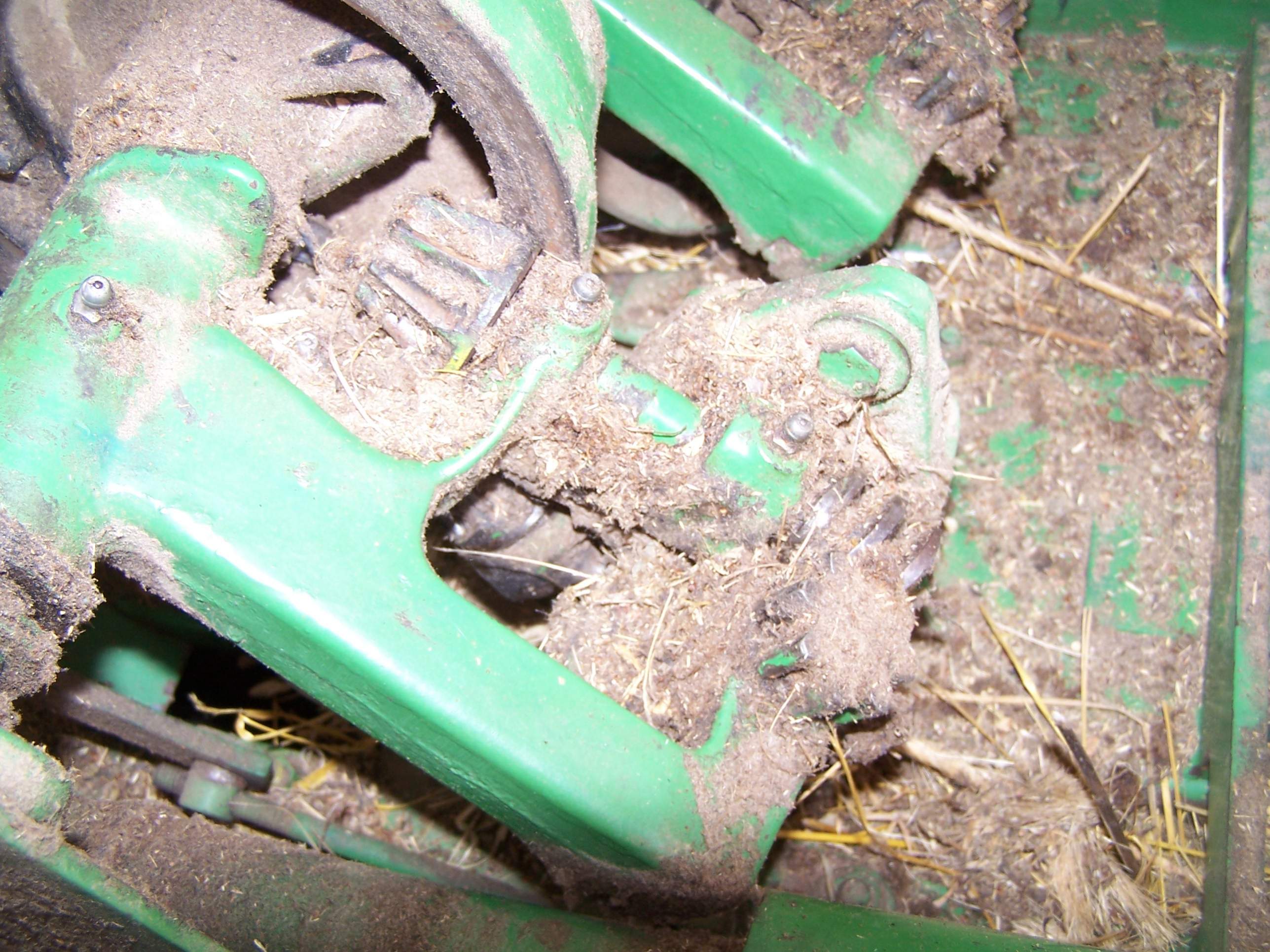

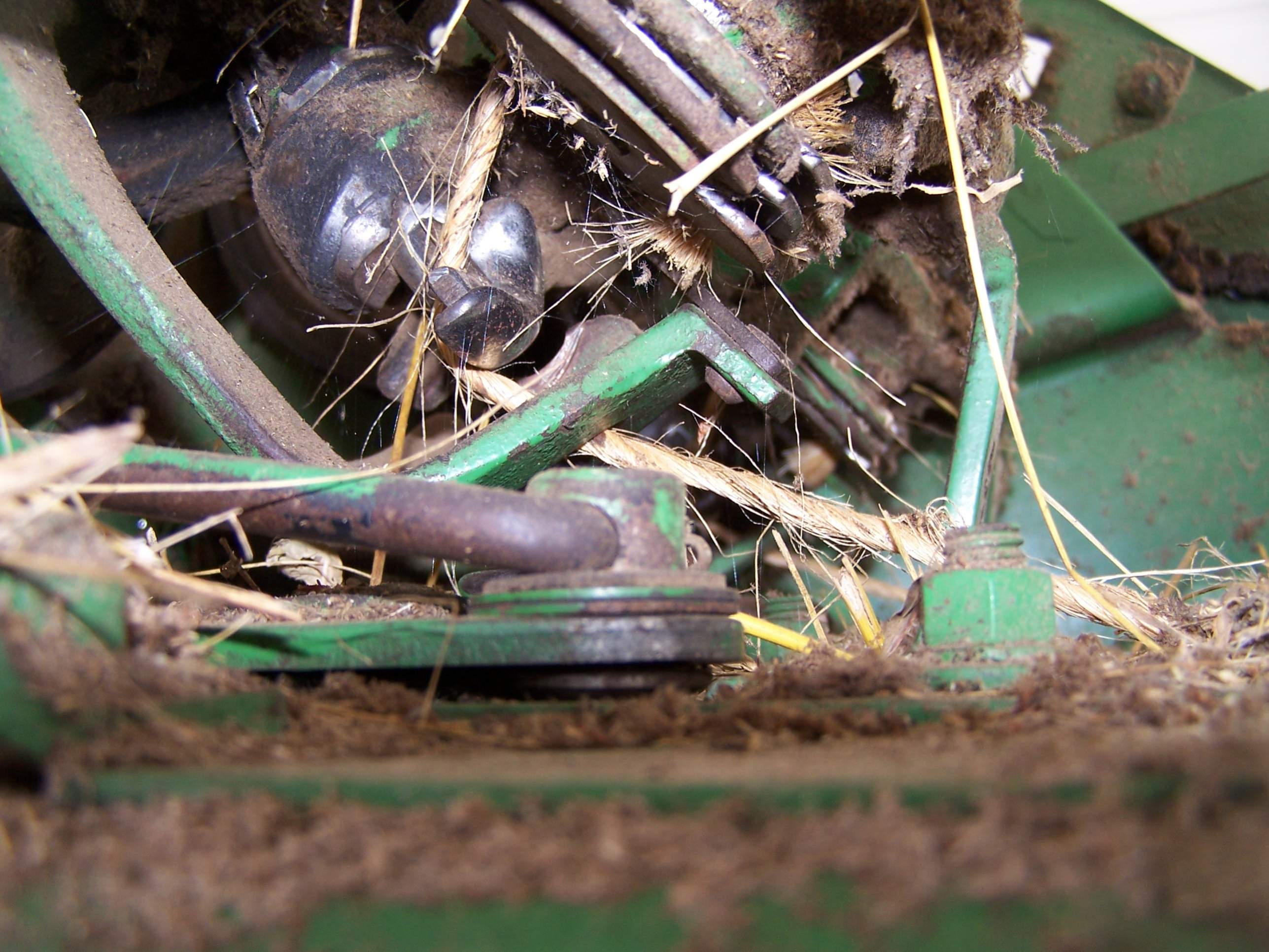

Nice baler. How about adding closeup photos of the knotters and the knives in the baling chamber. Don't like the fresh hay in the chamber. Prefer to be able to see the innards of the chamber before making a buy decision.
The baler is at The Munfordville store and here is what Son sent me. Hope this helps. Ken Sweet

Knotter assemblies look to be a low bale count baler. Big fat billhook! :D No groove and pointy end there!
Some wear on the knotter pinion gear - but not excessive - especially for that model of baler!
Couldn't see the twine disc's very well - but there didn't appear to be very much slop between them.
If the chamber and the stationary knife looks like the knotter assemblies; $3,200 could get you a baler that will go another 20-30,000 bales without a dropped knot!!
