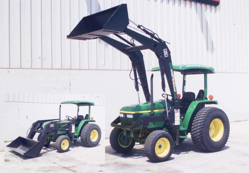

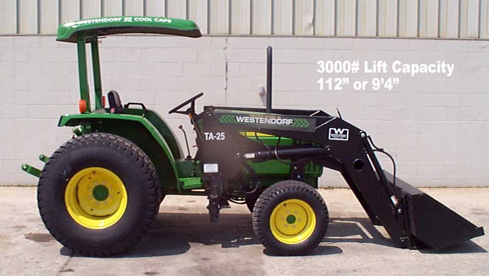

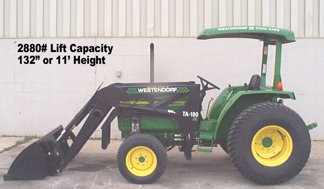

That is an accurate lift capacity - our loaders will fit the unit close to the front so you won't require such a "big" cement truck :eek:)- however you would need to have a ballast especially if you are frequently working at the full height of the loader. We've been selling loaders a long time (since 50's) and that JD has an excellent frame - no reinforcements or rear axle kit was called out. Our mounting brackets are also different as they distribute the weight of the load through the tractor frame and don't just center it in the mid-section of the tractor. We actually make a loader one size larger with a higher lift capacity of 3000# at full height. Look at the photos, the fit is excellent, below the hood and close to the front. We don't ever recommend a loader if the tractor can't handle the load capacity.
The 990 would get the job done if you unloaded that semi once a month. On the other had - if you were going to use this every day - I'd agree with Jon, that 70 - 90 HP range would be better and more comfortable.

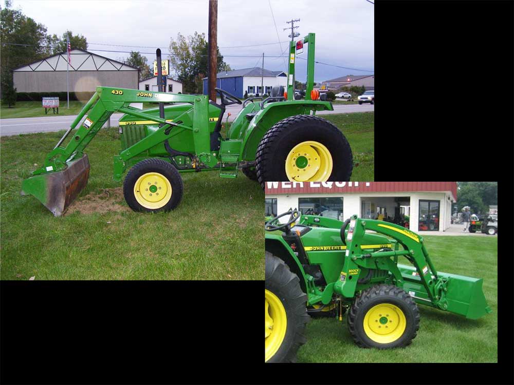

Just because the Lift capacity is 3000#, it doesn't mean you are going to max it out daily. But if you need it for a specific task, the power is there. If you were going to unload that semi daily you'd want a larger tractor.
You may perceive that a tight tucked loader is not "in vogue" because more and more of the OEM's try to use the same loader on as many model tractors as possible instead of having to stock multiple loaders. They are not focusing on the "fit". You can see in the JD photo how they tilted the 300x forward on the tractor to make it touch the ground. This will transfer more weight to the front axle. You'll acheive more power and strength if the tower/upright is straight and positioned as far back as possible (like JD 430 or TA-25). Compare a loader that fits well to a favorite pair of work gloves. If you wore a pair of gloves or shoes that were too big, they would feel sloppy and cumbersome.
I also include photo of the loader at full height, it was the best view I had of the bracket system. You can see how the brackets & tower wraps around the tractor. Then tower lowers to the ground for dismounting.
