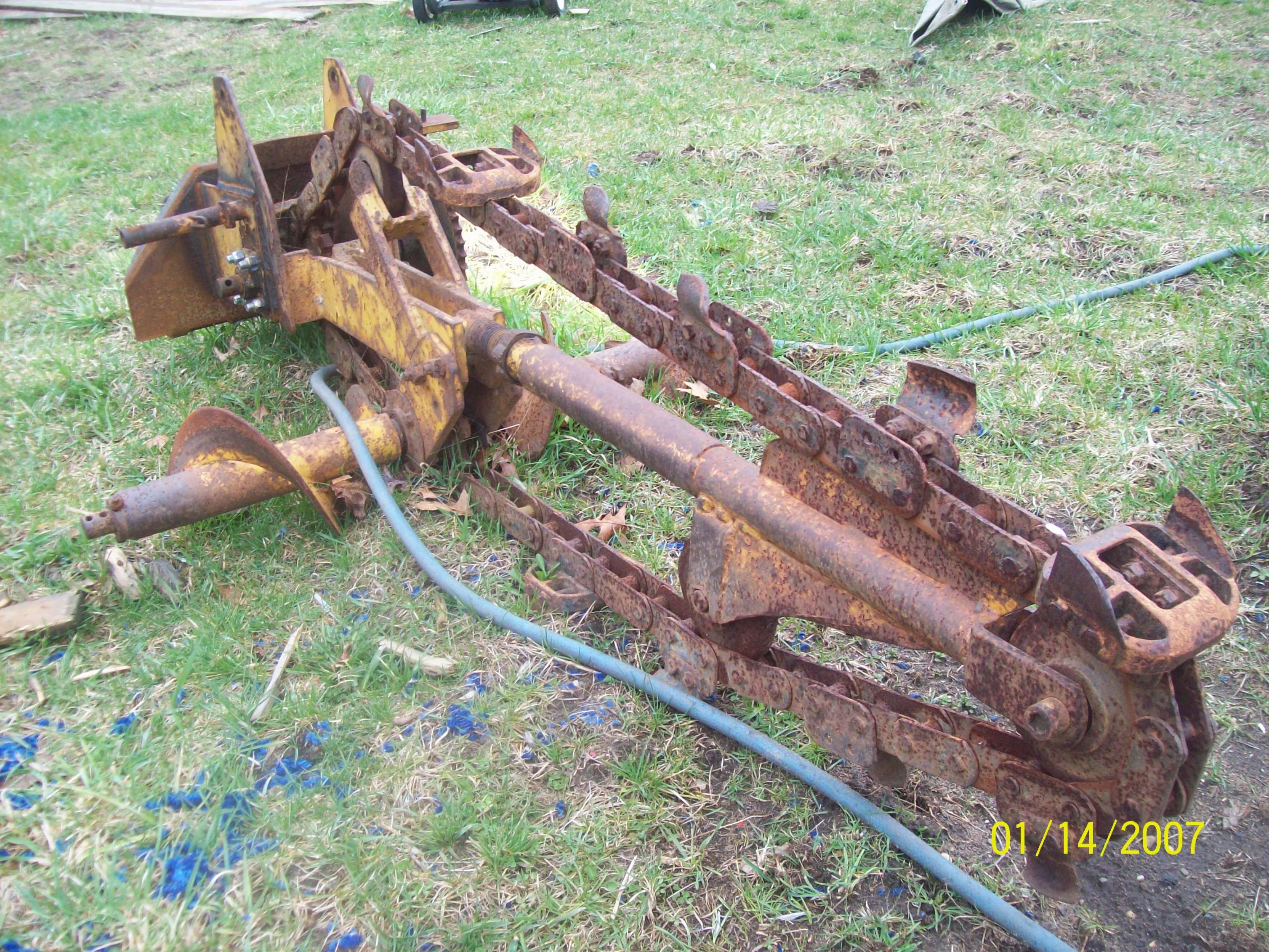

updating on the trencher according to my rough calculations a 10 cubic inch hydraulic motor should provide enough power (torque) for the digging and should provide the targeted 260/280 feet per minute chain speed that seems to be common on alot of small trenchers, my original calculations were 400/450 fpm until i realized that the older kohler gas engines did not spin at 3600 rpm if i missed something let me know i would rather over analize then build another yard ornament will post picts as soon as i talk the oldest daughter into posting them for me
   / $10.00 Slicer/Trencher #23
update took the plunge and order my hydraulic motor and coupler, will buy hoses locally, can't wait to get the motor so I can start fabricating the mount
   / $10.00 Slicer/Trencher #24
muffler 1 004.jpg[/B][/ATTACH][/ATTACH] hydraulic showed up yesterday with coupler workingon mounting bracket today everything seems to be falling into place will post more pictures when complete

finally got it done did about 1hour of trenching everything seems to be in good working order ie; dragged up a couple of cement blocks:eek::eek: while playing in the dirt:) I feel it was money and time well invested even though it has been a long ongoing project, luckily enough I found a local supplier that was able to cross reference the FASTER brand couplers:cool:

Who is the manufacturer of your trencher, The chain look very similar to my Power-Trac trencher, which had a worn out sprocket and chain. Chain replacement would be about $500, don't know price on the sprocket.
   / $10.00 Slicer/Trencher #28
the trencher was made by ARCHER in 1936 at least that is what the person at ballentines told me after I e mailed pictures to them hope that helps, ran trencher another 4 hrs today hooked a buried piece of steel :eek: lifted the powertrac rearend completely before the trenching chain stalled next time around I will use a reverseing motor, so I can clear the jams easier, I ended up using a 18 cubic inch hydraulic motor, with a 1500psi pressure relief, the valve does not open unless I stall the chain, overall very pleased, not as fast as a commercial unit, digs 6'' wide x 48''deep x 50 ft in 1 hour, thats still faster than I can dig by hand:D:D
