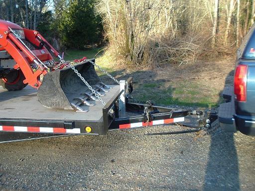

This thing is a WDH, meaning weight distribution hitch. It is not a sway control device. The purpose of this device is to distribute the tongue weight over both truck axles. If you think about it, the ball on your truck's hitch hangs way back and loading it heavily will tend to lever the front end of your truck off the ground. This contraption counteracts some of the lever effect.
Please ignore my shoddy tie down methods. I now go straight from tractor frame to trailer frame. I was trying to be clever and restrain the loader. That was an old picture from my old GM.

How in the heck would you put a WD on this? That ball mount in the pic is not what I use now. I have upgraded since then to a 14K/2K mount. Also would the AirLift bags create some WD affect?
