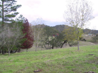

Thanks everyone. As usual, some GREAT comments that are very helpful.
So here is a picture of what the property looked like in November when we bought it. Considering that this exact place now is full of brush that is 2' - 4' tall, doesn't it look like someone mowed it down last year???
Most of the comments to me were fire-control related. But it seems like brush cutting would leave just as much kindling on the ground as simply letting the weeks die on their own.
This work of brush hogging is no more than a big rotary mower that leaves cut brush on the ground. Right? It almost seems like fire would be better prevented by turning the soil under with a plow or cultivator or ???
Thanks again.

Welcome to TBN Martin, thats a beautiful piece of property there. To answer your question, in my opinion, unless your going to cultivate the ground and plant some sort of crop, ( hay, corn, beans, vegetables, etc.) I wouldn't reccomend that you plow or otherwise disturb the ground. The grass that is growing there will hold the land and prevent erosion (even though it never rains in California /forums/images/graemlins/grin.gif).
Mowing or bushhogging will protect the property by getting rid of the tall stems of the grass. Once cut the stems will rot and add compost to the soil. If fire is a big danger, talk to your local fire department and ask them about the type of firebreak they would reccomend for your property.
The picture you have from before you purchased the property, definitely looks as though either someone was cutting the grass or somthing real hungry was eating it. /forums/images/graemlins/wink.gif
I also agree with many of the posters here and believe you should get the tractor sooner rather than later but will add a word of caution, Tractor projects have a way of multiplying like rabbits, so be ready for all the fun!! /forums/images/graemlins/grin.gif

I agree with nailerguy. The weeds and brush would initially burn easily if a fire occurred, but will rot in a relatively short period of time and no longer pose a danger. After the first mowing the gameplan would be to mow a regular basis to insure that your land doesn't generate any more "kindling."

You don't want to till or plow the soil. That would lead to erosion & washing on your hills. And, something always grows up again. Usually something you don't want growing - weeds.
Cutting the grass with a brush hog is like putting the grass through a blender. It will be little tiny pieces that will quickly rot laying on the damp soil & return to the soil. If you leave it standing, it will stand there a whole year, dry in the wind - waiting for that spark I suppose?
Best thing is to graze it, but that migh not fit your plans.
