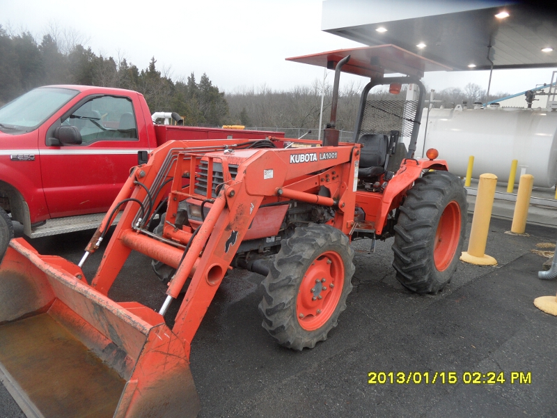

Well now a lot more TBN'ers have chimed in and it seems very few recommendations for new under $18K. Back in 2012 I realized I needed a bigger tractor for jobs I had not foreseen. SWMBO and I agreed on a budget of $15K and I needed to be able to lift 1,000 lbs with the FEL and have 4WD.
I found this
attachment.php
at a local government online public auction for $11.5K in early 2013.
Kubota M4700 w/ ~1400 hrs on it. Way more power (~50HP) than I thought I needed.
So far for
tinkering or fixing
I've had to replace 4 hydro lines (?$200?), the front tires ($600), get a FEL cylinder rebuilt ($40) and buy about $7K worth of attachments :)
If you can find a well maintained tractor maintenance should be minimal.
