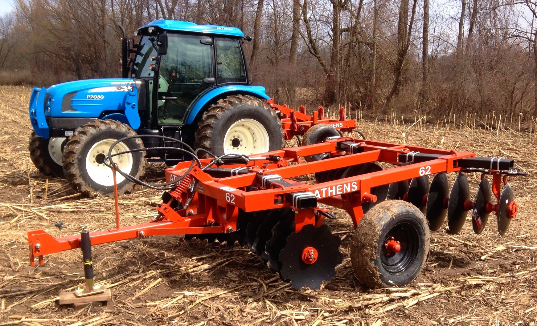

This has been asked before but it seems not to this large an acreage. I have about 10 acres of corn field on a property I recently purchased that I would like to try to start farming. I have the agronomy background and large farm experience to do the job, but this will be my first time commercial farming on my own. I have a Case DX40 tractor, 40hp, and a 6' KK tiller. I have estimated that I can till the entire 10 acres in a long day (8-11 hours continuous) but I would like to know if anyone has a comparison between what a tiller will do vs a 7'-8' disk harrow. Speed is of some importance, I would like to perhaps become a bit larger in the future.
Would this HST 40hp machine handle a 7'-8' disk effectively? Would a tiller be able to leave a rougher tilled path, I don't want a bed of powder?

1] Few people use PTO powered roto-tillers for plots larger than 1-1/2 acres, but that is partly dependent on field shape. Roto-tillers work good for small plots and irregularly shaped plots.
Disc Harrows are another form of tiller, better for tilling ground in long strips. Disc Harrows are not effective at tilling pulled too slow, nor too fast. Optimum speed to pull a Disc Harrow is 4 mph to 5 mph. Too slow and the soil will not mix, too fast and the Disc Harrow pans tend to ride on the ground rather than penetrating and cutting.
2] You need to select a Disc Harrow primarily by diameter of its discs/pans/wheels. Secondarily by its (variable) width.

Tiller is out for 10 acres. It would be costly and very slow. Use it for your garden. Depends a bit on your soil conditions and how aggressive your disk harrow is. A disk harrow on first pass may work or primary tillage with a chisel plow, then secondary tillage with your disk harrow plus spring tooth harrow pulled behind the disk to prep the seed bed and then plant.

In my experience, you will find the pricing jump from a 5'-6' to a 7-8' quite significant.
I would recommend a good heavy duty 6' disc harrow with added weight to the tiller, and one that is adjustable from straight cutting to angled cutting.

I have a 8' disk that I've pulled with a JD110 @ 43hp (gross). It's a lighter, "finish" type disk. I usually add 500lbs of concrete blocks to it. Tractor will pull it but not real fast, 3mph or so and it won't really cut sod or hard pan soil very well. Need to make several passes to get the soil worked and its best to "crosscut" the field.
Couple of questions, however. Does the field have corn stubble on it? How/what are you considering to re-plant the field with?
If the field has corn stalks - you'll need a 'heavy' disk. I have also used a 5' 1/2' HD disk with my JD 4720 @ 66hp (gross). That disk would CUT and was harder to pull than my 8' finish disk.
That said, if there's stubble you'll need to break it down and incorporate it into the field so you can plant it. A couple of passes with a HD disk will get the field into "winter fallow" shape. Rough enough to limit erosion; yet, the stalks worked into the ground enough to begin degrading.
Rototilling the 10 acres would chew up and incorporate the stubble and leave you with a nice, highly erodible seed bed...
Small tractor, small disk - lot's of time in the field to get it into planting shape. Small tractor, rototiller -lot's of time in the field to get it into planting shape.
More passes with the disc... Fewer passes with the tiller. (I've got a gear drive tiller, too. Used it to till 3-4 acre fields.)

With your size tractor(similar to mine) a tiller will work fine.It will take some time but so would 5-6 passes with a disc.I do ten acres every year between food plots and gardens.
I brush hog any standing plots,plow with a two bottom and till.
You can't compare these small tractors with large AG tractors pulling monster discs,they have way more weight and power.

You could certainly do 10 acres with your tiller, but it will take a long time. Probably longer than you're thinking. But it's do-able if you're patient.
If it was me, I'd look for the heaviest 6 foot disc harrow I could find. If the field still has corn stalks standing, I'd shred them with a rotary cutter and then run the disc harrow over it.

I have 35 tillable acres of on my property of 77 acres. I use a 7 shank chisel plow and 8 1/2' disc to prep the soil. Disc size depends a lot on your soil conditions, I have areas I can bog down my 88 hp tractor while running the disc or chisel plow.
I'm sure you could fit your 10 acre field with your current tractor and tiller, it would just take a while. For maintaing optimal soil conditions and productivity I wouldn't want to run your tiller on a year in and year out basis. Everyone I know is going to the chisel plow for better fracturing of the soil and minimal tilling.
Sounds like you have a good idea what you need and good luck with your endeavor! Here's a picture of my tractor/plow/disc.
