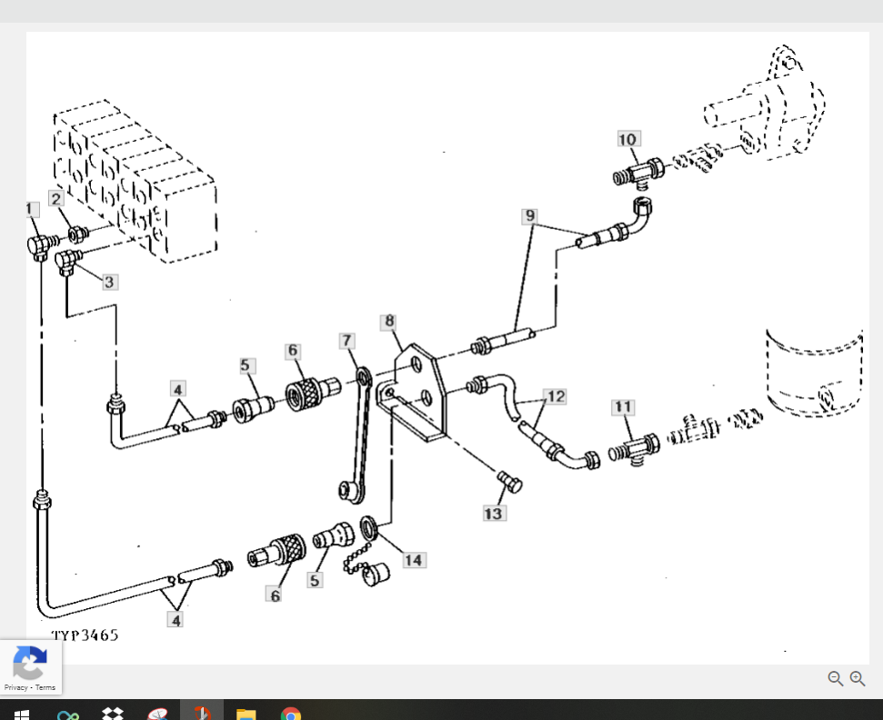

My second question is>on my #10 backhoe I blew a hole in the hydraulic line from the back of the tractor to the backhoe. I decided to change both lines since they are 31 years old. I marked each one where they went and told the guy making the new hoses to leave the tags on each one. Well I got them back and they didn't transfer the markers to the new hoses. So my question is> they have quick connects on the hoses, the backhoe is marked in and out where the hoses hook up. Is there anyplace on the tractor that is marked in and out or supply and return so I can sort this out? Thanks for any info,Dave

On JD 2155 tractor the BH hyd hose(key 9) is pressure that attaches to tractor at the rear of pressure control valve & return hose(key 12) attaches to ported hyd filter cover. I agree to check FEL quick disconnects to be sure they're seated correctly
