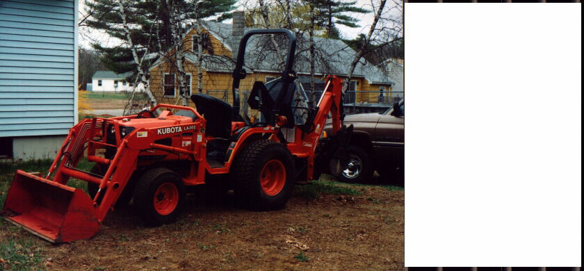

congratulations on purchasing the BH!!..I have a Woods 6500 on my B7500 and do not regret it at all. Just keep in mind that this is a compact tractor and won't rip and tear like a Cat 416, ok? I use mine to dig out stumps then to dig holes to bury them in. I am real glad I bought it. If you are careful with it and use your head when digging, then the Backhoe will do everything you ask of it and then some. Good luck!!
   / 10 days till backhoe! #12
oops..forgot to attach the pic of my hoe..sorry..
