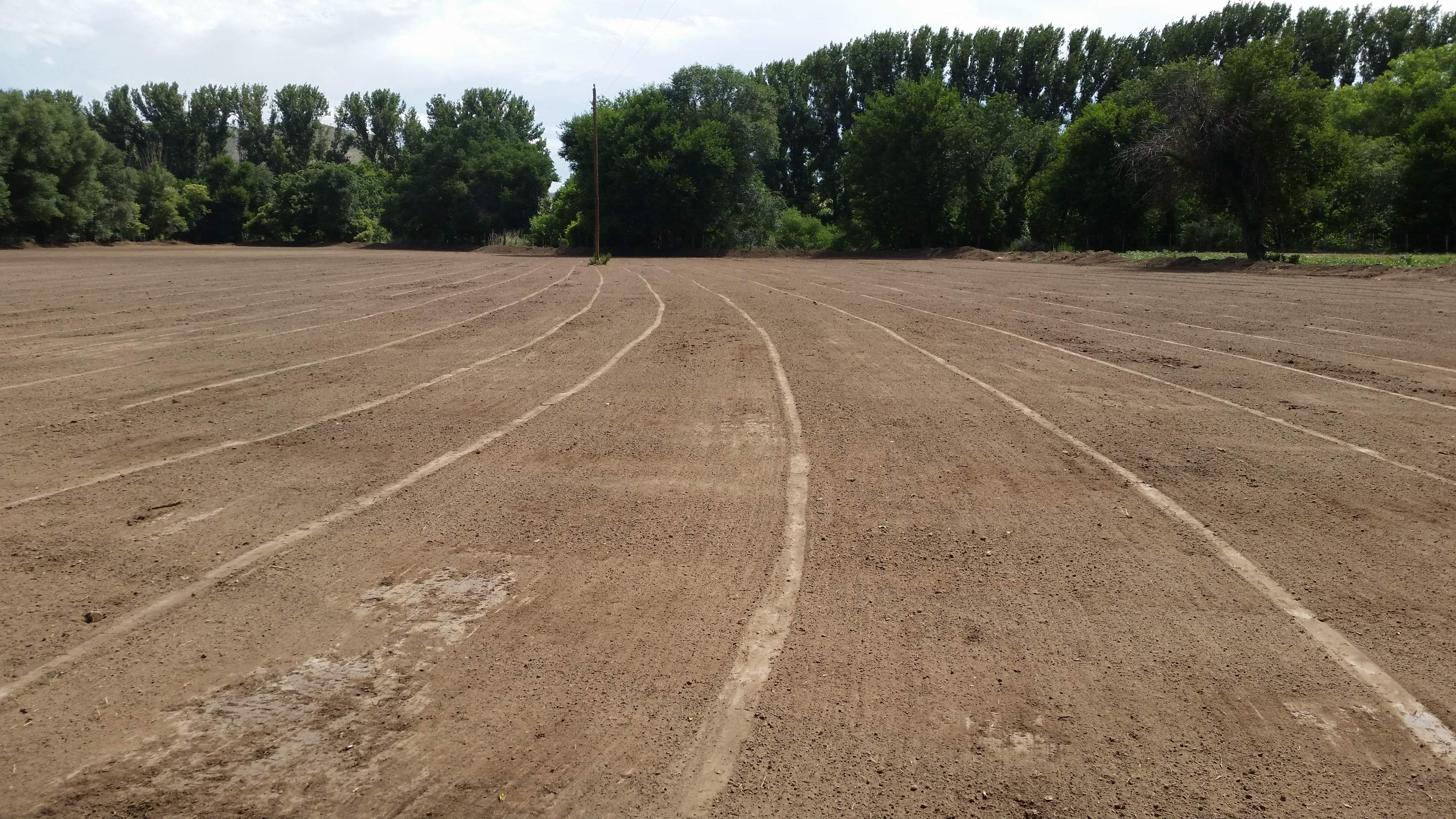

When it dries out you should be able to see where the puddles were located. Try pulling dirt in to these holes. Puddles if they hold the water for too long can kill the grass that may be planted later. Just try to get the area smooth enough that it will drain without these puddles.
I would not concern myself with getting the box fully loaded. Just concentrate on moving the dirt to the low spots with as much finesse as you can muster. Don't dig too deep on a high spot, that may cause another hole to fill. Multiple light passes that overlap should get it fairly smooth. Working with what you have.

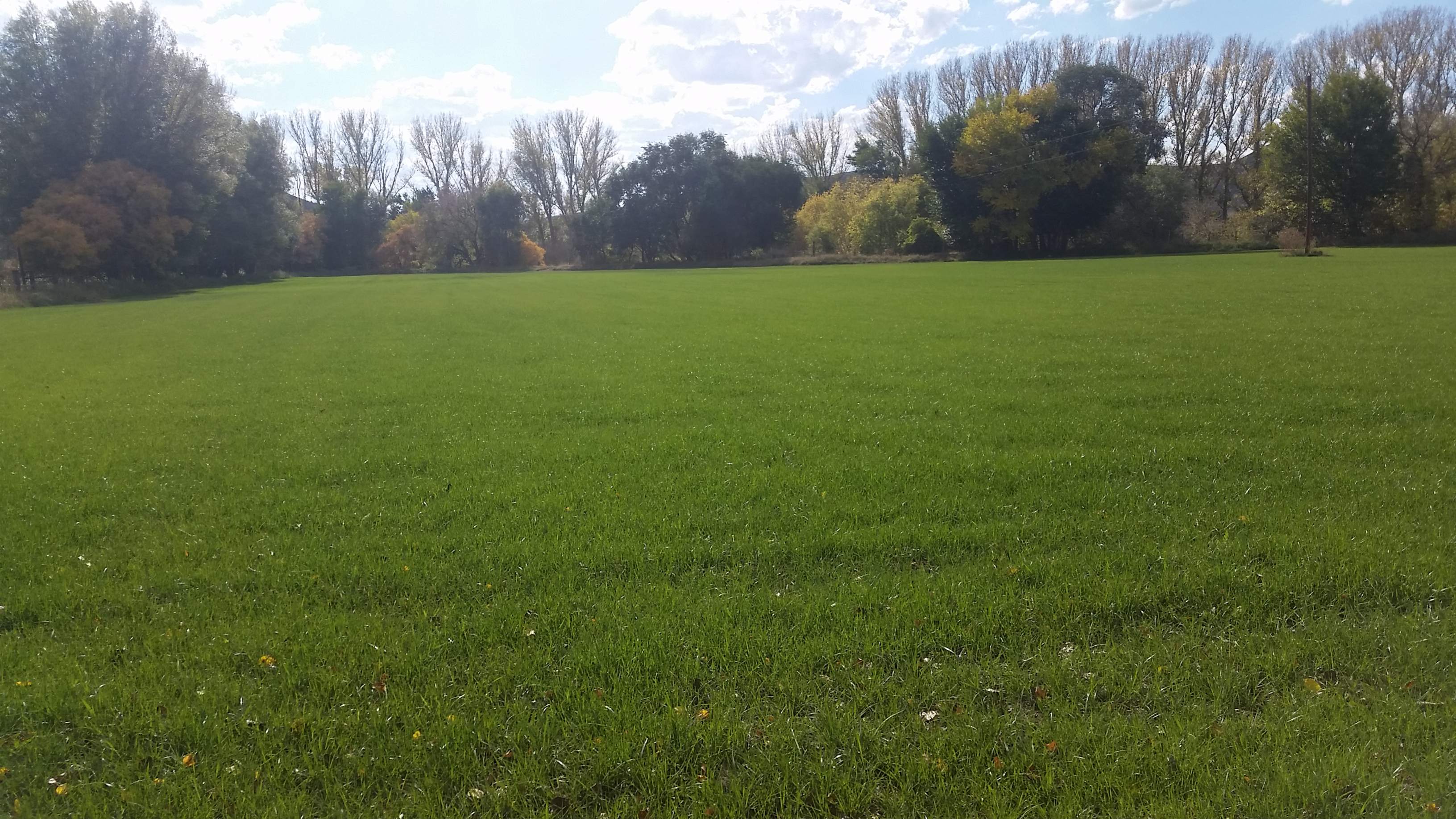

Now if you have more than the two acres to work on I might consider a different approach. I do a lot of this work and find that a land plane grader scraper does a good job with smoothing and averaging the surface. Drag type finishing tools whether factory or home made can all help with smoothing. For my work where I have to transport the equipment frequently the lpgs is more convenient for my uses. Below is a picture after smoothing with the lpgs and another after the grass was up.
