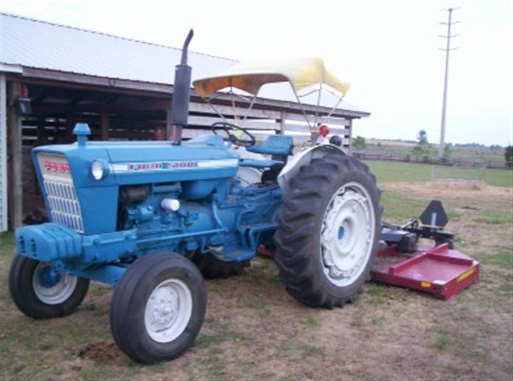

My 5000 and 7610s are both open platform.. and i stay clean except for residual dust.. whether using my 10' fixed deck 3pt.. or my 15' batwing.
now.. if I mow on my 8n and 5' mower.. it will throw some dust.. but I have front guards on ALL my mowers. some metal.. some rubber.
soundguy

My 'best' time on 10ac of plain grass, using my NH 7610s ( ~95hp ) and a jd 1517 15' batwing mower was 1hr 45m. though i can reliable do it in 2hrs. My ford 5000 ( 70hp ) and 10' mower kicks that to 2hr 45m to 3hr.. variables depending.
That same job used to take me in the 5.5hr range with a 32hp tractor and 5' mower. i simply didn't have the time to devote that much mowing time to it.. thus the tractor and mower upgrade. The first upgrade was the 5000/10' mower.. got that package put together for about 9000$.. that's not alot of cash for a good amount of mowing machine.. 7610s and the 15'er were nearly 20k$.. but I traded int he newish 32hp tractor to knock about half that off...
soundguy
