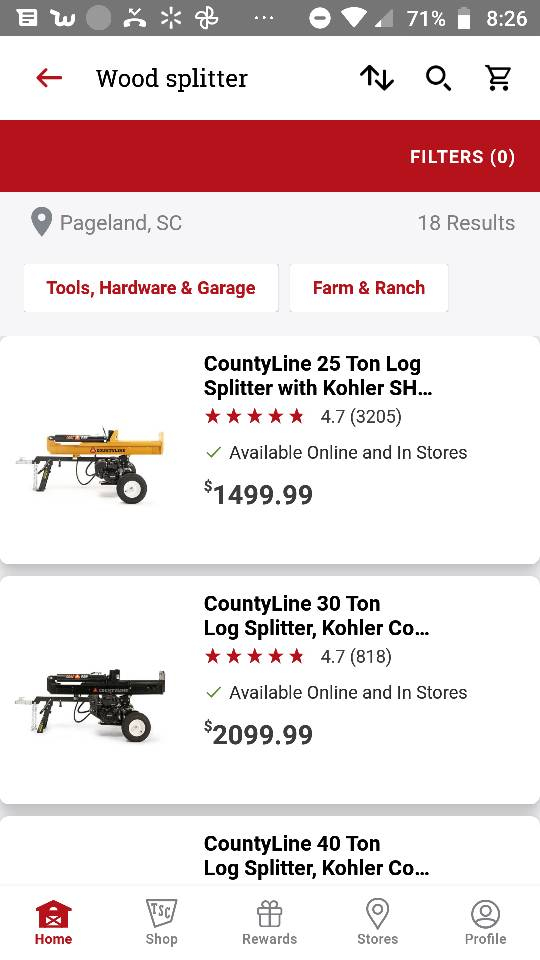

I saw more like $500. I'd spend $100 for a cylinder in a heartbeat. I think the stroke is just a little over 8".

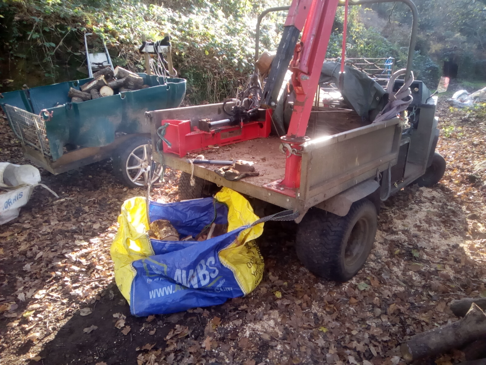

I realize this has nothing to do with your question but I get disgusted when I think back about all the time and money I spent on wood splitter rigs over the years. I would have been better off throwing more $$ at it from the beginning and gone with something like this:
No lifting required. It splits the wood on the ground and moves it to a pile as well.
Well out of your price range though.

good luck w/project, you'll find good info here better than i can offer. Question: is this splitter conversion a cost effective project for you, or just a challenging home project you want to pursue? seems to me you could save the existing manual splitter for your family/friends to use :), then get a stand alone gas splitter (at least 25t). might be able to pick up a deal after holidays. best of luck
