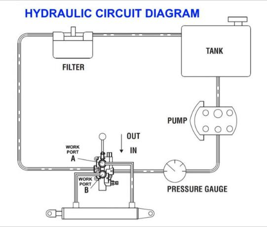

Just for clarity this is how a typical wood splitter hydraulic system is configured....

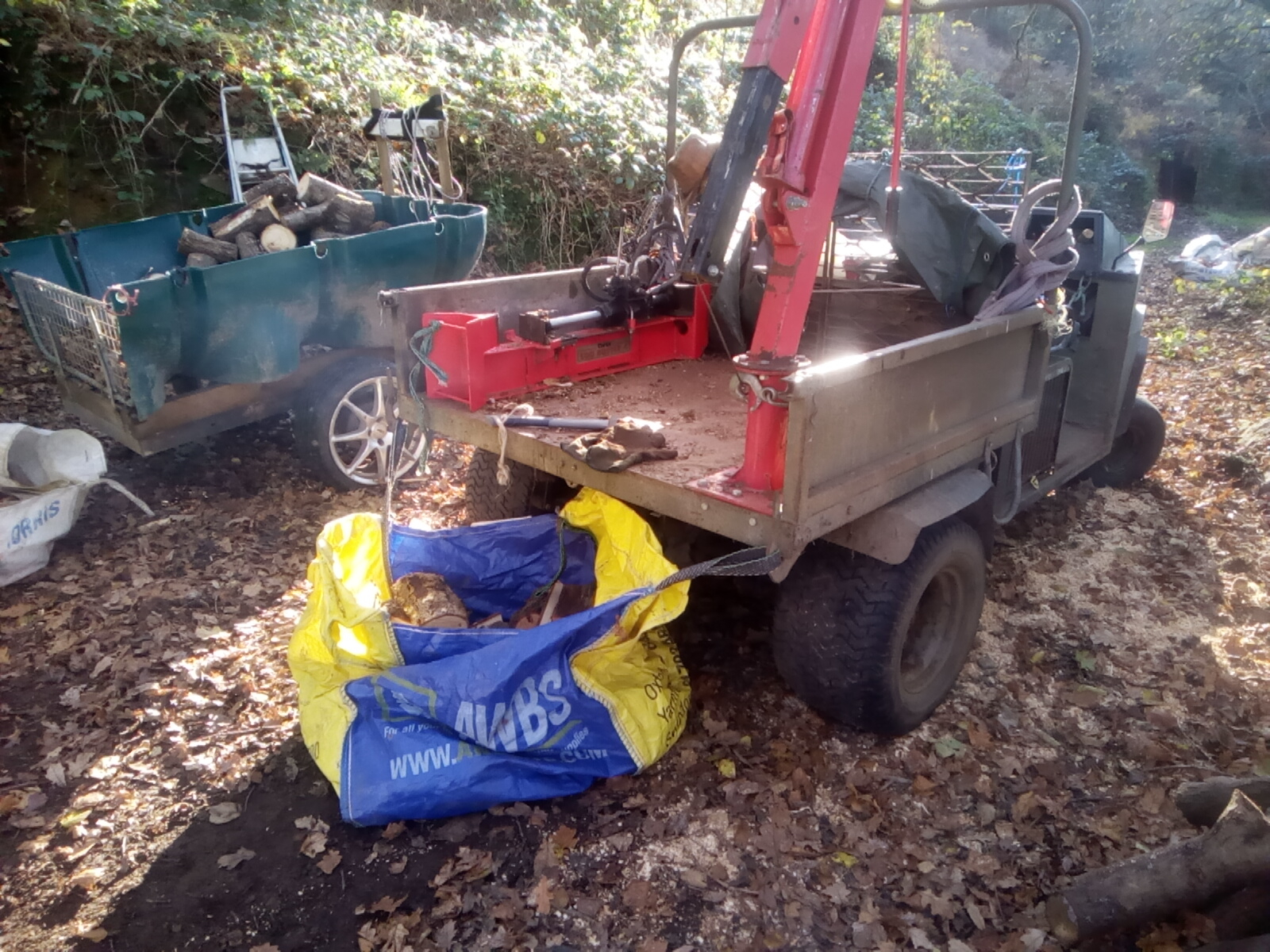

I had the same manual splitter (Ebay second hand £12)& the same idea as you! The problem with using the jack with externally supplied hydraulic pressure is that there is no return path for the oil. In a jack the cylinder overflows (small hole near top of bore) into the external case which holds the oil supply. If you supply external oil, then you will rupture that case which is not designed to hold ANY pressure: it's just a reservoir.
I used a double acting cylinder I had lying around & purchased (£35 ish) a single spool valve. Then
a couple of spare hydraulic lines & bits of scrap plate & bolts etc to make some mountings & the pusher slide & for a total cost of less than £50 it was complete.
I use it in the bed of a Cushman Turf Truckster powered by the Cushman hydraulics. It works well for my needs: most of my logs come from hedgelaying so 9" dia would be the max. I have split some larger rings, but the Cushman hydraulics are a bit asthmatic for the bigger stuff. I did try it behind my Zetor 7045, but the Cushman is much handier to use around confined spaces
I used a double acting cylinder I had lying around & purchased (£35 ish) a single spool valve. ThenView attachment 722163 a couple of spare hydraulic lines & bits of scrap plate & bolts etc to make some mountings & the pusher slide & for a total cost of less than £50 it was complete.

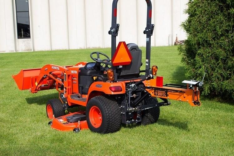

I'm not sure I totally follow why it would be unsafe to use the levers on the tractor to operate the cylinder. If I mounted the splitter like this
and take into account where my remote valve levers are
I think if I stand as I am when I take this picture
, if the splitter where the log is is to the left near near the tractor, and I'm reaching to my right for the valve, all is well. I've never, not once, split wood with any company, but maybe that is the sole concern?

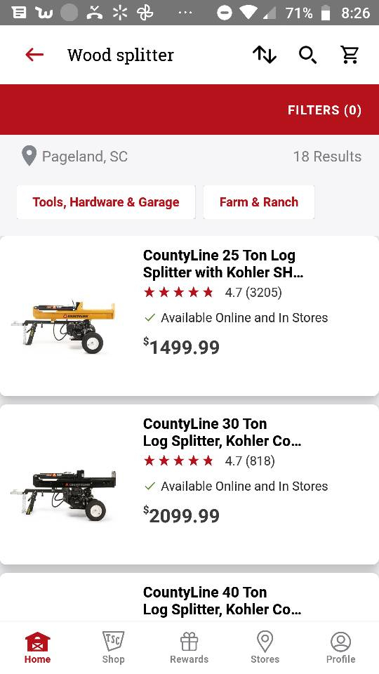

They've gone up. I'm in SC, USA.

Those aren't 3ph splitters. I'm sure they went up...just don't know how much. Not in the market

I don't see any 3ph splitters at TSC, but the cheapest 3ph splitter I see is $1000.
