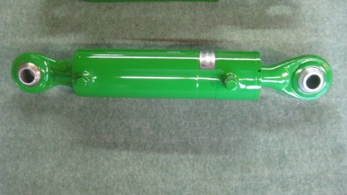

I did a little more reading and it looks like they are made by Agmate. There's also a 3" version available for $140. I attached the product doc as well.
Has anyone had experience with these units?
From their doc
ASAE is the American Society of Agricultral Engineers.
Might just show the level of their quality control.

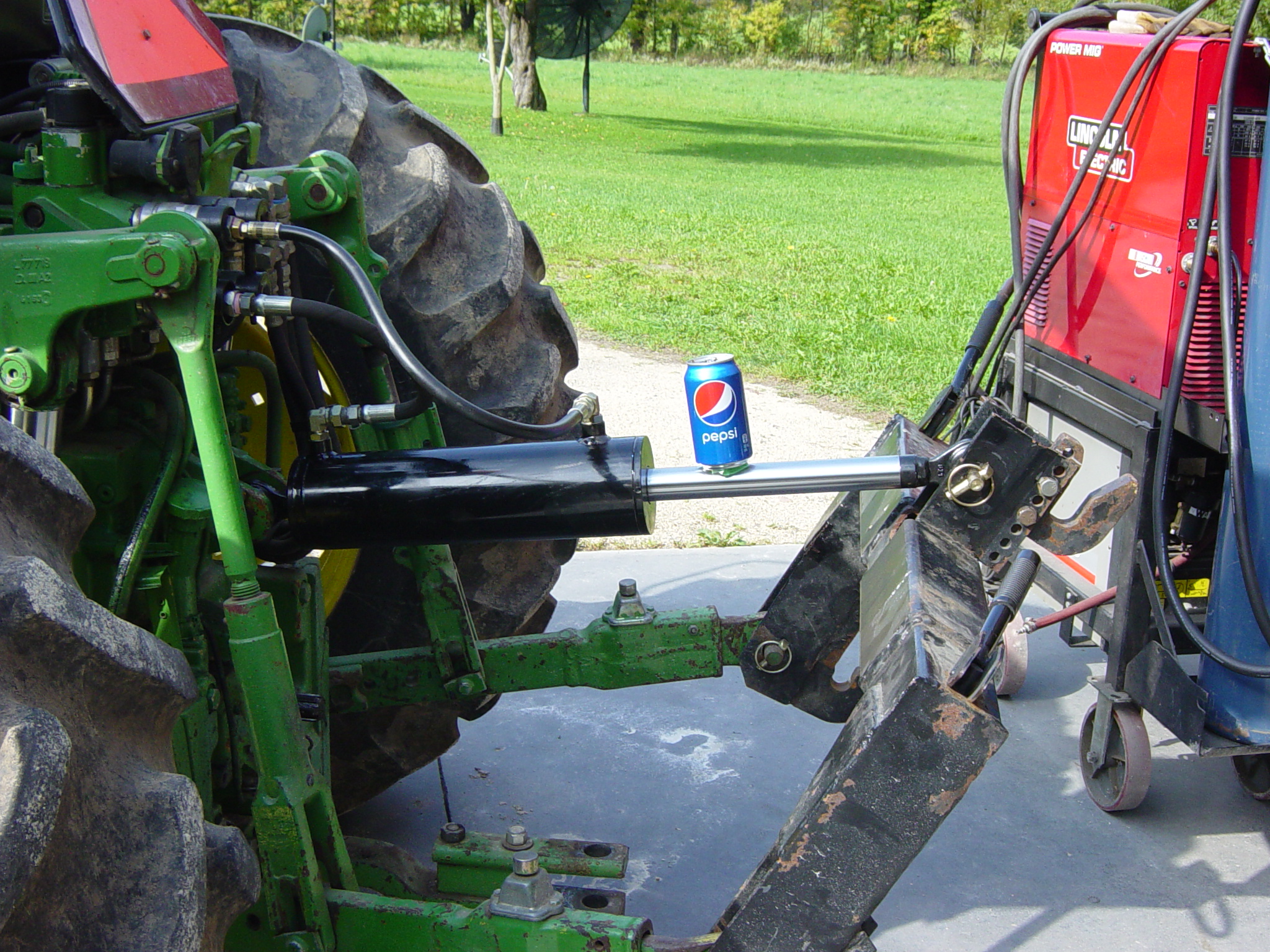

I was going to get one of those this summer, but with the exchange rate, and having to pick it up stateside, I got one custom made by the company that makes cylinders for Wallenstein. I got it made bigger and to my exact length I wanted. It was surprisingly cheap and done in a couple of days.
I believe it was $180.00 CDN. I picked it up.

I think you build top notch top links and value your opinion. However, for $170 to my door plus hoses and have it going in less than a week it痴 very tempting. How many weeks lead time are you at now? I would think you壇 get slammed this time of year. Where are you on price for one turn key for my 5100e? Only use it for my box blade
Brett
The whole point of my post was that these generic top links typically are not the ideal working length for these poster's tractors. I always try to get at a minimum of 3" of stroke in each direction. Others do not, in fact I have seen where with the top link fully retracted a box blade would only be level, zero front tilt ability. Is that what you want and have to deal with? A box blade sure doesn't work very well set up like that if you are trying to make a cut.
If you get one that is 22" collapsed, I doubt that you will be very happy with it and the performance that you will get from it. I hope I'm wrong. Plus you will have to grind the tractor end down from 2" to 1 3/4". Not a big deal, but it will need to get done just to get it installed on your tractor, and then it is no longer returnable if you are not satisfied with the working length.
As far as my lead times, I started 2017 at 10-12 weeks. I'm currently running at 17-19 weeks, at last count had over 112 orders to work on. I can't give you a total cost, I have no idea where you live other than Texas. So it is impossible for me to get you an accurate delivery cost, $50-$60?
But a 3" top link with the correct width tractor end (1 3/4" wide) and LARGE cat 2 ends at that, (There are many different actual sizes of cat 2 ball swivel ends on the market.) hose kit and flow restrictors would be $495 + shipping costs.
You typically get what you pay for, if-when the low $$$ stuff works out, then the consumer comes out ahead, :thumbsup: if not then not so much. :(
I hope that it works out for all of you. ;)
