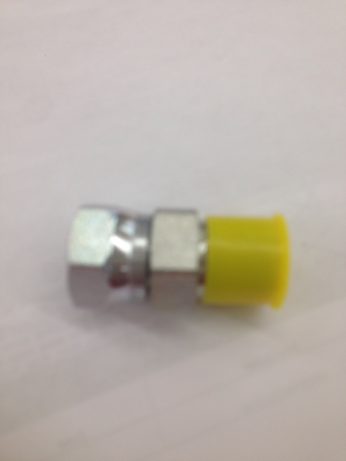

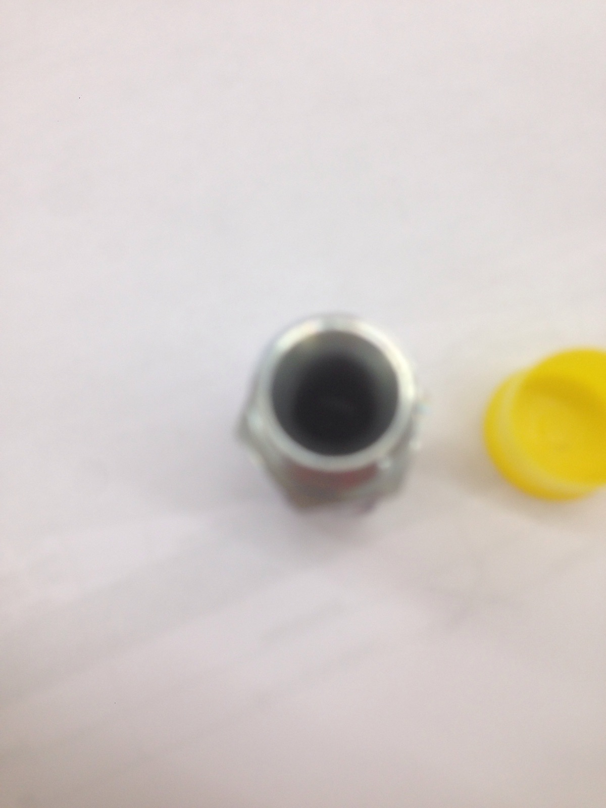

I have settled on the 1/2" NPT (m/f) with the 1/32" (0.031) orifice. I can make it work without (I actually bushogged today) and if I'm very careful I can ease the toplink to the needed length. I've never had the stock link as short as this cylinder can go, and when up all the way, I think the tail wheel of the BH was probably 4' off the ground. Very neat.
A little more info. I called a friend who works at a local TSC and she was able to locate some identifiers for their 1/2" NPT Swivel flow restrictor fitting:
The SKU No. is 1256783.
The item number is BMP-8FPXR-TSC
She was not able to find any data on the size of the orifice, but she took three views of the fitting on her cell phone camera and sent them to me. They are a little out of focus, but still helpful, so I've attached them below.
I'm pretty sure the orifice is about 1/32. I'm using one of these in their 3/8" NPT size with 3/8" hoses on a 3" x 8" Grizzly cylinder that I've added to my 84" Woods snow blade to allow me to offset it hydraulically. It allows adjustment quite slowly, which is just what I wanted. It should work well on your 2" toplink cylinder.
BTW, for anyone reading this who wants the 3/8" size, here is the TSC identifying info for that:
The SKU No. is 1256782.
The item number is SMP-6FPXR-TSC
These fittings can't be found on the TSC website. In fact, the only hydraulic fitting shown there at all, after multiple searches, is a Pioneer poppet-style quick connect. :shocked:
I would definitely call ahead to your local TSC to make sure they actually have the fitting on the shelf before you make the trip into town. :)

Wow, 3pt. Short of you going to the TSC, picking it up and installing it for me, I can't think of anything more helpful than what you just did. Thank you! I'm heading into town tomorrow for other things, so a stop at the TSC store will probably take me less than than finding an employee who can give me a trustworthy answer over the phone. I appreciate your extra effort!

Happy to do it. Hopefully it will help others as well, as the question about sourcing fixed-orifice flow restrictors comes up on TBN from time to time. TSC is convenient to a lot of folks. When I couldn't find them on the TSC website, or virtually any other hydraulic fittings, to post a link yesterday, I was puzzled. :confused3: I know they were there last December, when I added hydraulic offset to my snow blade. So I dialed a friend! :dance1:
