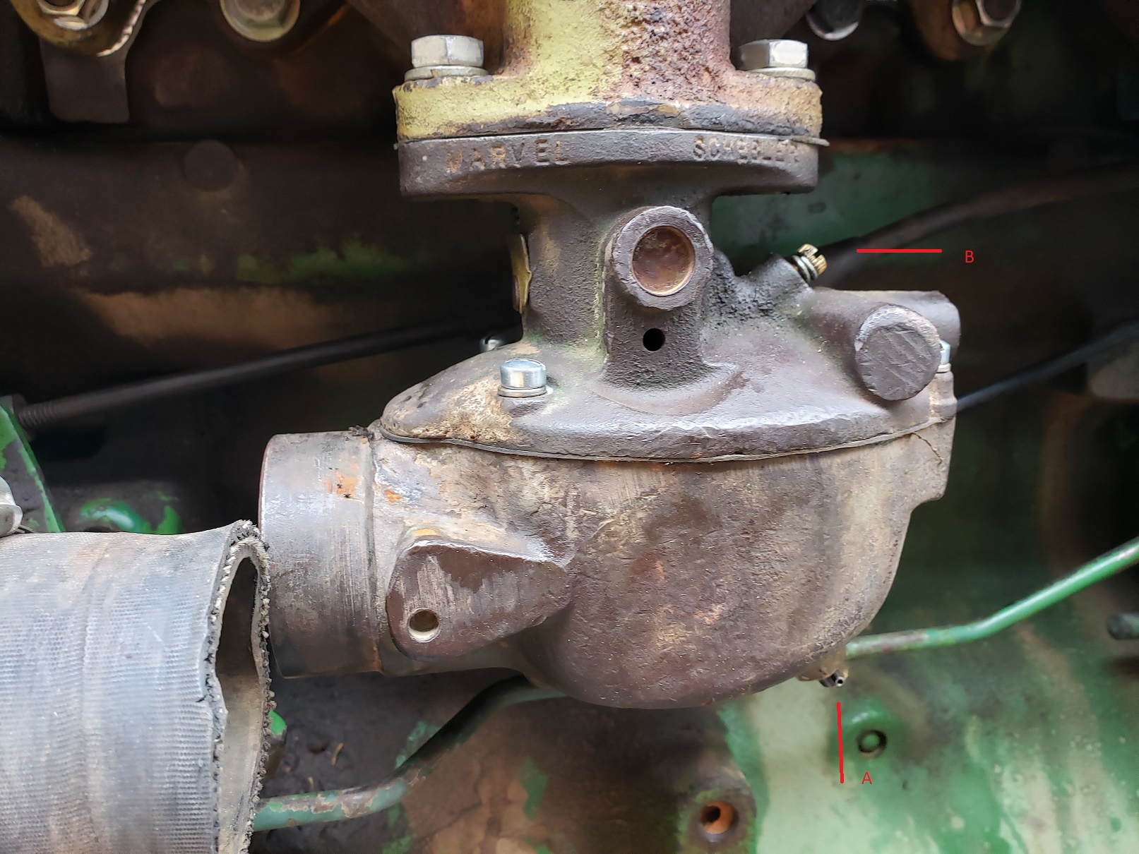

I am those thinking you have blocked internal passage in the carb. You might try soaking the carb body (disassembled) overnight in a carb cleaner. Gunk, sold a pail of this cleaner that has "dip" basket.
Rather than spraying ether, I have put gas in spray bottle that has an adjustable sprayer that lets you adjust for a mist rather than a stream. It's easier on the engine than ether.

in the carb repair kit should have been an instruction sheet with all the settings [ per carb # ] for the float level and drop, the idle mixture adjustment,the main fuel adjustment and idle speed.
the float level and drop setting must be correct for the next 3 settings [ main jet, idle mixture and idle speed ] to get the engine started in an
adjustable state.
before starting the engine set the main fuel [ A ] at 1.0 turns out, set the idle mixture [ B ] at 2.0 turns out, and idle speed @ 600-700 rpm.
once started adjust the main jet to establish a smooth idle, the goal is to have a clean start-up and smooth throttle up, once that has been set adjust the idle speed, then the idle mixture.
adjustable state.
I didn't rebuild the carb. neighbor did. He's usually pretty good at doing this type of things. Once the carb is done soaking, will set it per your info.
Thanks to everyone for your help thus far.

No better after the soak and blow. Will have carb professionally rebuilt I'm thinking. Least wise will know that part is not the issue if it doesn't fix it.

Is there any chance that there's a loose wire in the ignition circuit that vibrates when the tractor is running? Logic says the carb is the problem, but it seems like you've done all you can to eliminate that.
   / 1020 gas can't keep it running #39
This needs to be done if it has not been done. Soaking or blowing out any not get everything out.
I just went through a similar exercise on my Ford 2N; I had rebuilt the carburetor and the tractor ran essentially the same as you are describing. In my haste to get the tractor up and running again I skipped the step of chasing the passageways in the carburetor with a brass or aluminum wire when I was rebuilding. There must’ve been an obstruction because after I removed the carburetor for a second time and chased the all the passages, the tractor ran fine.
   / 1020 gas can't keep it running #40
How loose is the butterfly shaft in the carburetor, a worn shaft and carb bore can be a major vacuum leak.
