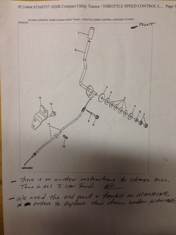

Ralph, I got a repair diagram for it from my dealer. When I get a chance, I'll try to post it for you. Glad to hear your's is holding right now.
   / 1025 kept slowing down #22
Here's a picture of the diagram from my dealer:

Thanks for the picture. The JD service guy came by last week and tore it apart. The big felt washer was all worn smooth. The repair kit he got didn't have it in there. He's supposedly coming out this morning with the felt washer and put it all back together after I said that it looks like maybe I need a loaner tractor. Hope they finally get this fixed.

He fixed it today. Turned out it had only 2 of the cone washers. Should have 4. Has 4 now and a new carbon (not felt) washer.
