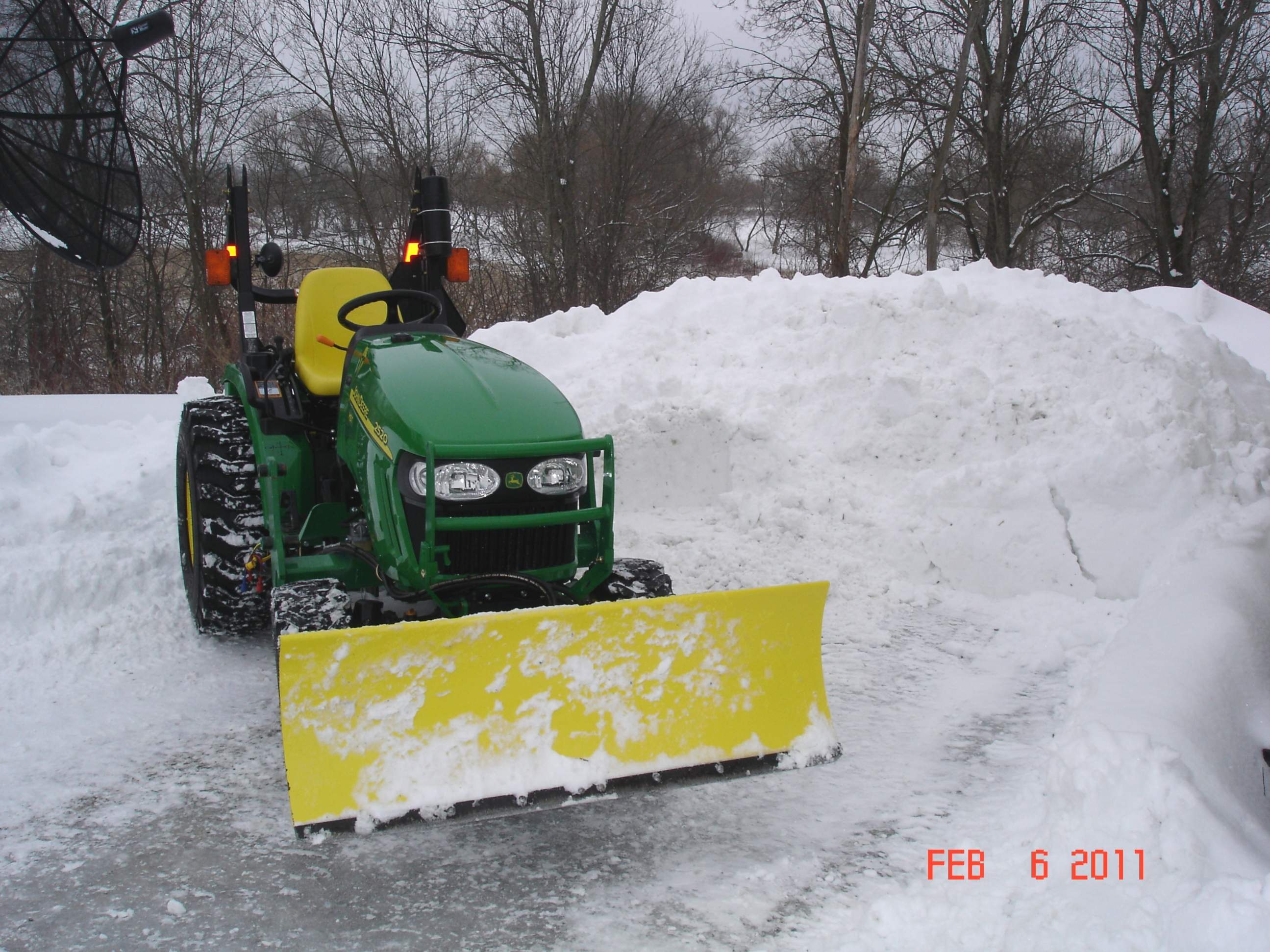

I have the quicktatch angling blade on my rig for snow plow duty, also with the R4 tires. I originally plowed snow with my X495, but always had to use chains, which are a PITA to put on IMHO, so I was hoping to be able to plow snow without chains, with the 2520.
On advice from members on this forum, I purchased a ballast box as well, as some folks said it will make all the difference when pushing snow. They were right on about that. When I first plowed snow, I decided to not attach the ballast box for the first try. Everything was fine, pushed about an 8" snowfall without too much trouble, worked a lot better that the old X495 set up. The next time I decided to add the BB. WOW.....what a difference.......the thing was like a bulldozer.......an absolutely amazing difference with the BB attached.
I also have about a 5 acre property, however, for the most part, my snowplowing is pretty much a flat area, so it's kinda hard to compare, but I certainly don't need chains with my set-up.
Here's a pic of my 2520, and an example of the snow I've plowed. This was taken in 2011........really didn't get much in 2012. The banks behind it are well over 5' high.
