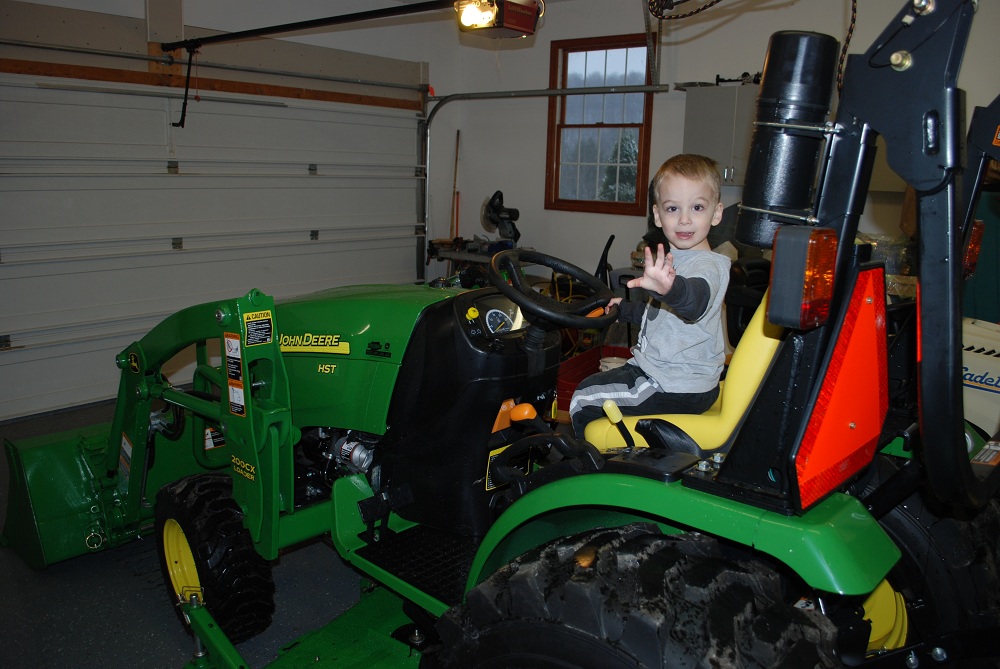

Here it is!

Very nice looking machine! I looked hard at the 2520 but decided on the 3320 as I have 20 acres. I'm sure you'll enjoy it!

Nice! I see your boy approves!

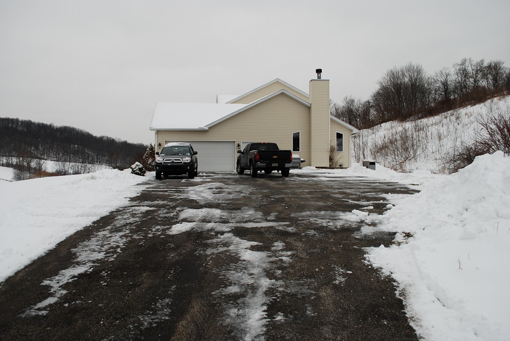

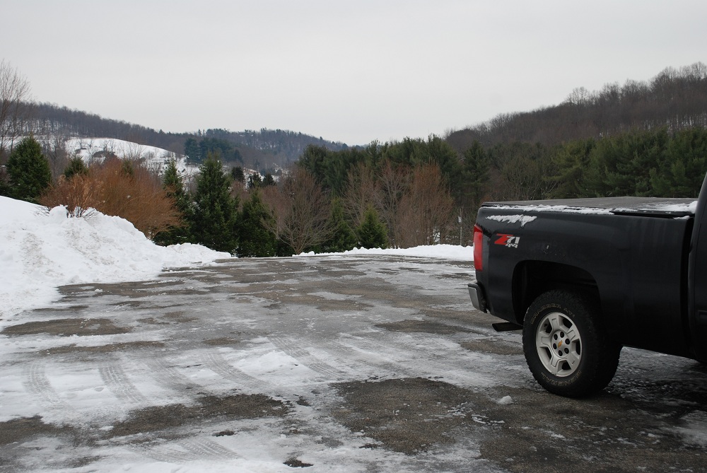

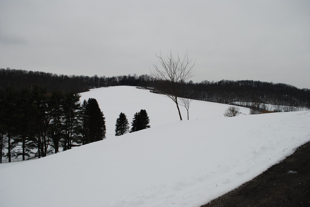

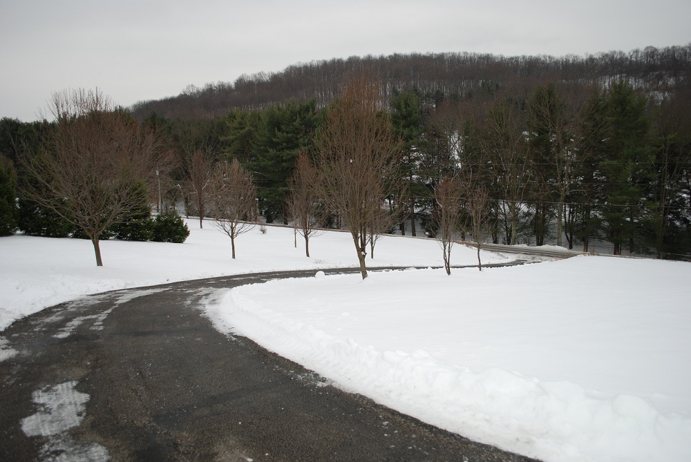

Here are some pictures of what I'm dealing with along the lines of driveway. As I mentioned, so far to my surprise the loaded R4s didn't even slip much on this bastard of a hill. I cannot decided if I want to go dump $350 on 2 link ladder chains or not.
