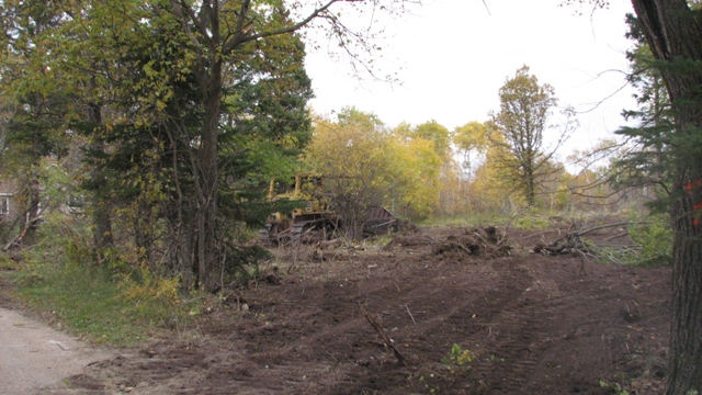

a shot of my "project"

I agree with this post.^^^^^^
Seems to be a common problem for most homeowners. First you need a larger machine to get the work done, I would go with a 2720 200cx fel, weighted tires and boxblade and/or landplane for smoothing, grading and landscape work. When it is all done you might be better served with a zero turn or x700 series mower.
I make a large part of my income working over landscapes, grading, shaping, tilling and contouring. It seems to me after doing this for several years that a small compact is the best choice for this work. It needs to be heavy enough to get the dirt work done. When you mow with a heavy tractor your lawn will look worse after a season of mowing and tracking up. In a nutshell it is hard to build landscapes and mow with the same tractor.
If it were me I would go with a 2520 or 2720 and 200cx for the tractor work and tough out the mowing with the 300R for another year or so. When you have your landscape work completed and are left with finish mowing you can change the tractor setup over to a mowing rig at that time. You should be able to have a lawn that is smooth enough to use a 72" mmm or 3ph rear grooming mower.
THANKS!!!

I totally agree that you need to go to 30 hp for the project you showed. Below that you are going to spend a lot of time with very little value added. The 3320 is so much more. You need to be in the CUT series not the SCUT for what you want to do.
