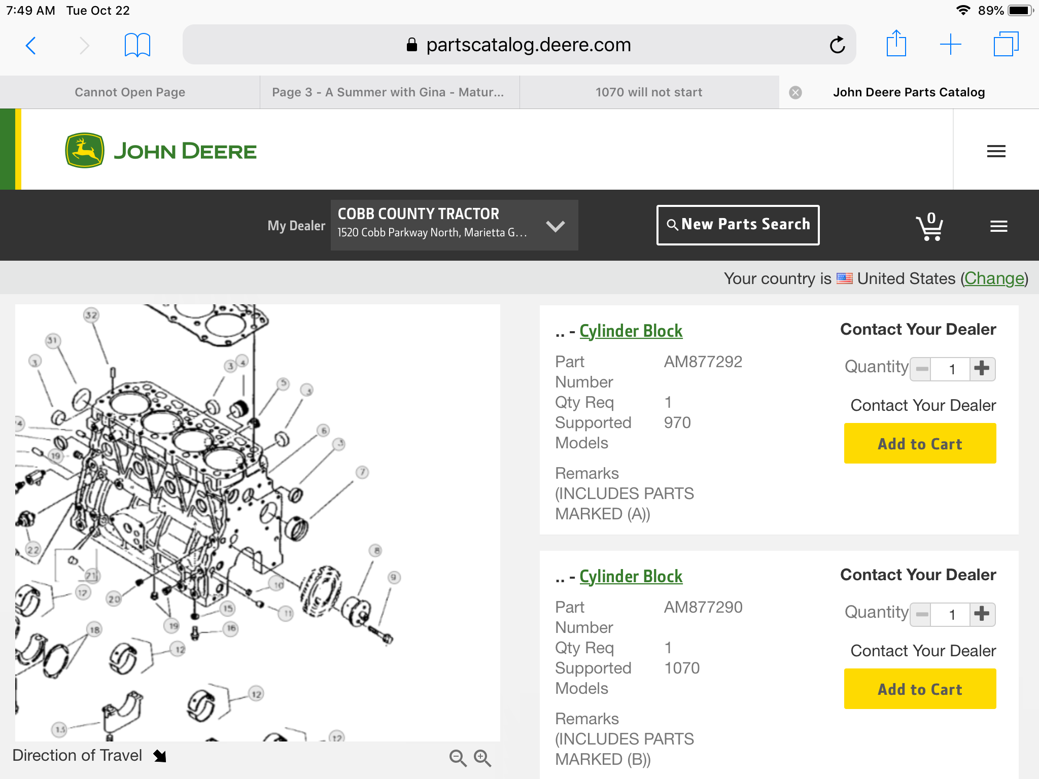

That is funny, my 970 is a 4 cyl with the original motor. Check out Tractor Data. com. ( yes, I'm sure of it !! ) I think the 870 might be a 3 though ??
Before buying any parts, I'd check out the cable ends where the ground bolts to the tractor frame, and the battery connections as well, also where the positive bolts to the starter @ the top of the solenoid.
Chris
/ 1070 will not start #11
970痴 are 4 cylinder too
