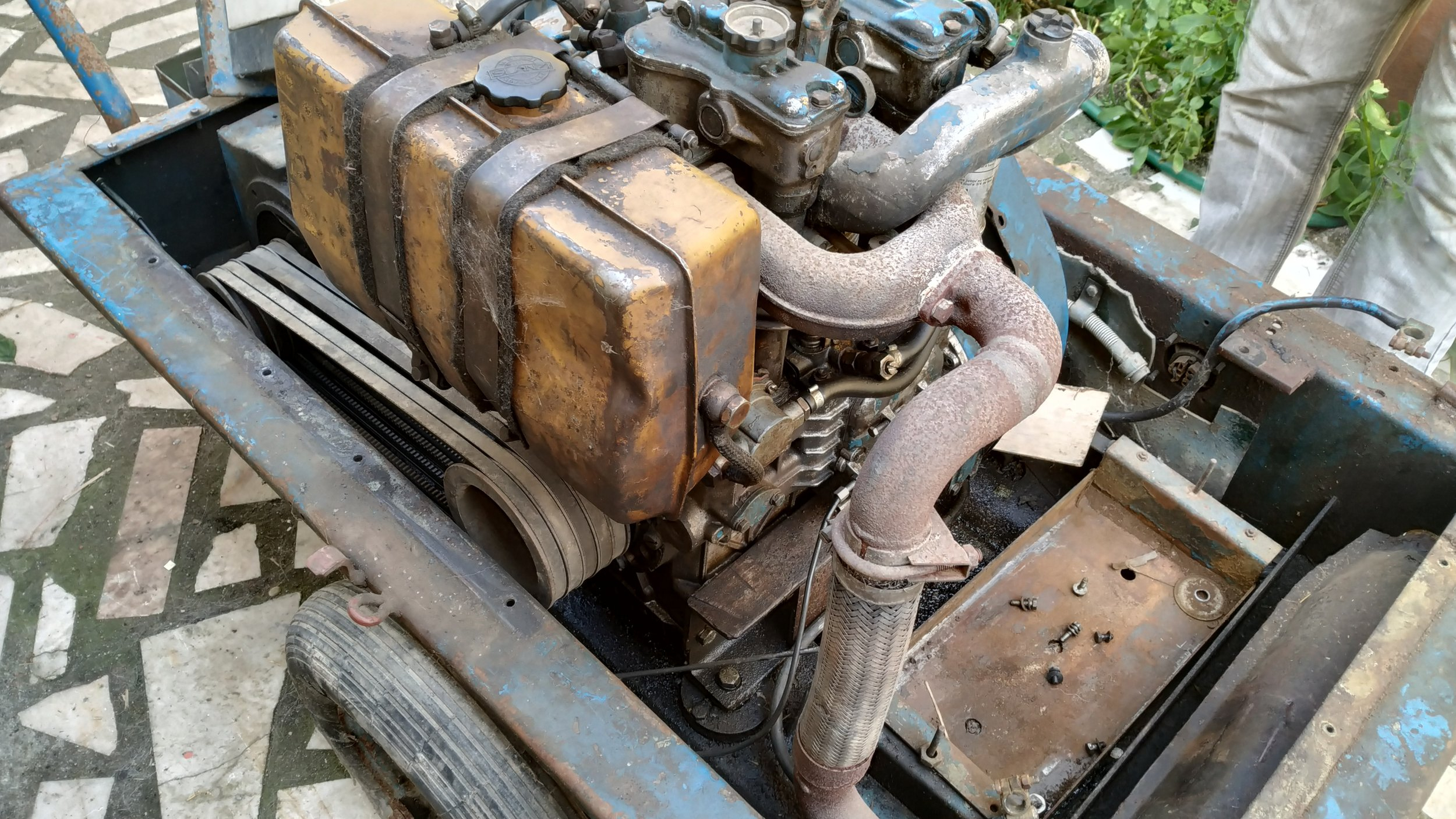

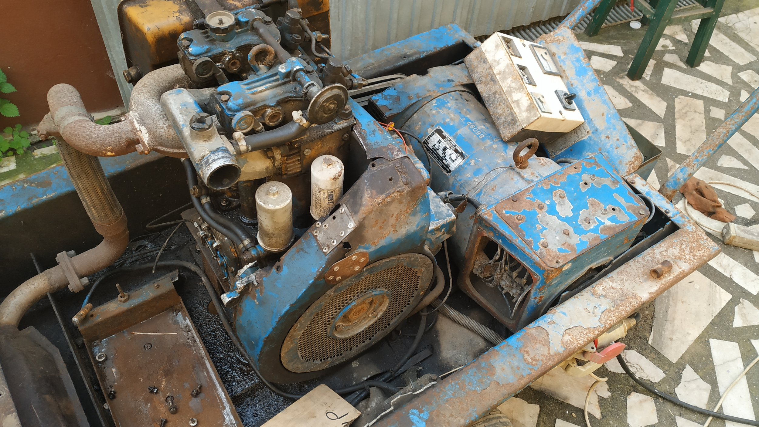

Here are some before pictures:

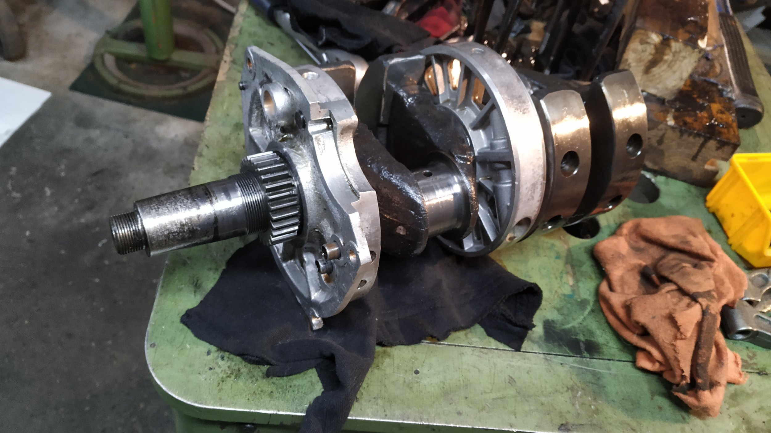

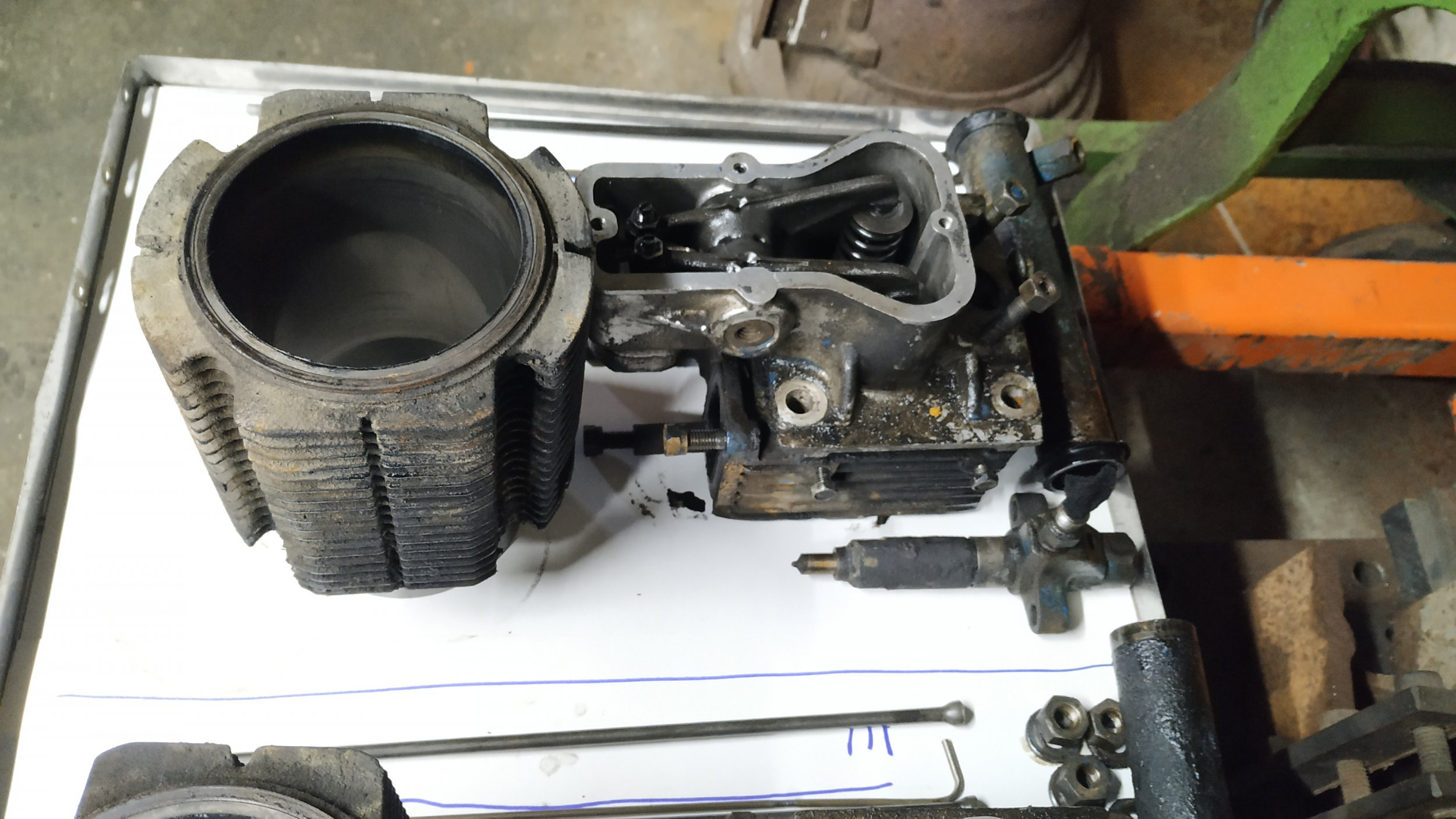

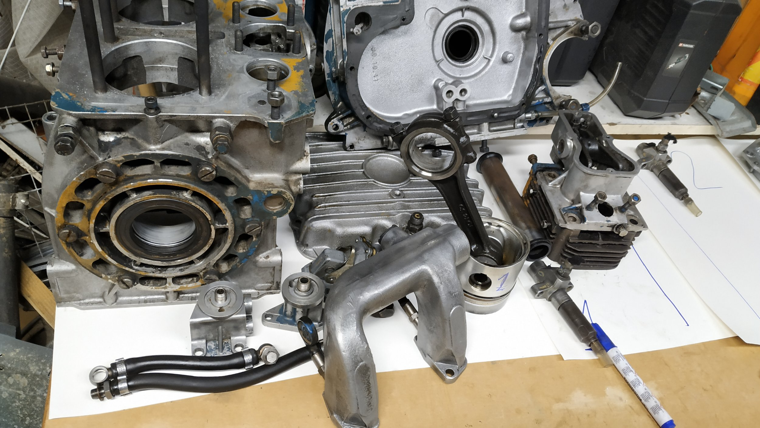

I started by taking the engine apart after I could source a gasket set for the entire engine.
Here is a list of things wrong with the engine:
- All the sheet metal was either broken, cracked, badly patched or had hollowed out holes.
- Mounts were completely shot, in fact, it was only held in place by one bolt.
- Crankshaft thrust washer was broken in two pieces and laying on the oil pan. It was impossible to find a new one, so I made one out of pre-hardened steel. Come out surprising well.
- Leaks all over the place. Fixed with the gasket set
- Shut off lever was also broke and laying on the oil pan but someone made one out of sheet metal to get it going again. I took the repair one off and fixed with the proper one.
- Couple broken bolts here and there, along with stripped threads. All fixed.
- Someone used at least 3 full tubes of RTV on the entire engine
- Everything was pretty much covered with oil, fuel, dirt, crap, everywhere.
- All the bearings and bores were in good shape. Only a few scored lines on the connecting rod bearings but no big deal there.
Here are some pictures of some engine parts spread all over the shop. Some pictures after cleaning, other before cleaning.

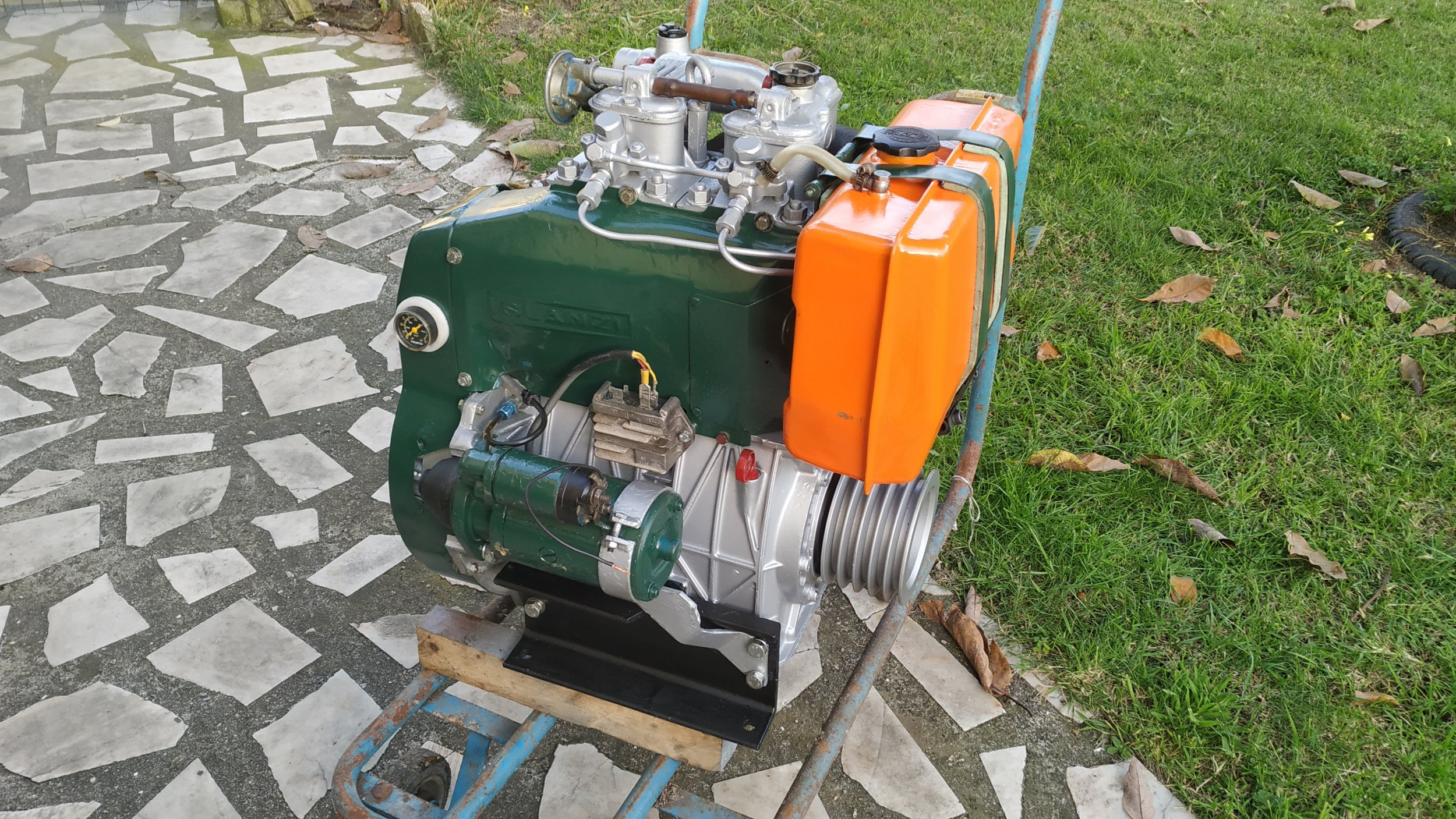

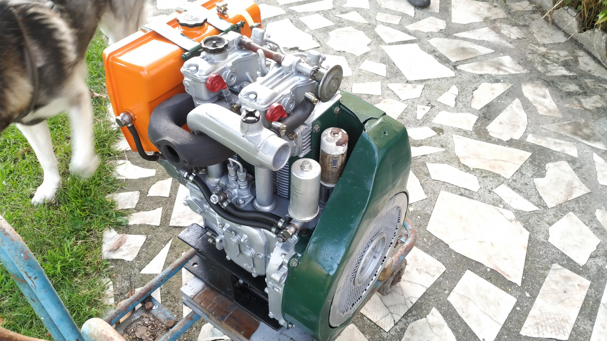

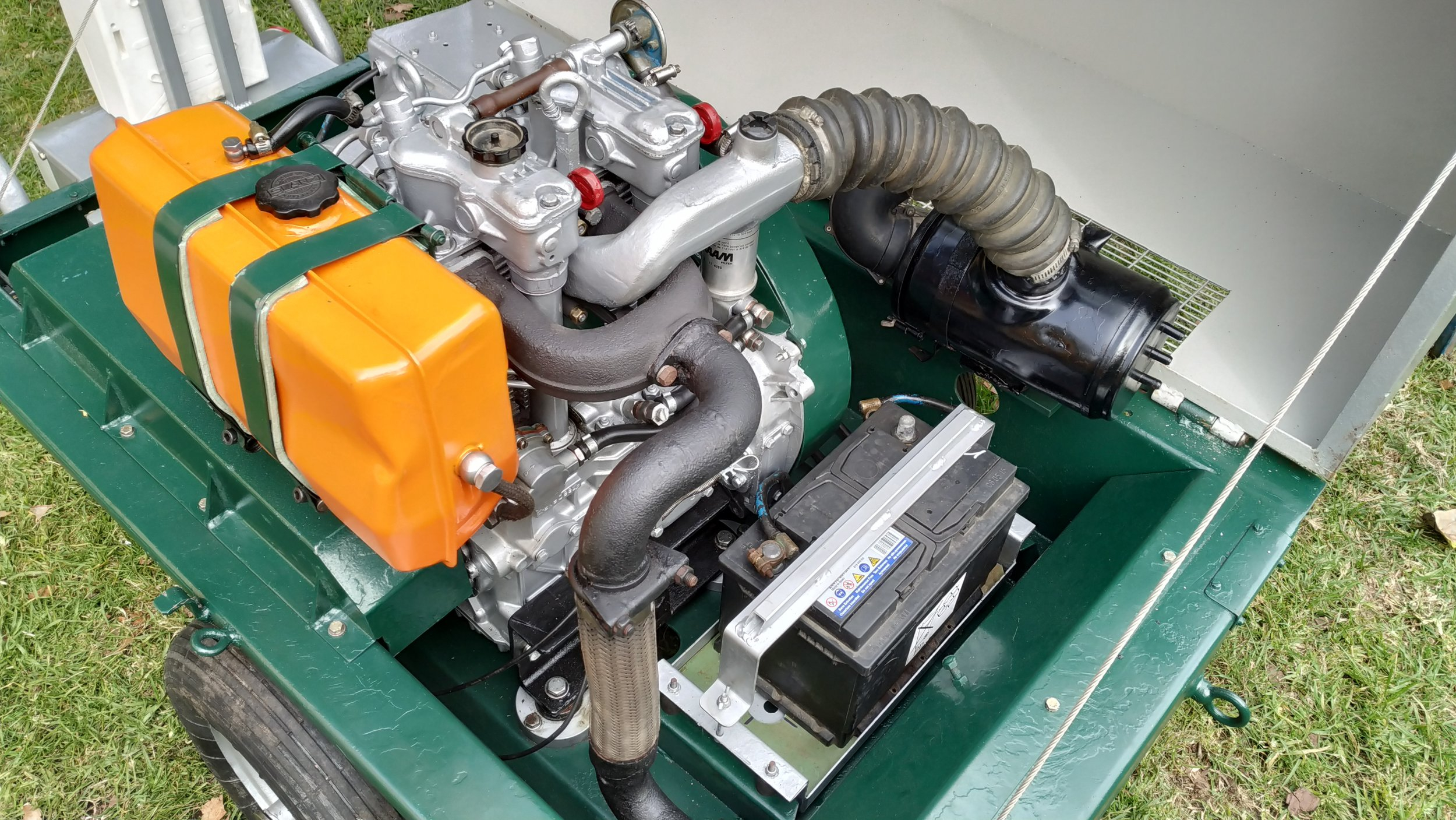

And the engine all back together after a coat of high temp paint. And of course, the mechanic. Gotta give credit where the credit is due. :)

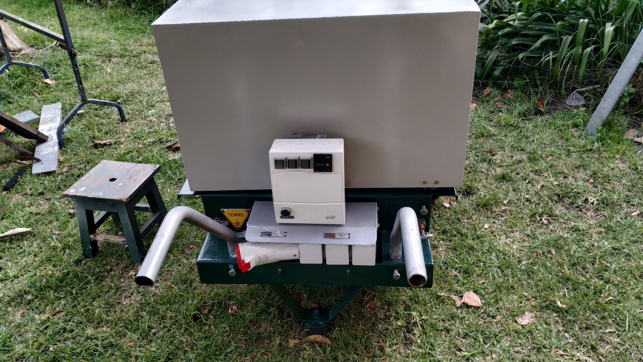

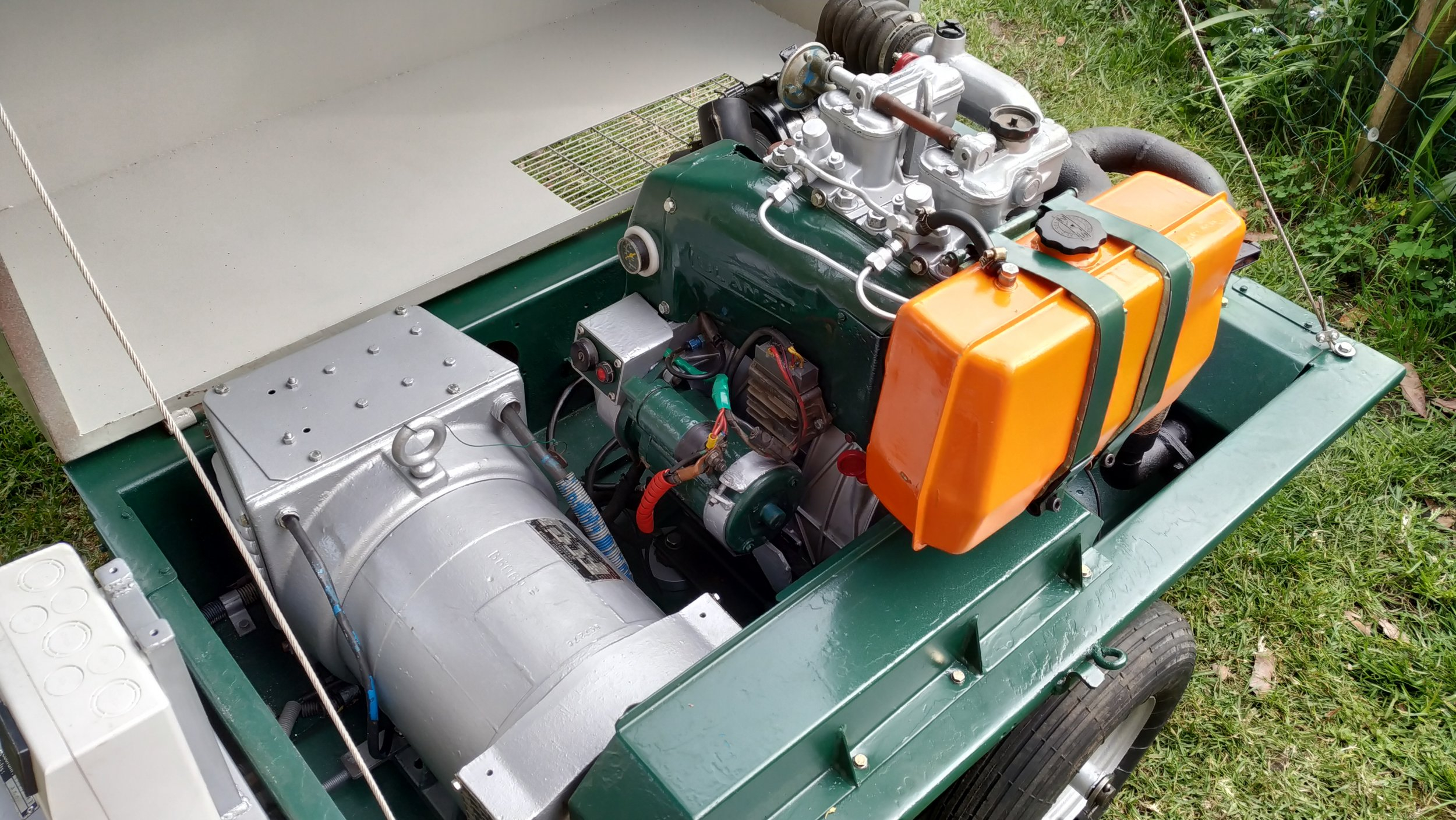

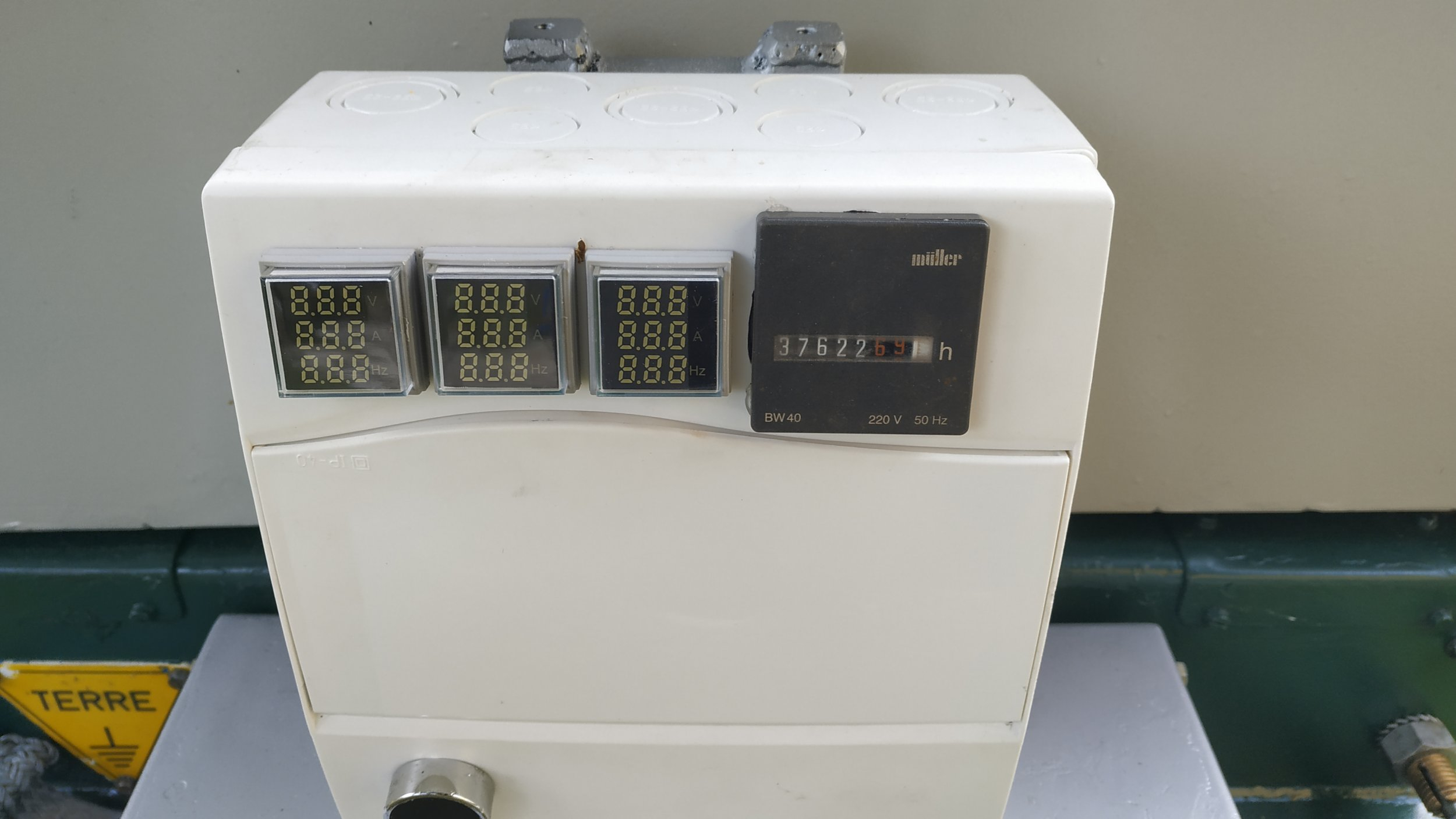

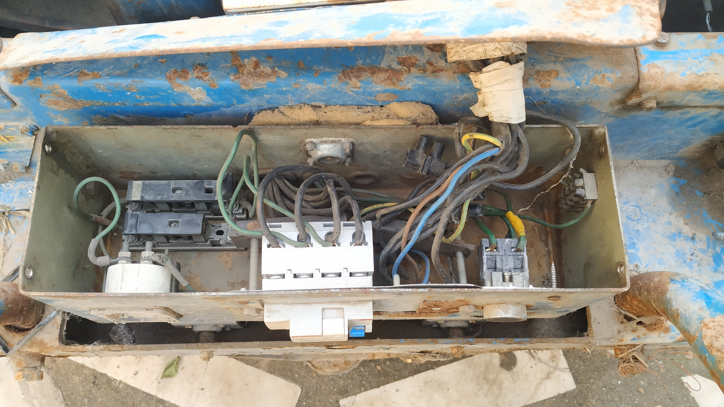

With the engine done, the generator and dolly was next. Not much to do there, other than fixing some stuff here and there. Also changing some old and brittle wires inside the generator head. Being that this post is already way too long. Here are some pictures of the final product. I redid the entire electric panel, added some new meters and an hour meter I had laying around. Ignore the 37k hours on it, I'll use it to keep track of oil changes.
Fixed a bunch of rubber mounts for the battery, electrical panel, engine mounts, etc. The air box is now attached to something. New battery hold down clamp.
This engine is most self destructive engine I've ever seen!

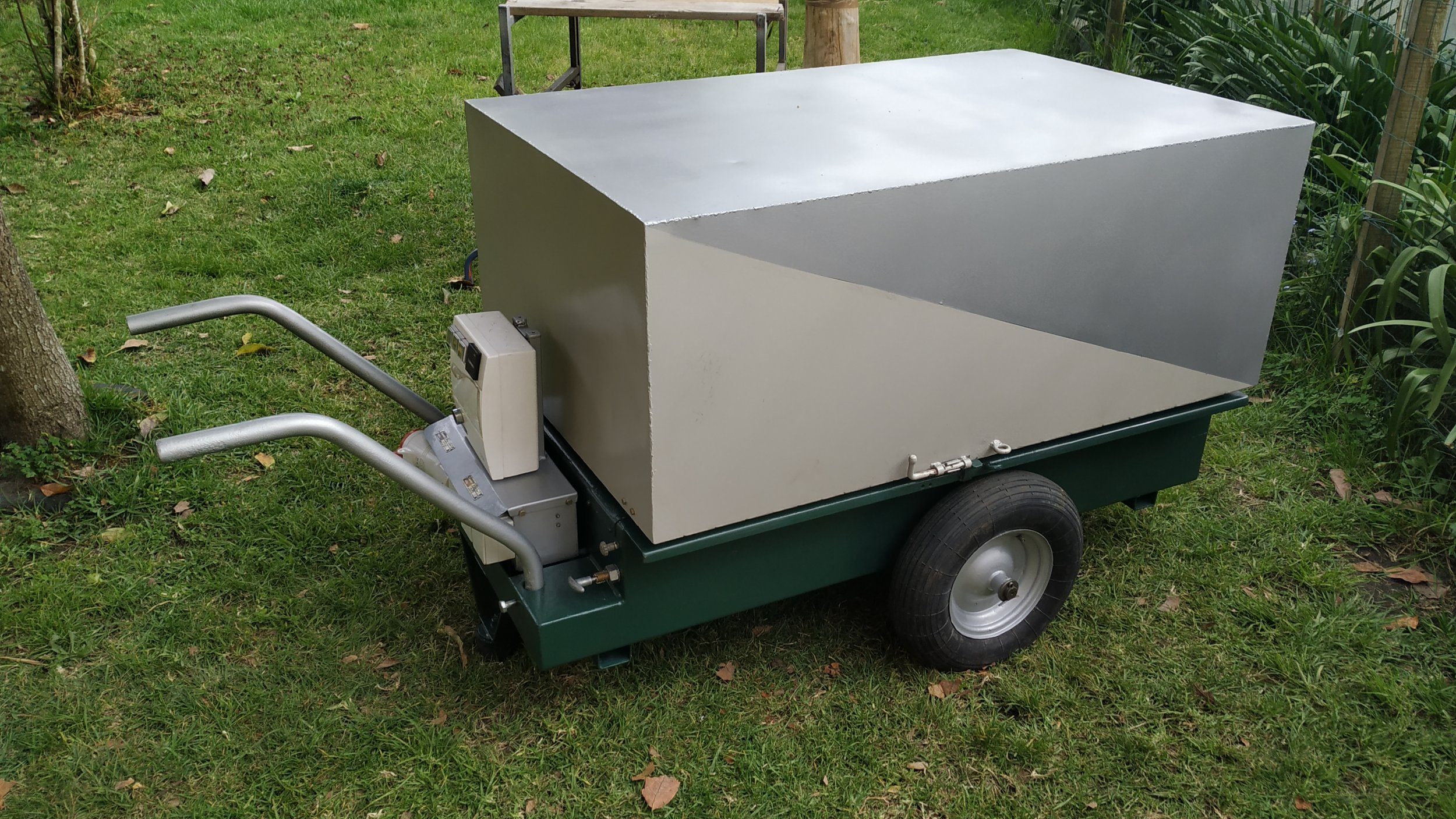

/ 10kW Generator revamp (Pic intensive) #5

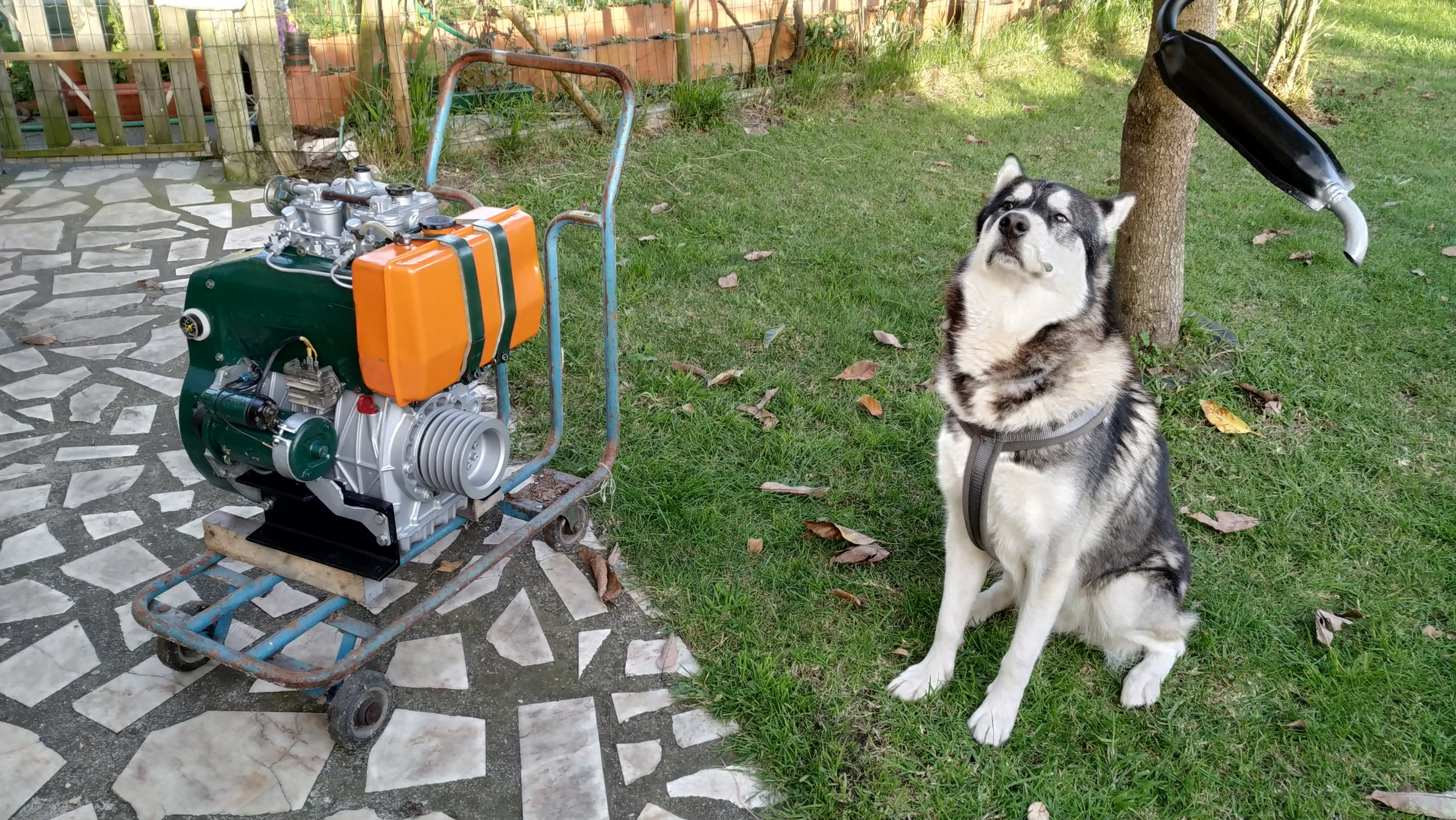

That came out nice. I can’t tell if your dog approves or not.
Yeah, the dog does have a short attention span, sort of... Pretty much like the owner. :)

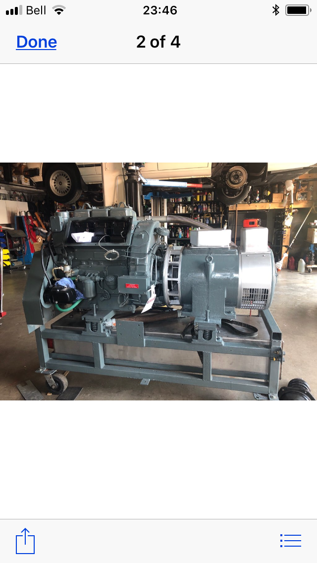

A friend recently struggled to get this 12KW beast going. VR issues. Ended up ripping out a pile of descrete equipment to replace it with a $20.00 E-Bay Generic VR. All good now! Tank underneith is OIL resourvoir, not fuel!

It is air cooled so I guess they use the 100 litres or so of oil for cooling. Canadian Cost guard Light House service. No hours at all from this 60s era machine.
It had really unusual field voltage though. He is lucky he found the right one, between help/info from Stamford and Flight Systems. He sent me a pic of the stuff he ripped out next to the cirgarette pack size VR.
