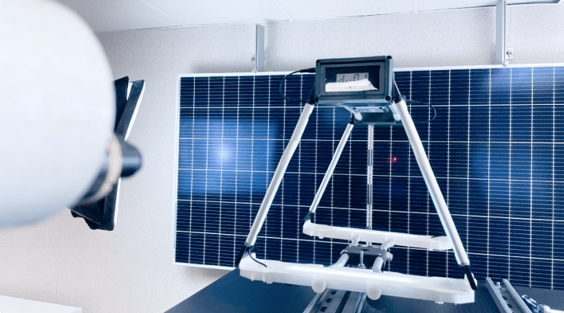

Here are the specs on the panels:
I looked at the home page only and the banner says 60 cents to 95 cents per watt.
At the link below the panels are listed by price per watt and they have lower pricing. Stock already in USA.
