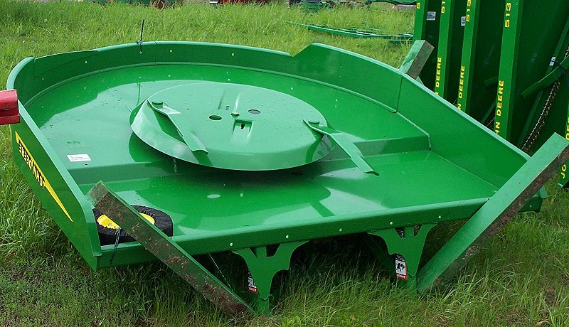

I had seen stump jumpers mentioned here before, and thought it was just another term for brush hog. How can i tell if a brush hog has the stump jumper? Is it just a heavier duty blade er what. Anyone have a pic of a stump jumper?

Here's a pix of an "upside down" JD MX series rotary cutter...
The blade holder "pan" the blades are bolted to is also called the "stump jumper"... most are 3/16" thick... thicker is better but also heavier...
<A target="_blank" HREF=http://www.tractorbynet.com/forumfiles/5-173951-JDRotarycutterupsidedown-800crop.jpg>John Deere MX Stump jumper...</A>

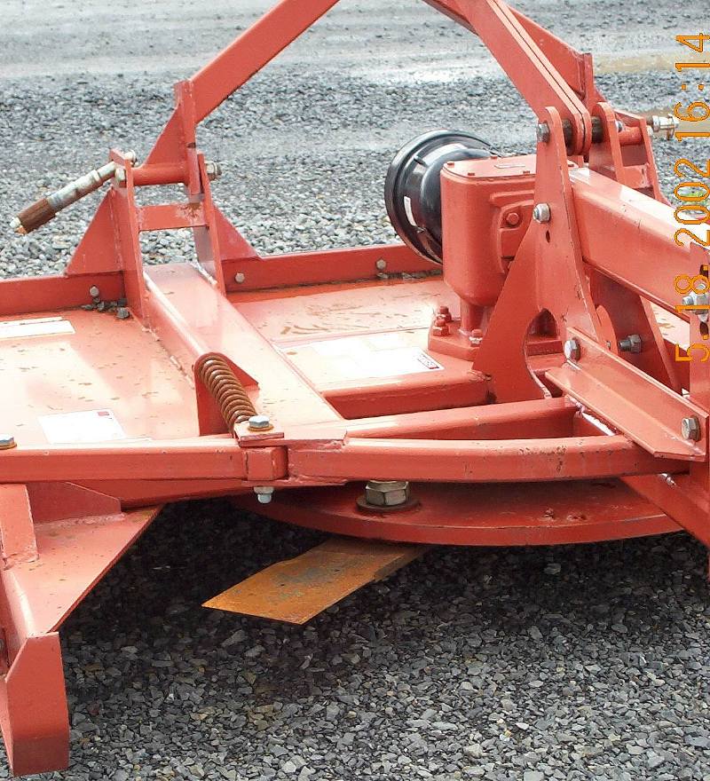

Here's another example of a Severe duty "stump jumper" (correct term is called Blade Holder on these monsters...)... on a Rhino Treecutter rotary cutter, from the rear of the unit, notice the blade bolted to this 1 1/4" thick steel disc... this is "1" of four blades mounted on this animal...
By the way... this stump jumper alone weighs over 625 lbs... /w3tcompact/icons/blush.gif
